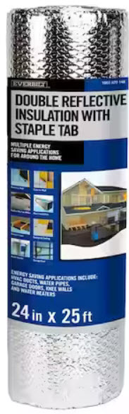

The glass is the problem. It doesn't provide any insulation at all from the cold. I have created some window shaped sections of the bubble foil insulation for the front windows to block out the summer heat. They are flexible and fit well without any thing else to hold them, just friction. Make them slightly larger than the glass section so you can squeeze them in. I've also seen people line their RV and travel trailer windows with this stuff for both cold and hot. I'd start there before I tore out the doors. Besides, with the power window mechanism in there you won't be able to put much insulation in.
https://www.homedepot.com/p/Everbil...ve-Insulation-Staple-Tab-24x25RI-SE/315103185

What King Arthur said. I've got the full weathertech window set and other than condensation buildup slept fine inside the truck in fairly miserable weather.
40ish with high winds and some light rain down on the beach, inside of the truck was closer to 60 overnight with no heat source besides the 2 people in sleeping bags. It also cuts down on external noise and gives you a little privacy if you need to change or anything.
Thank you for the response!
I will pick that stuff up. I hadn't thought about the power windows at all so the in-the-wall insulation is out.
When i get it I will post back!
This works great.
I used this on my scion xb windows and it makes a huge heat difference compared to my hrv without. About to do the same with my 4runner. Pretty inexpensive as well.
