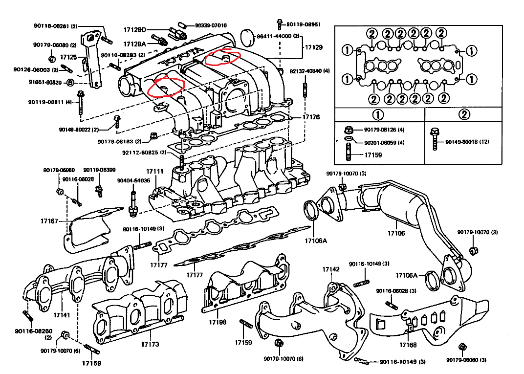

I have snapped off a intake manifold bolt. ( Head gasket) After a sojourn Icould not find a 3VFE with a intake manifold bolt to retrieve.
I went to TOYO DIY for a parts reference numbers but came up empty.
Does any one know what size bolts are needed for the red circled ares within the picture?
thank you in advance
I believe it's an 8 x 1 25. Best bet is to take the other one to a Fasanella or even the hardware store because there's nothing special about those bolts. They have minimal torque spec on them so it shouldn't cause any issues to replace with a matching length from the hardware store.
