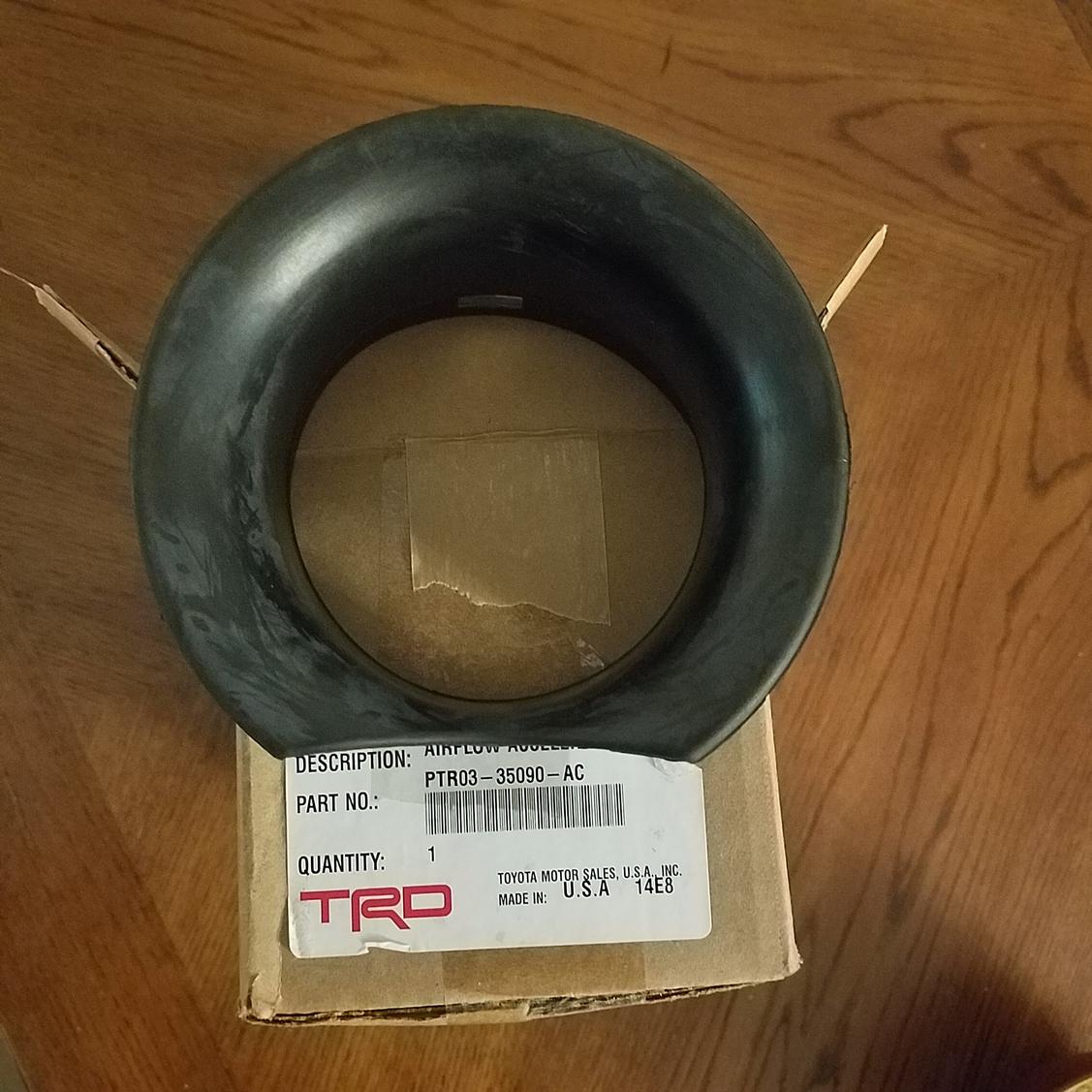

So picked this up to add to this mod. The way I see it, with the restrictor removed, carbon filter removed, AFE Pro Dry drop in filter, and the TRD air accelerator, I'm damn near the TRD intake for about $75 and a little time. No I don't have the smooth intake tube but I'm OK with that for a savings of $300+ I'll be installing this Friday night and I'll post updates and pictures after the install. BTW the TRD air accelerator is $10 from the dealer.
the notches don't line up, but you can still have it fit. No noticeable difference. I have this on stock airbox with all the mods.
