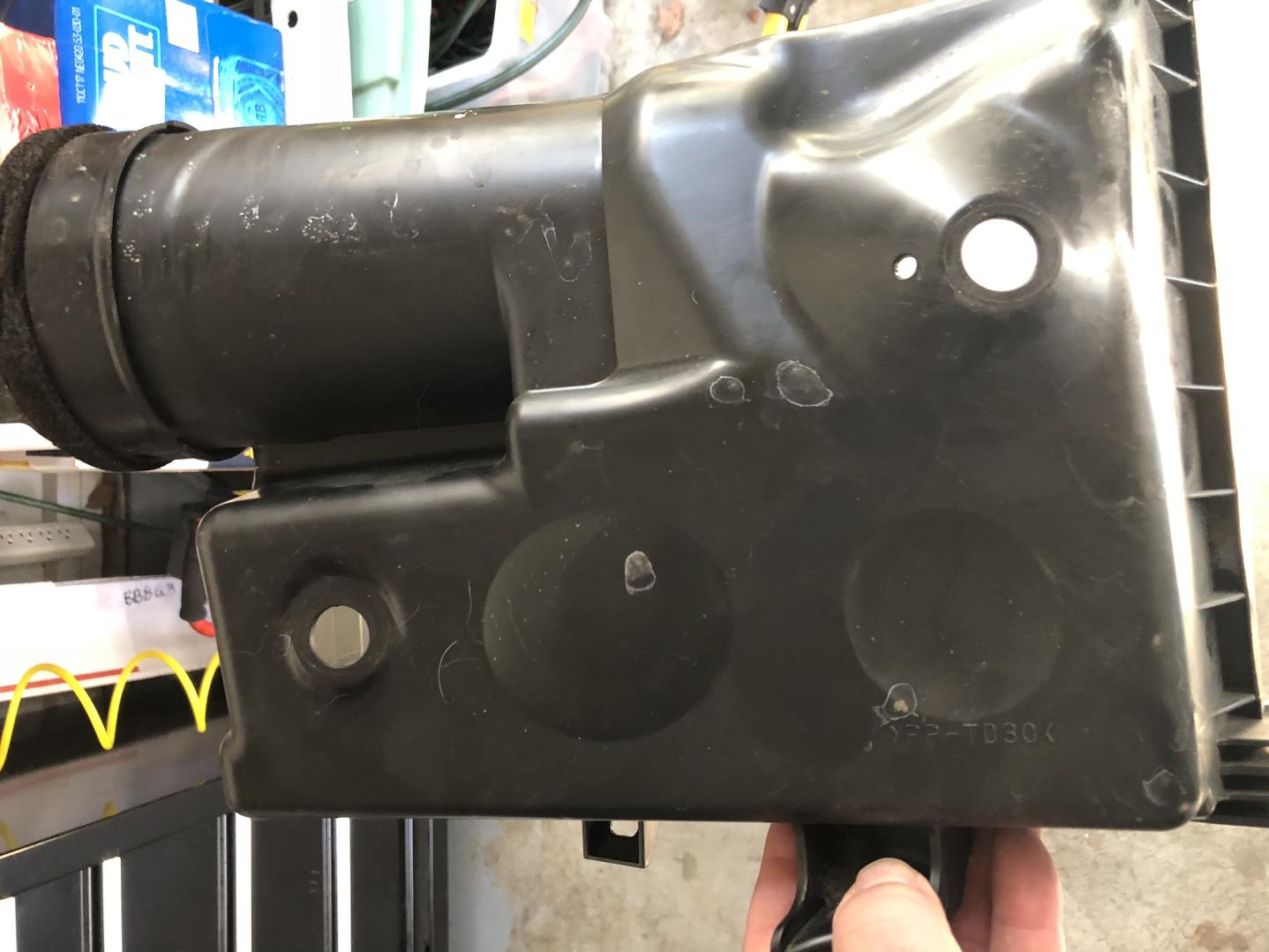

My airbox
Pic of the bottom of my box.

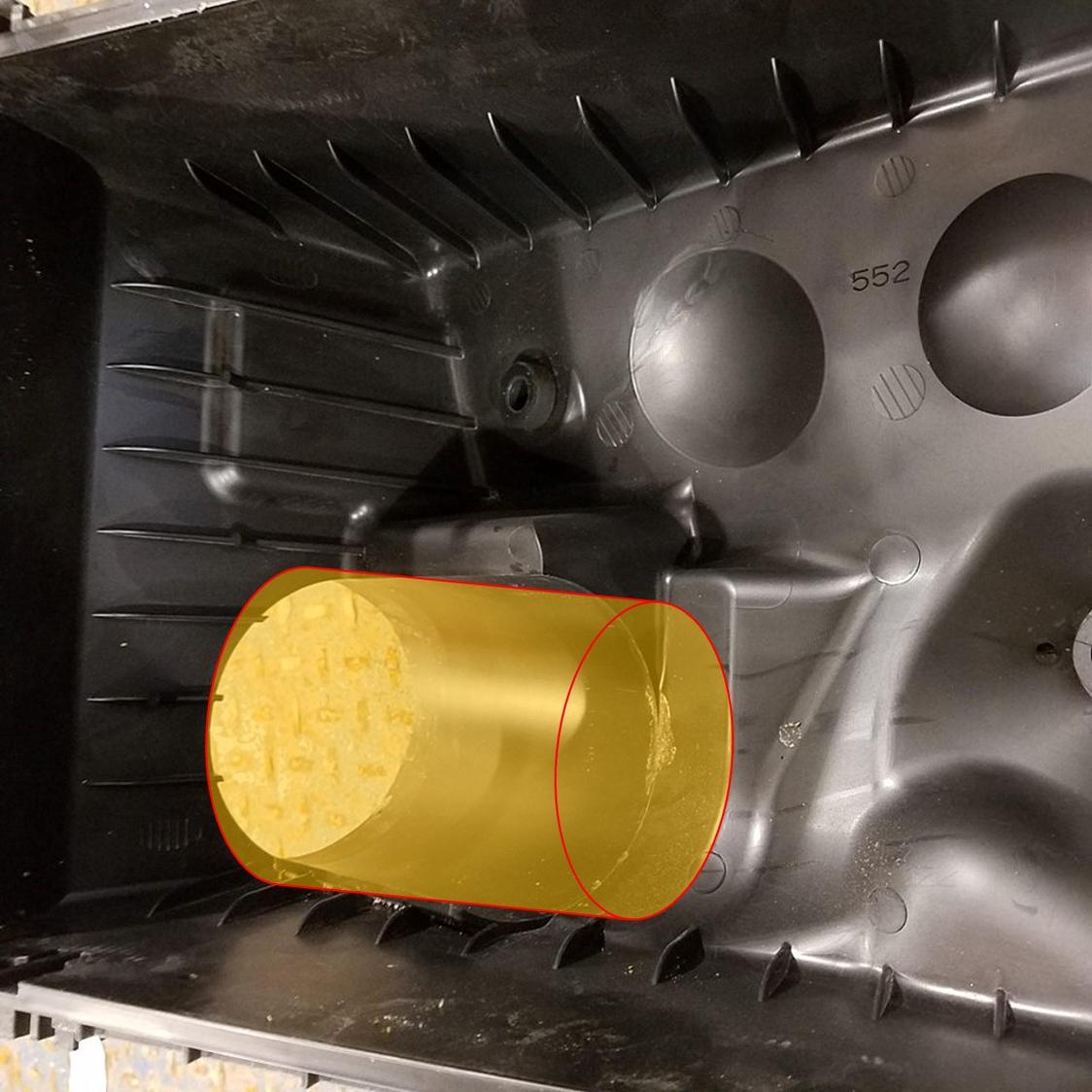

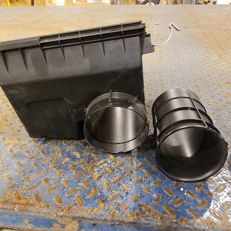

I made a post in the "what did you do to/in your 5th gen today" thread which seemed to get a lot of attention so I figure it would be a good idea to make a dedicated post about it.
So I was seeing a bunch of people post stuff about a restrictor in the stock air box which was noticed when replacing with an aftermarket intake. I figured there had to be a way to remove it so I messed around with it tonight after work. Removed the lower air box, removed the water shield from the intake box, tapped the restrictor from the inside once with a hammer, fell right out. May have improved midrange power and it has a subtle throaty sound to it now. Not the sound of an aftermarket intake by any means but I do hear a difference. Only other mod is an AFE Pro Dry drop in filter. 10 minutes and free, works for me!
I don't see any restrictors there. Are you refering to hollow insert?
To clarify for many, because I know I was confused. This picture shows where the diverter that is being removed normally sits inside the airbox. there is also a scoop on the outside that sits inside the fender.
The the second picture from the OP shows where the sleeve slides in from the outside.
It diverts the outside airflow more towards the center of the box. vs the far edge.

How do you explain the engineering behind the TRD intake? It has no "restrictor" nor any helmholtz resonators. I agree with you to an extent but I don't think this mod is as harmful to the power band as made out.
