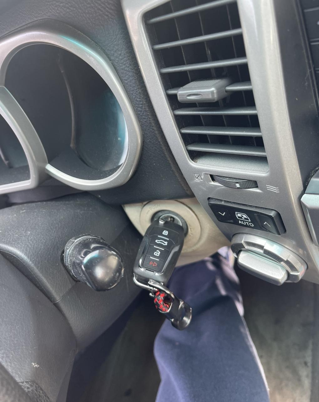

Here is a picture.

I have a switchblade style that I programmed myself as well. I like it way better. Sure it sticks out more than the factory key but it's not in the way of anything.
Sent from my KB2007 using Tapatalk
+1
It does stick out but it's out of the way and no bother at all.
It feels heavy and good quality.
One thing though is it's very easy to keep hitting that panic button by accident. I ended up opening it up and removing the little switch/button on the inside thus eliminating the issue altogether.
