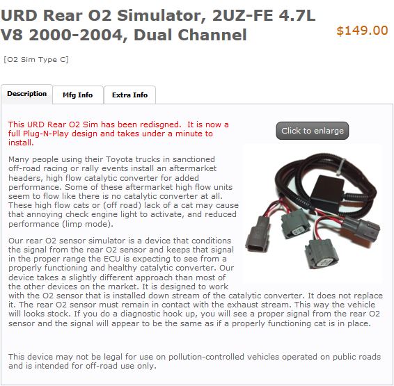

Sooooo, will this URD O2 Simulator allow me to run DT Headers on my 2003 V8 and still pass California Smog? ...of course, it's not for me, I am asking for a friend...:naughty::tape2:

That is what I figured, but got too excited at the thought and had to ask. :redbrick::thanks:
I completely disagree.
The header itself will be a cleaner burning/flowing experience for your engine.
The URD harness will prevent codes from being thrown and will prevent the dash from lighting up.
If you have installed the DT (or any other custom header), but retained all the other emissions equipment (cats and sensors), you will pass the emissions test. What you will fail is the visual inspection. Unless your smog guy is vision impaired :noidea:
