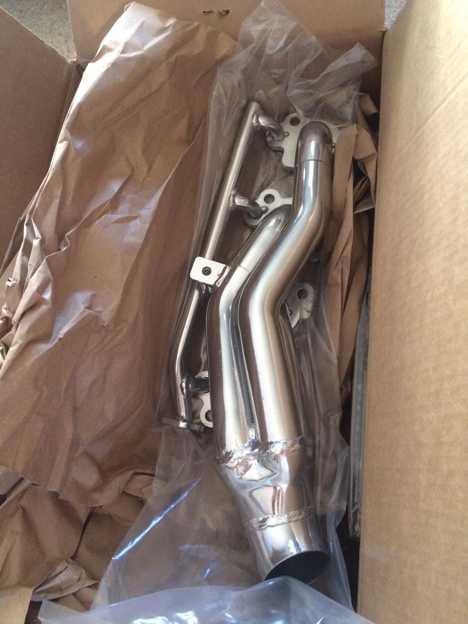

Step 1, purchasing the headers: After doing a good amount of reading and deciding that tundra headers were going to be too much work, I started searching for a set of DT headers for the best possible price. What I stumbled upon was a company called Colorado Speed that was selling the 05-09 headers for $674 with free shipping. Needless to say, I ended up purchasing a set from them. I feel that its a good time to note that these headers are made per order and take 1-3 months to receive the product "absolutely worth the wait".

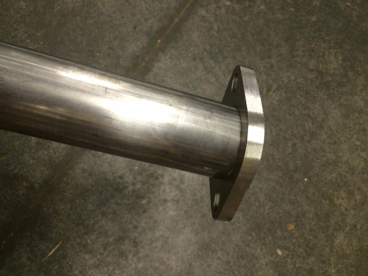

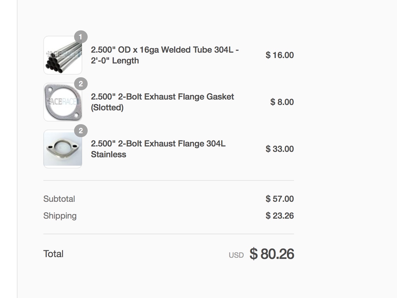

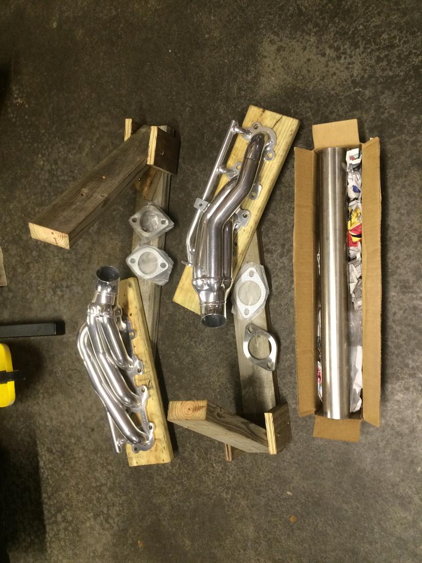

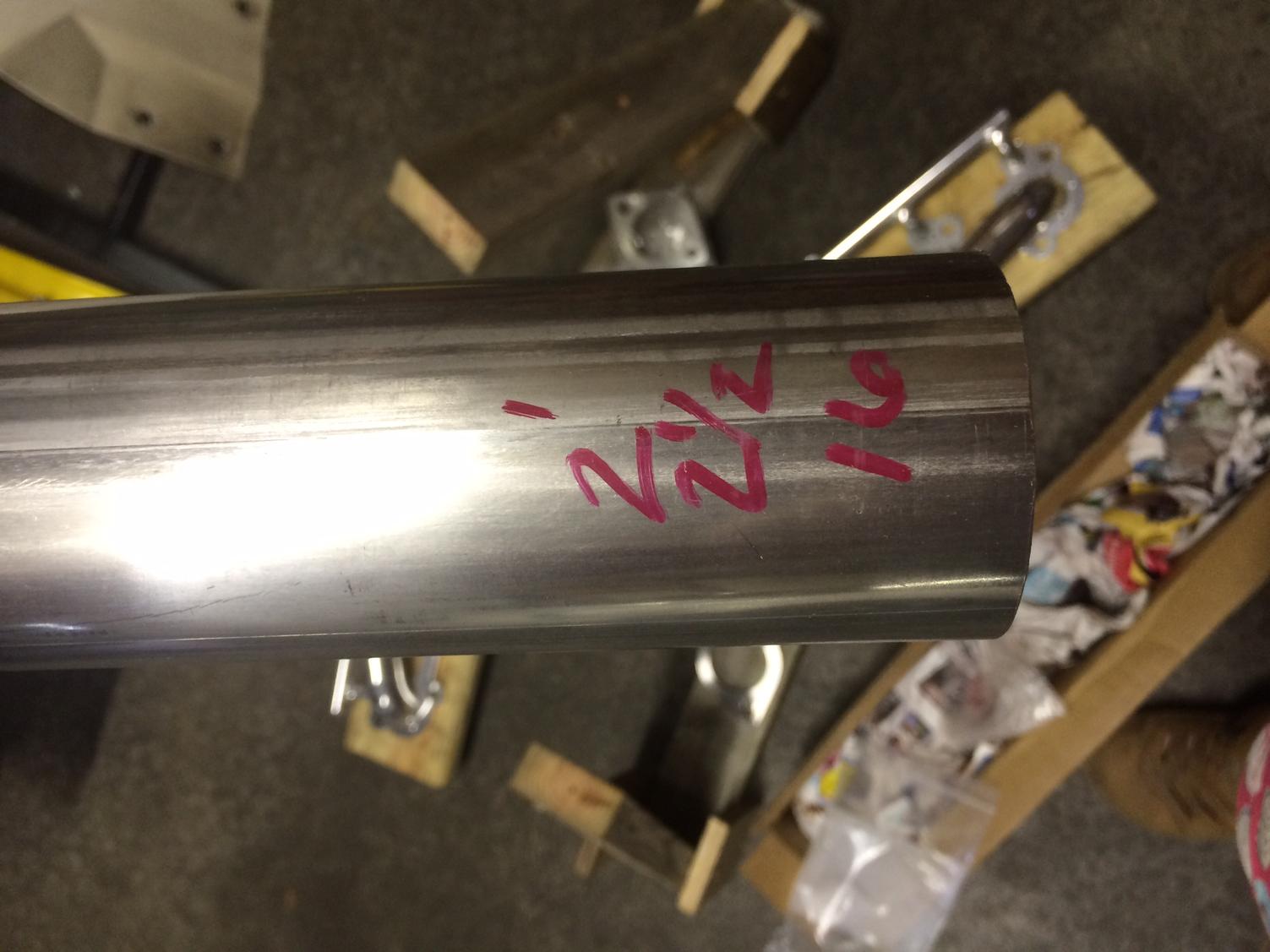

Step 2, Purchasing the little parts: due to the fact that I live in Wisconsin, utilizing that factory cats was not in my interest. As a result, I decided to run 2.5" .065 304L stainless tubing in the location of the cats. As most of you guys know, we still need as flange at the bottom of the down-pipes to tie back into the factory exhaust. This was a difficult item to find because A, I wanted 304 stainless and B, I needed a flange that would bolt up to the factory exhaust but also remain 2.5" for when I make my new exhaust. ACERACE parts ended up to be the perfect one stop shop; flanges, tubing, and gaskets all in 304l.
stainless.Ace Race Parts ? High Quality Fabrication Components

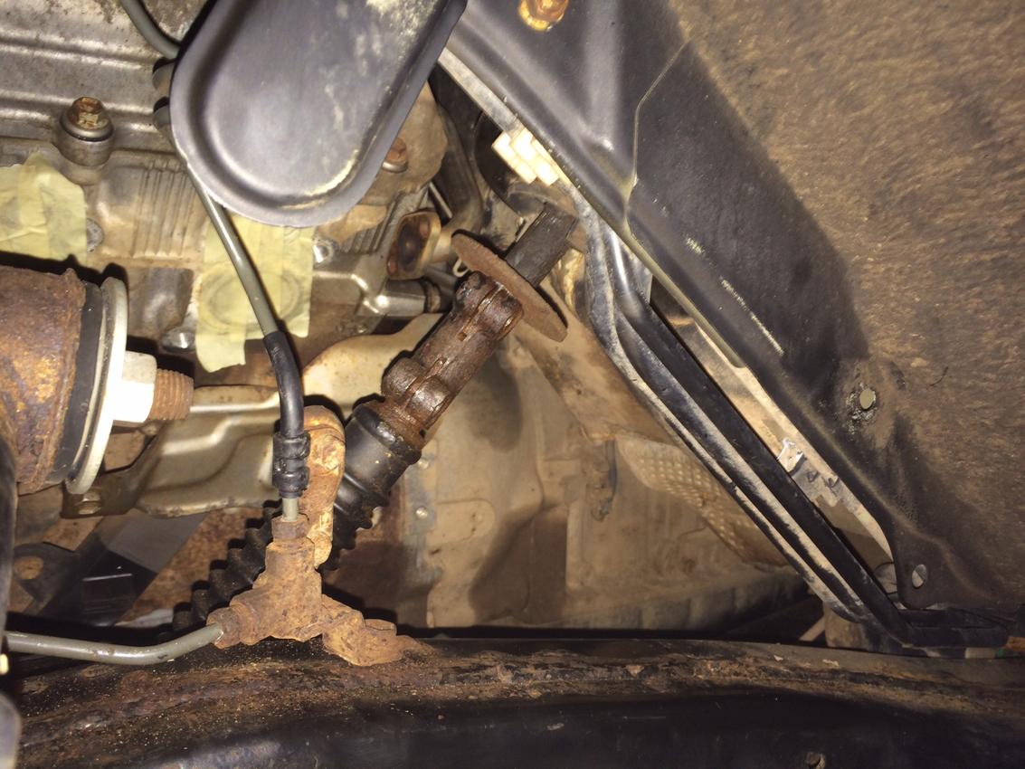

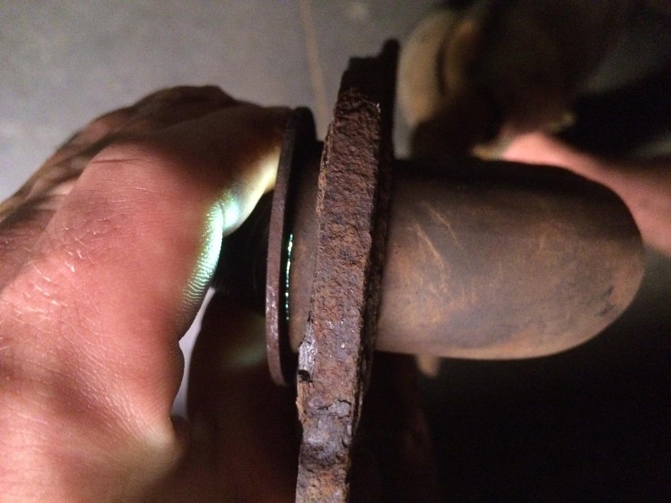

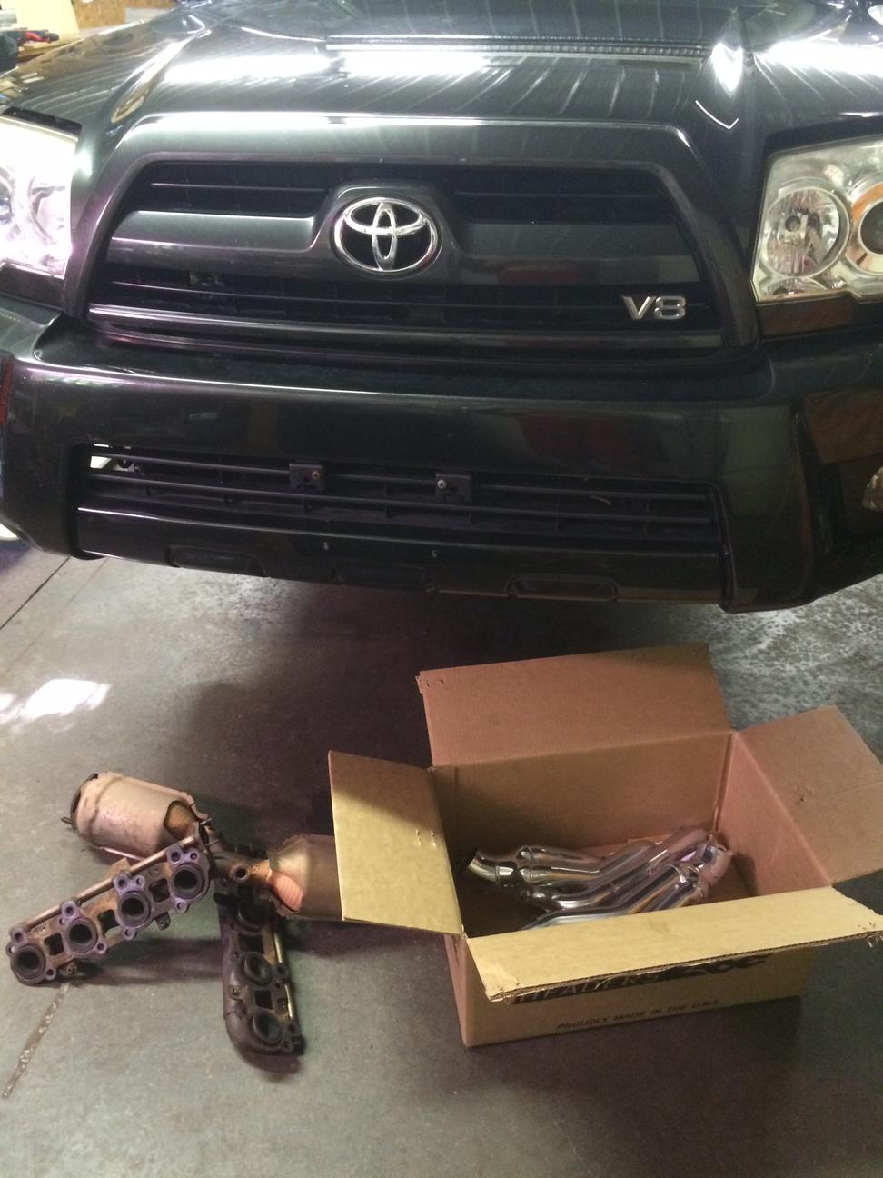

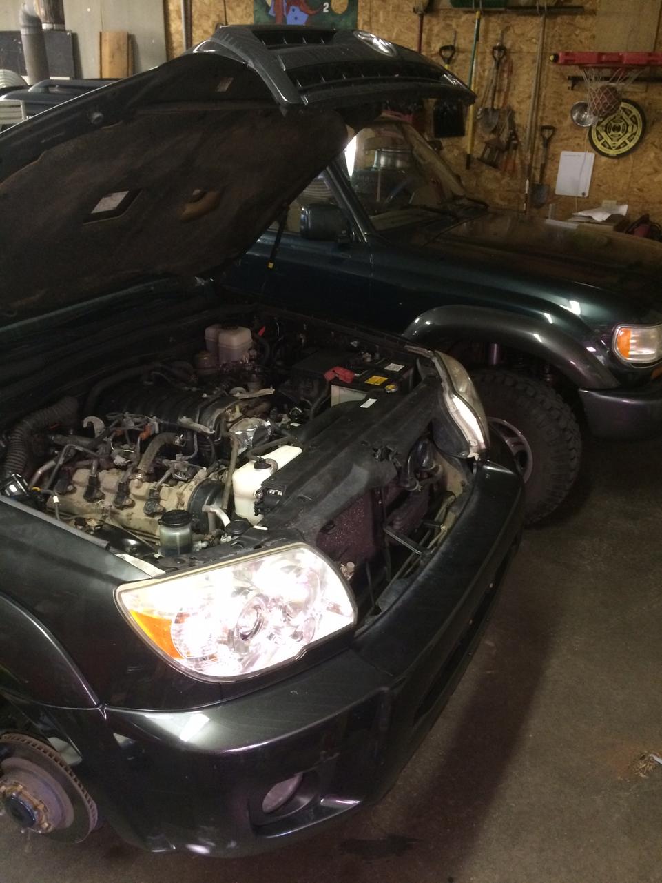

Step 4, Disassembly: Ohhhh the most dreaded part of the entire project. My truck has 110,000 miles so its just a baby. Needless to say, I was still worried about frozen bolts because all the difficulties other members were experiencing. To my amazement, there were no broken bolts or issues of any kind. "IMPORTANT" take your time with removal of the old header bolts. Find someone to give you a helping hand and make sure your socket is completely on the nuts/bolts that are being removed. I lucked out and had all 16 bolts extract with the nuts. I found that the top bolts were easiest to remove with a breaker bar that has a head capable of rotated a little past 90 degrees. The lower bolts I found that the best way to save skin on you hands was to put the 1/2" impact on and just give-er

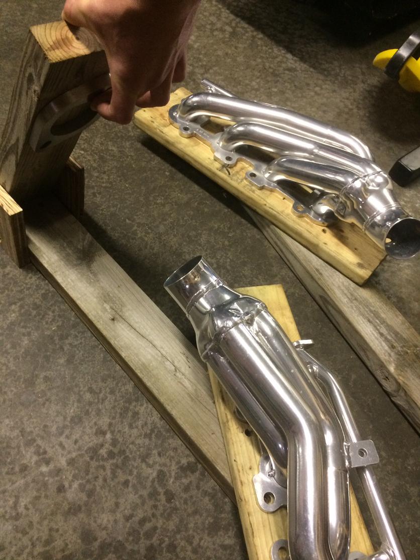

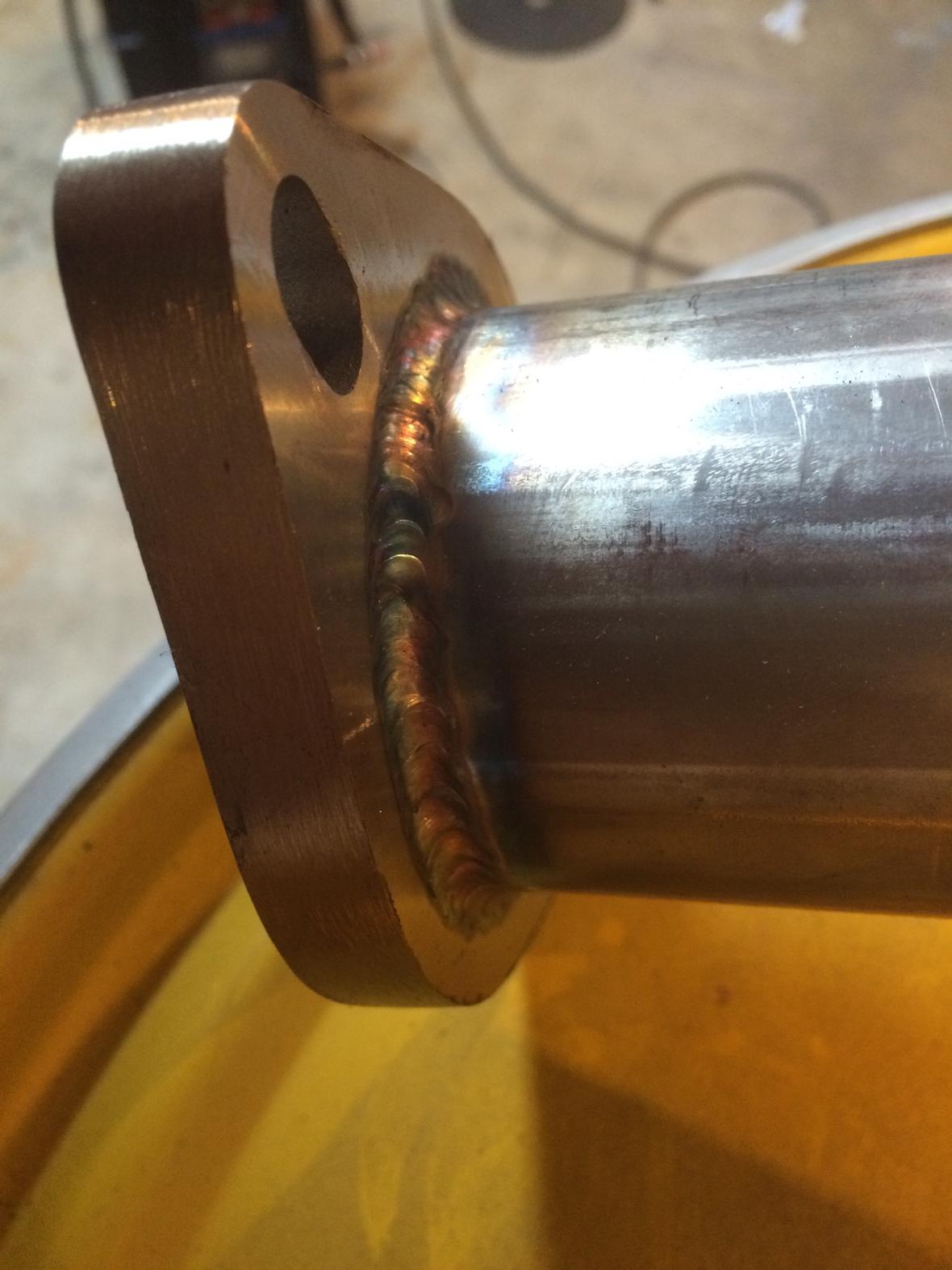

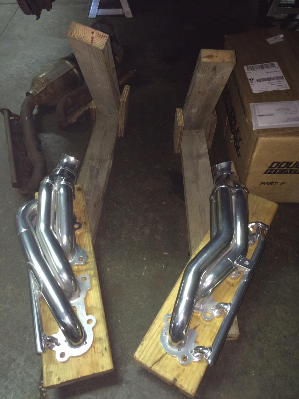

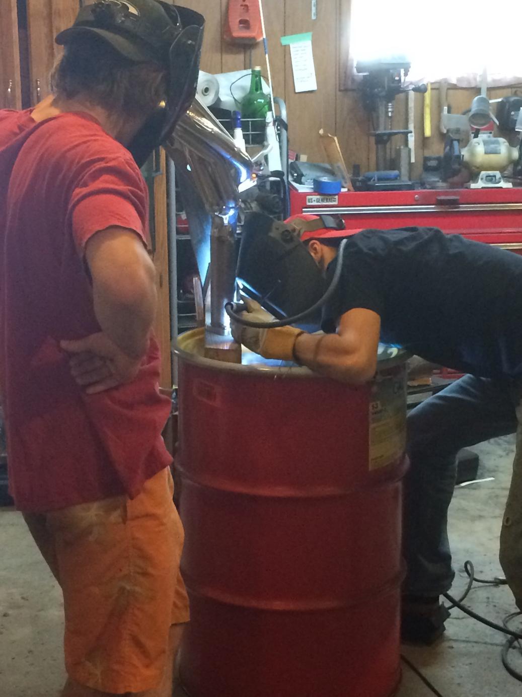

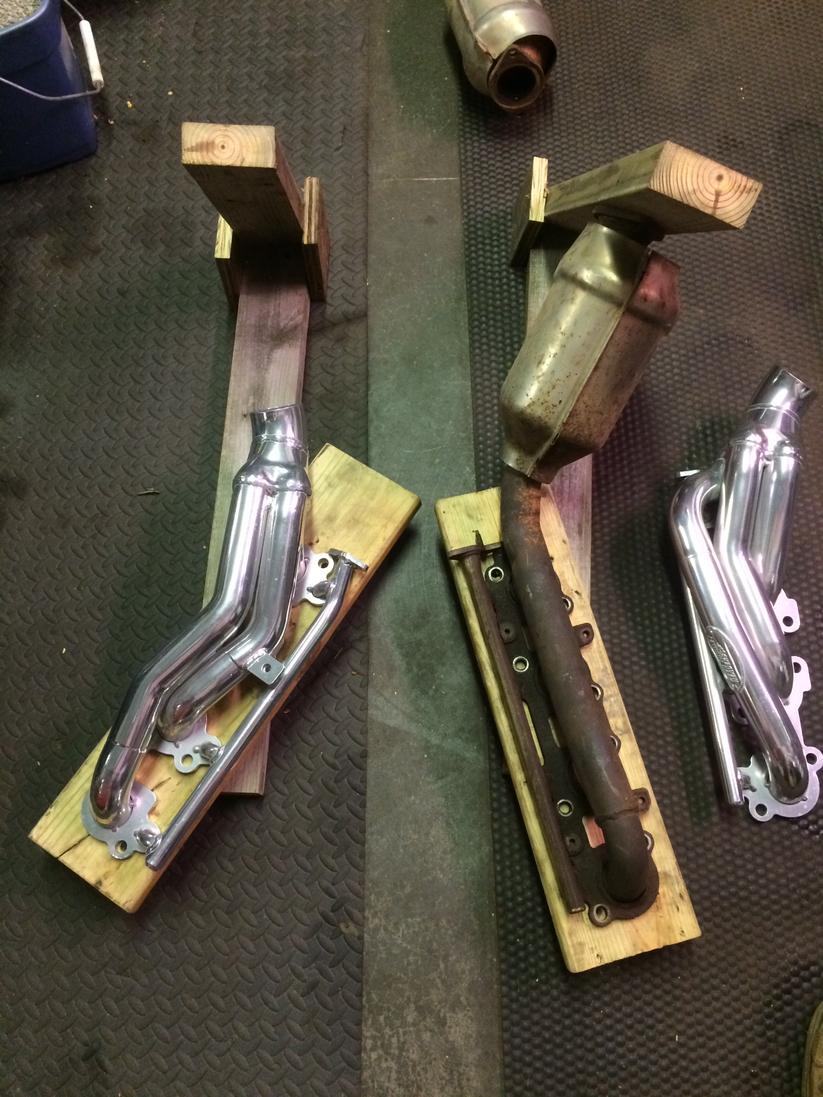

Step 5, Welding and test fitting: Due to the fact that this is not an inexpensive project, I had my buddy TIG weld the collector and flange. This process was greatly enhanced by building a jig around the old headers and simply mounting the DT headers. By utilizing this process, Absolutely no welding took place in the cramped engine bay. Just to be safe, we tacked both headers and did a quick test fit to make sure all was well. I would like to thank the individual the gave me the great idea earlier in the thread. No problems with the jig, Joe was a happy guy.

Step 7, Post pictures for all the guys that really hate reading.

Love these picture.
Nice Tig welds as well.

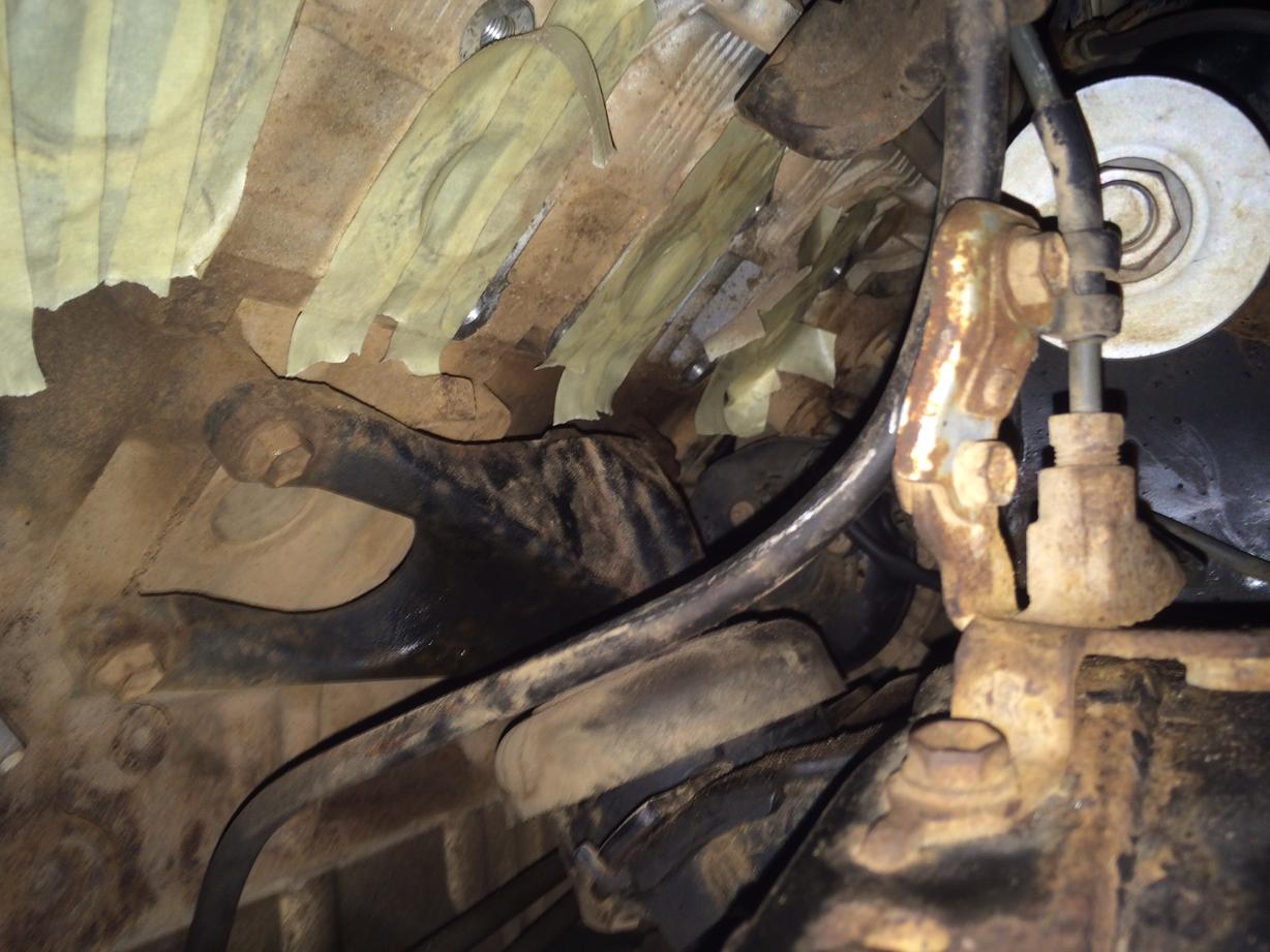

Any undercarriage pics of them all mounted up? I am one emissions inspection away from not needing another on. I think I am going to go ahead and get it done and then just ditch all the cats and stock stuff.
Run a dual exhaust and dump it out before the wheels on either side.

Glad the jig making worked out for you! I think the biggest benefit is that it can be welded 100% throughout 360 degrees. Welding on truck there will be blind welding that is confirmed by feel. The off truck method can be flipped over, taken off jig, ECT. Great job!

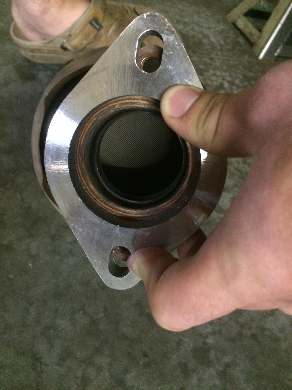

Just skimmed through the thread really, but seeing the pics, I seen not one pic of someone using flanges for the header and cat connection, they are all welded together instead. Why is that? Not enough room for flanges in that area?
Would be much easier to remove the cat for any reason after the install. Instead now you have to cut and re-weld.
I don't understand it either. I don't know why thorley didn't install them either...
I requested to have them put on mine on the intial group buy, but I don't guess it was available on that set.
Anyway, Looks to me like there's plenty of room. I'll be doing a 3 bolt flange or a high quality v band clamp on mine and I'll build a 2.5" catless y-pipe.
Please take pics if you do the flange's. Would love to buy these when I have the funds available, but not if I can't make it a bolt on connection.

Made some progress on my jigs today. There's quite a bit of slop in the bolt holes so hopefully centering them up works fine.
Honestly for me it was easier. The new cats have no flange. So you would need a flange welded on cat and header and the have to line up to meet the point on jig. With the jig I used, the cat was cut into to make the angle so no filler metal was used. Also the flange on my 03 that connects to y pipe was completely rusted. And the jig isn't perfect per say so the angle of the cat to the y pipe is off a little so muffler shop chopped off some y pipe where old flange was and welded the connection to cat with a couple inches of filler pipe. Hopefully the high flow cat will never go bad and if it does it will just be placebo cat for looks. So thats home mechanic. If your paying a shop to do this make the above mentioned all their problem and have flanges put on. Also not one muffler shop in my area had flanges that would fit, so one more thing you need to order and to do that you need diameters of cats and headers, which mine where different by 1/2 inch or so, so angling the cat on the header filled that gap. These are my analytic afterthoughts. Before though I didn't know how the hell this was gonna work. For the MagnaFlow cats you need like a reducer pipe going to header because the diameter is so much bigger you can't fill with a weld. Or find cat with same diameter.. my last thought as I write this is weld it up and then cut it apart and add flanges. But is that really worth it. If I personally need to remove cats I will cut where they connect to y pipe and take out with header. And since the new cats won't have a flange I'll just pay a shop for a direct weld again instead of paying for a flange weld (I have no welder). Anyways those are my thoughts- it was easier and needed no parts or thoughts or alignments or constant installing and removing header to adjust angles and fit.
