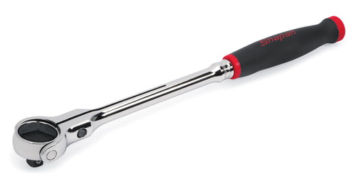

Get yourself each of these or equivalent in the appropriate size. You will thank me later.

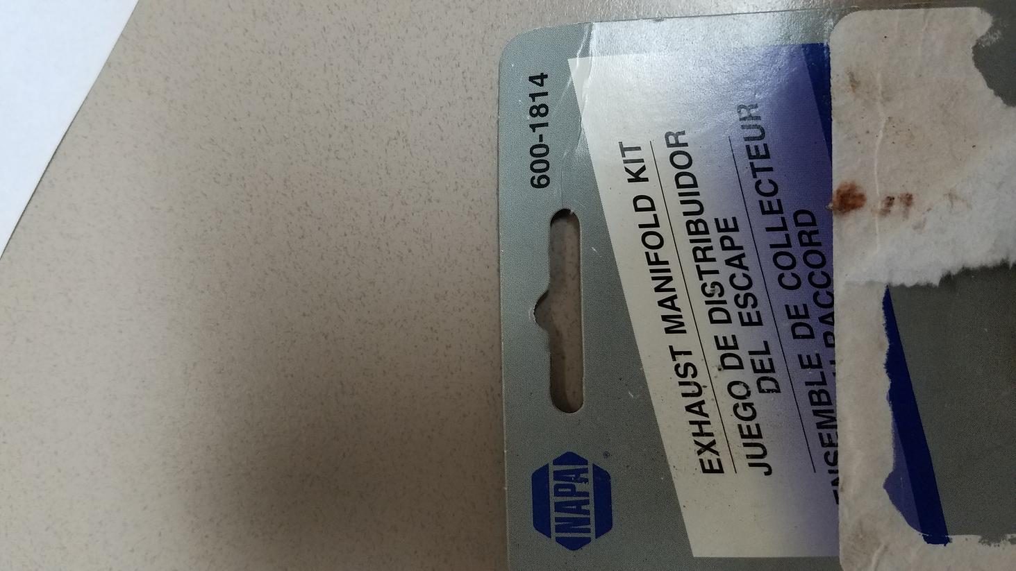

Napa has the correct size studs with nuts. Nuts take a 17mm tool and are made of brass. Worked well for me but they are not factory so use at your own discretion. 2 studs and 2 nuts per pack. $5.99

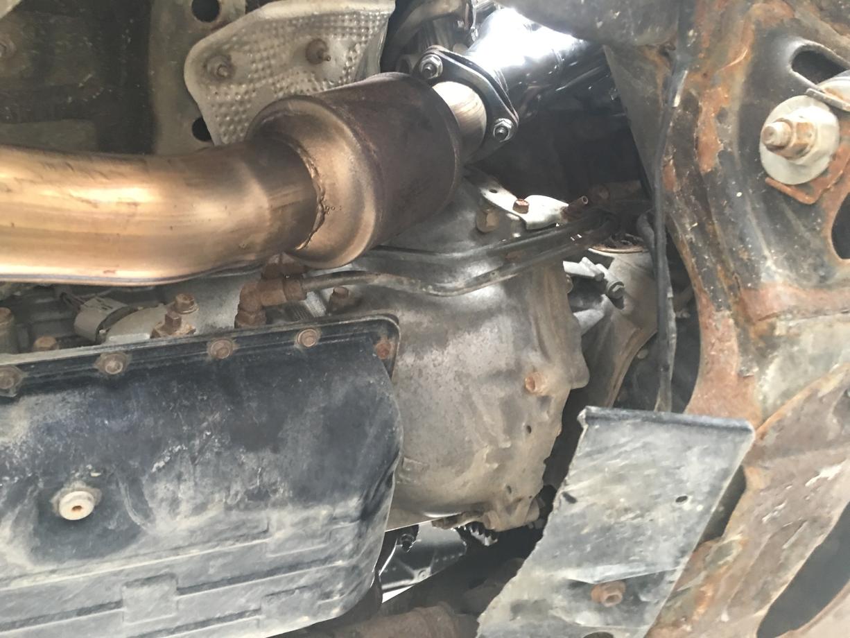

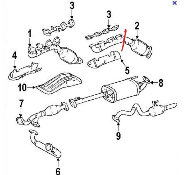

For removal cut here on both sides (forward of the O2 port) with a jabsaw and drop the cat out. It will greatly increase clearance for removal of bottom bolts.

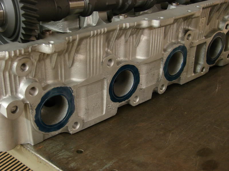

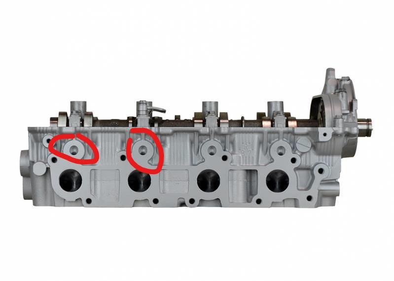

You will need to buy the 2005-2009 headers and cut them off and weld them shut. The 2003/2004 headers do not have the "ear" on them to seal the port going into the combustion chamber.
I wish DT would offer the header with a solid ear and no AIP tube "for offroad use only". Lol
Sent from my SAMSUNG-SM-G891A using Tapatalk
Here are the heads to show the difference
2003-2004
2005-2009

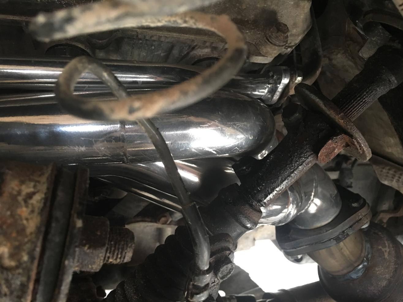

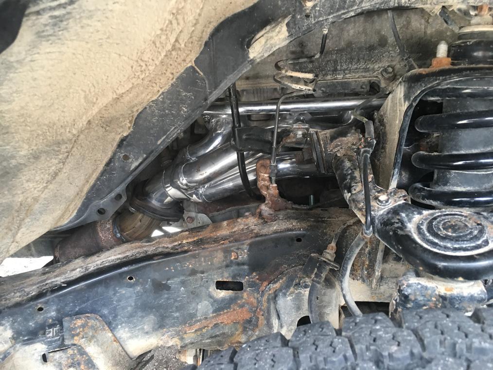

Installed pics and a sound clip of the headers with 2 cats deleted, custom y and magnaflow exhaust entering a tunnel.
