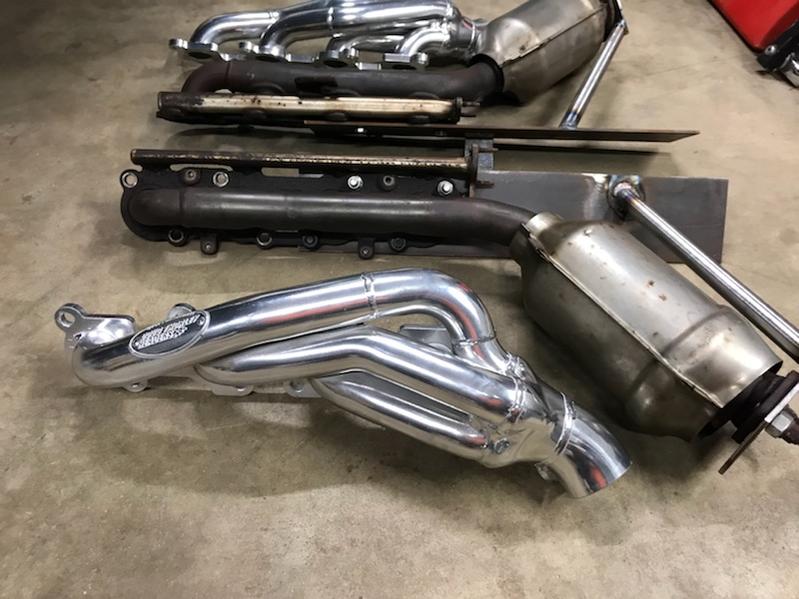

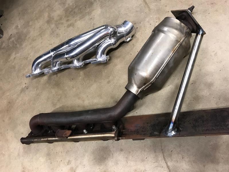

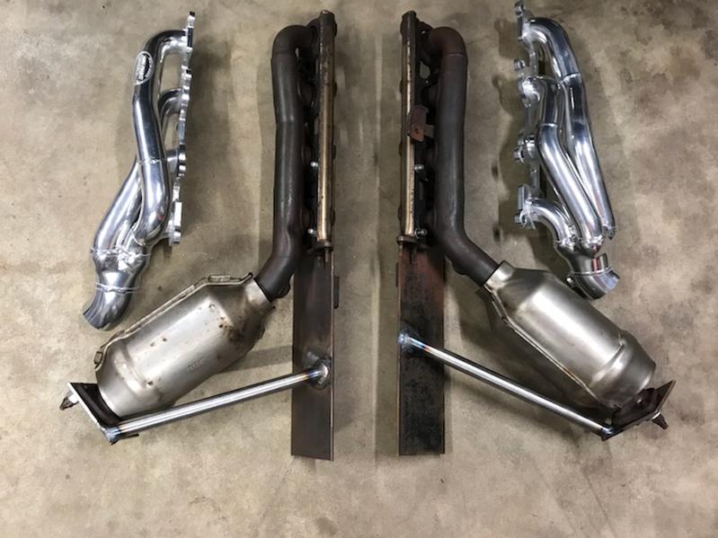

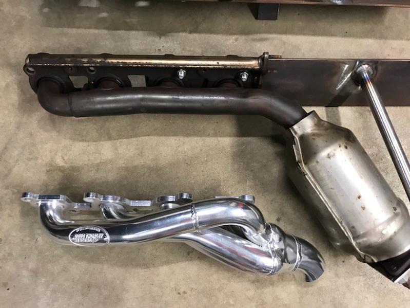

Some pretty pics compared to stock. Remember. These give 30 hp gain! It’s just nuts.
05-09’s back in stock and can SHIP MONDAY!!! Links above in my last post
