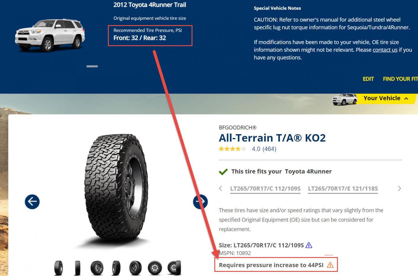

Sorry if this was already posted. I've been reading the tire pressure threads, well a lot of them, and I decided to go to the BF Goodrich site and was surprised by the disclaimer right on the page for my stock tire size. It says clearly that I need to raise my inflation pressure to 44psi. I have been running 32psi. Don't remember ever seeing this before when I bought my tires many miles ago. Check it out.

Sorry, where did you find that tire pressure spec? Following your link, I see general information and when opening specs on the C and E versions of the 265/70-17, the tire pressure at the max. load.
This is it
Sorry, I guess the link removes my specific vehicle info because of cookies, I guess. Like SoCalRunner posts above, after I enter the year, make, model, it gives what is pictured above.
