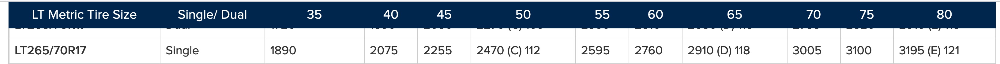

Ok, I double checked the math. My original P dunlops were rated at 2425lbs at 32psi, then derated to 2204lbs being on the light truck (4runner). Cross that over to the TAKO2's LT chart, and 44psi makes sense, 45psi would be 2255lbs.
At 40psi now, going to give 44 a try for the hell of it. I realize everyone has done this already and this horse has been beat to death over the past 10 years, but I guess I'll see for myself and add to the validations!
Thanks for posting this. Falken Wildpeak A/T3Ws, here's the excerpt from their chart attached. Sounds like 44PSI (43.58 to be pedantic :D ) would match the Dunlops. Local dealer set them at 38, which has been ok but maybe it's time to pump them up a bit.
Cool. For the load rating I believe you round up. The ride is a bit harsher for sure due to the higher pressure but the wear and stability has been better. Really wish they made a P rated KO2 to run in the 32 range. I guess that's the compromise you make going to LT.
SCFW. How are you calculating the precise tire pressure? It seems you’re using some formula and not just a chart. I found this formula from a you tube channel.
So this says
Actual axle tire weight load / Max tire load x Max tire PSI = Recommended PSI
So if the 4Runner GVW is 4,400 lbs (TRD Pro) that give a per axle weight of 2,200 lb
(If anyone know the actual front and rear axle load please let me know)
KO2 265/70R17 C Load
KO2 max weight load is 2,470 lbs
KO2 max PSI is 50
2200 / 2470 x 50 = 44.53 PSI
Is this correct?
Thanks

LT tire pressures
The info I posted was for LT265/70R17 E-rated. I don't see a listing for C-rated.
I'm not able to upload the PDF, but it's here:
https://www.toyotires.com/media/pxcjubjs/application_of_load_inflation_tables_20200723.pdf

I don't see a distinction between C-rated and E-rated for inflation recommendations; it seems that it's just a matter of the maximum inflated pressure, which then dictates the maximum load.
I note that when I plug a 2021 ORP into the Discount Tire site, it offers the C1- and E1-rated KO2s but not a C2. There may not be a KO2 C2 in that size, of course.
This all sounds to me like C-rated and E-rated should be inflated to the same pressure for the same load weight, and that we shouldn't be using C2-rated tires on 4Runners as there's no way to adequately inflate them.

DOT standard load inflation table is shared across all LT tires at the same size, no matter range C or D or E or F. Load inflation tables for D E F just extend cold inflation pressure above 50psi.
