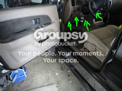

1st thing to do is start with your speedo. Your gonna have to remove the lower panel below your steering wheel. There should be 4 12mm nuts or something close to that
001-14-1.jpg~original
get those out and pull the panel out.
(you dont need to take it out completely, there are some wires like the security light and locker button that are attached to that) just basically move it out of the way

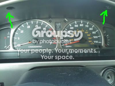

Next, you have to start with your trim that surrounds your speedo. There are 4 screws you need to remove. Two of them are in the top of the inside part where it curves, and the other two are on the bottom. get that sucker out,
dash-1.jpg~original

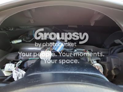

Now you have access to the speedo. there are 4 more screws you need to remove and then it should be loose. you can kinda see where they are in this pic
DSC01788.jpg~original
unplug everything and you have the goods! Youll need to take off the white panel guard to access the bulbs, but there are 3 bulbs all in the middle part. For my truck i had to also unscrew the small circuit board to get to the middle light.

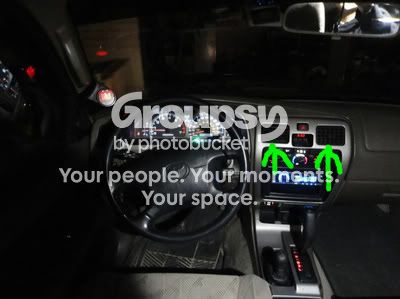

Now its time for the HVAC, I have done this a bunch of times and this method has worked best without breaking anything. open your center consul, and pull up on the black piece (cup holders and everything) it should pop right out.
DSC01867-1.jpg~original
next, Your trim around your gear shifter should also pop right out. Next I grab on to the 2 upper vents and pull.
newstuffs007-1.jpg~original
unplug everything and now you have access to the HVAC bulbs
For these i know yours is different so your gonna have eyeball it, But your HVAC should have some screws you gotta take out. Pull your knobs off, and the display panel that tells you if your cold or hot or hi or low etc...
the bulbs are in the back of that. I had to remove a black cover to get to these too

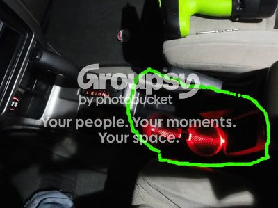

dahh! Yeah i haven't figured those out yet. Also did you guys know (for those of you that have it) but the center dif-lock button is also supposed to light up too? i put a bulb in there and got nothing but yeah...
