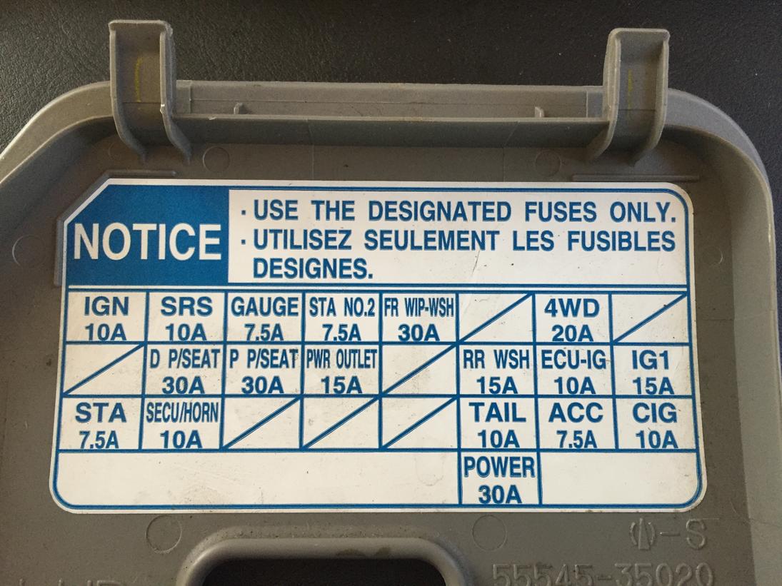

So a while back the 7.5a "ACC" fuse blew in my truck. I replaced the fuse and it was fine for more than a year. Last week it popped and now it keeps popping as soon as the key is turned on..... Can anyone shed some light as to where this circuit runs from the fuse panel ?
I know it powers the side view mirrors, 12v socket (near shifter), radio and some others...
Just wondering if there is a known problem or issue to look into first...
There is nothing spliced or tapped into this circuit other than the aftermarket HU which has been installed for 4 years now
thanks in advance
check the 12v sockets for loose change in them, then recheck the radio connections. i have found people drop pennies or dimes in their sockets and it just blows the fuse.
