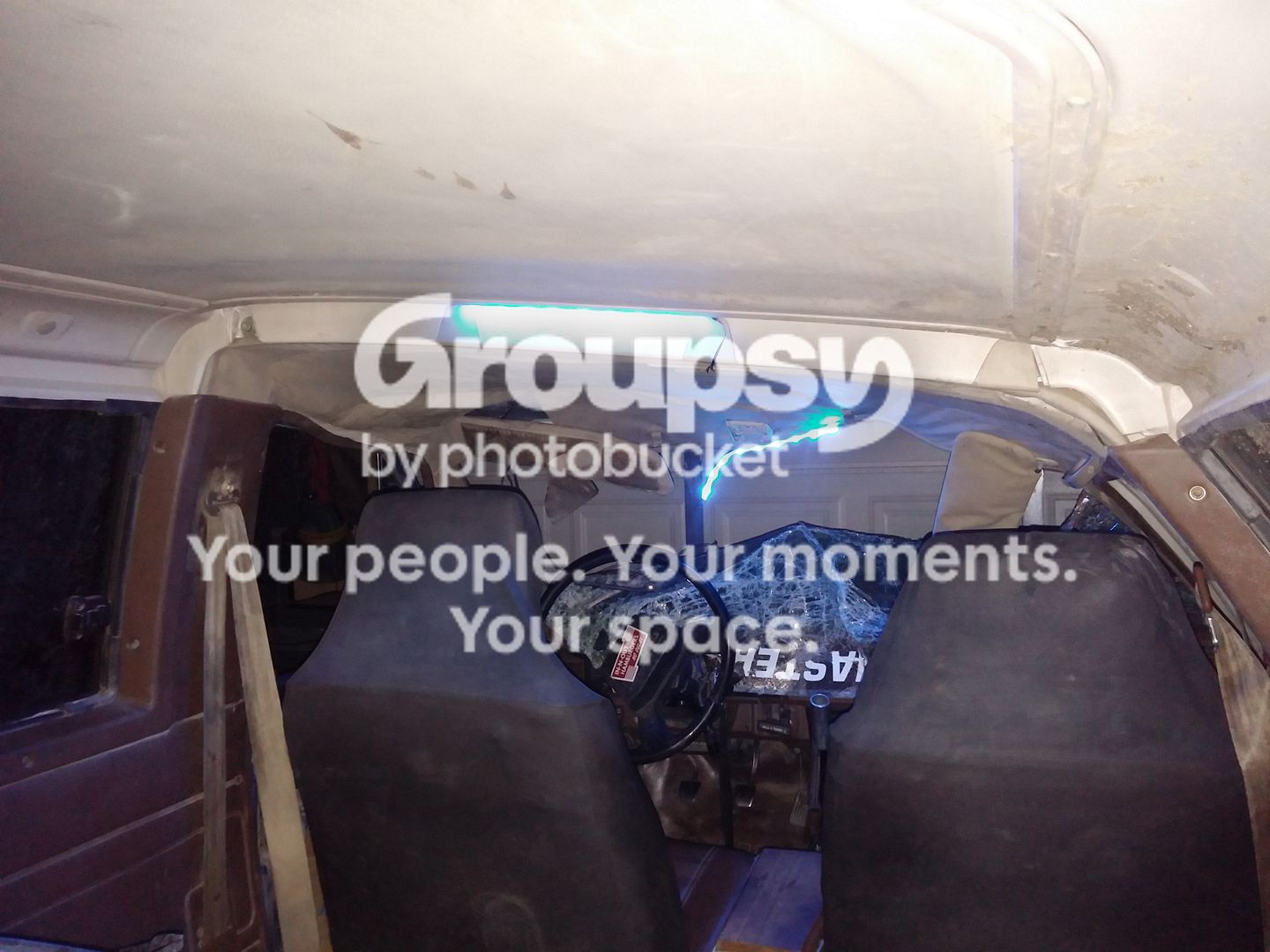

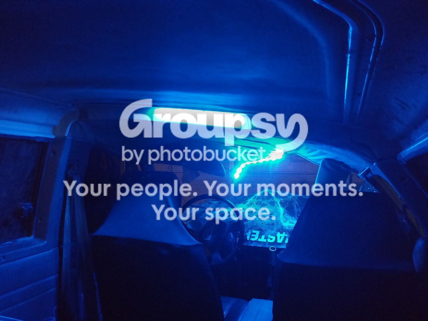

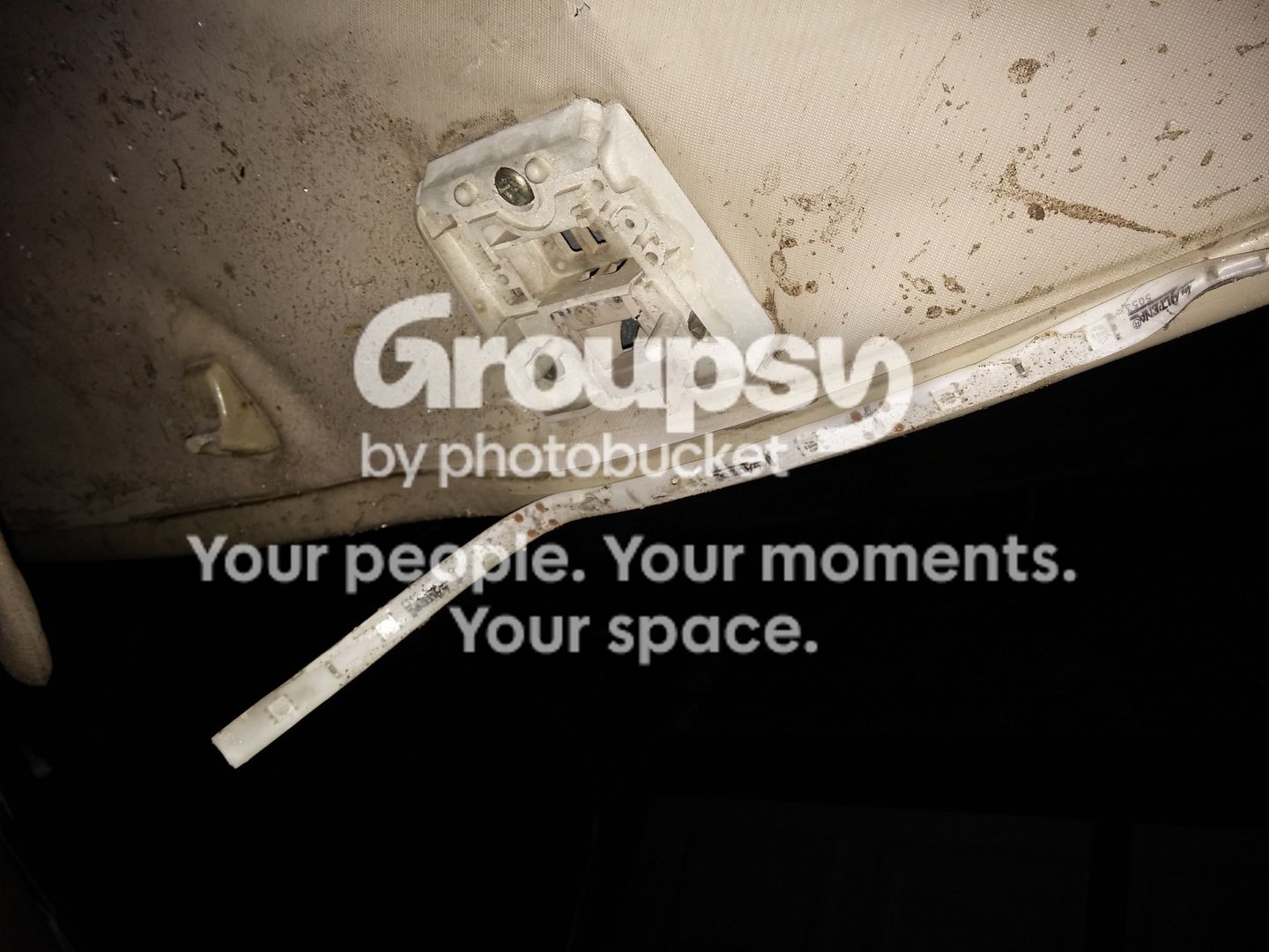

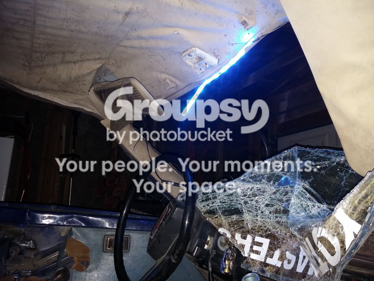

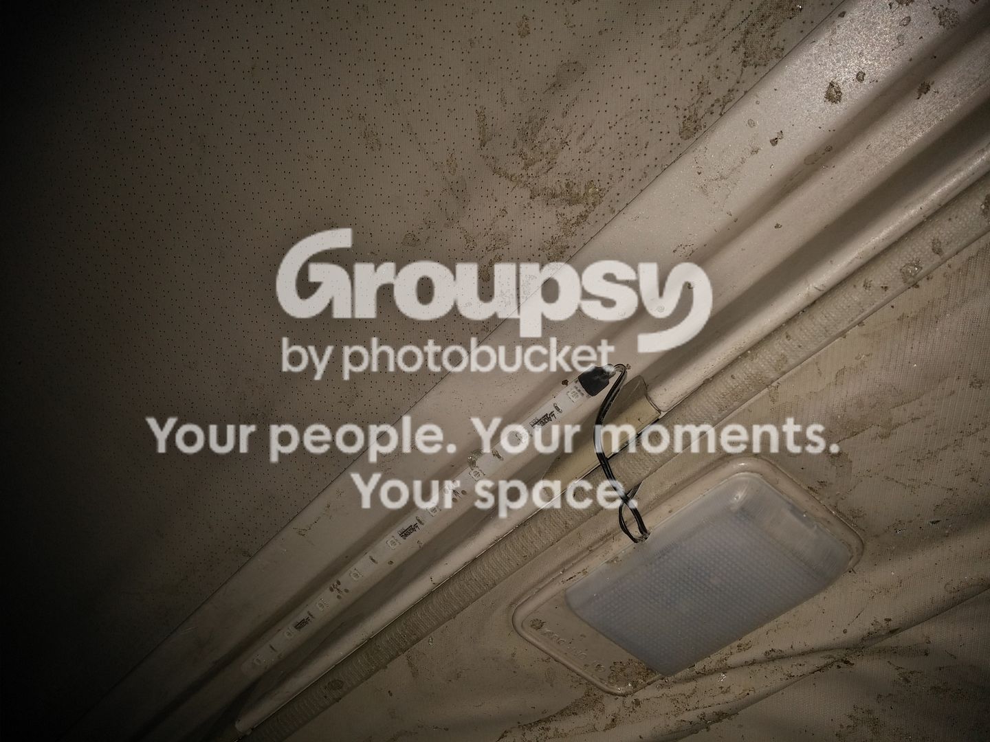

Heres what i did.
20150727_020335_zps33jibn5l.jpg~original
20150727_020424_zps1sospvsf.jpg~original
20150727_020221_zps8bicb2xt.jpg~original
20150727_020209_zps5ypah2u3.jpg~original
20150727_020234_zpsyiwrmmdu.jpg~original
Went to walmart and got some of these LED strips and just hooked them up to where the bulb use to go. Hot goes to hot, ground to ground. They worked great. Plus you can get them in just about any color.

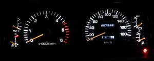

You can get LED kits from ebay and faceplates. I'm not convinced green, blue or red LED's are that good visually on old style dials - I'd suggest you stick to white. They do have some shadow zones, not like the OEM bulbs.
Its a bit of work to get the cluster out but nothing too hard - bulbs are simply plug & play. Search led cluster bulbs 4runner for ideas.
This is Lowrange white faceplates for reference.
1989-1991 Toyota 4Runner/Pickup Face Gauges w/ Tach
