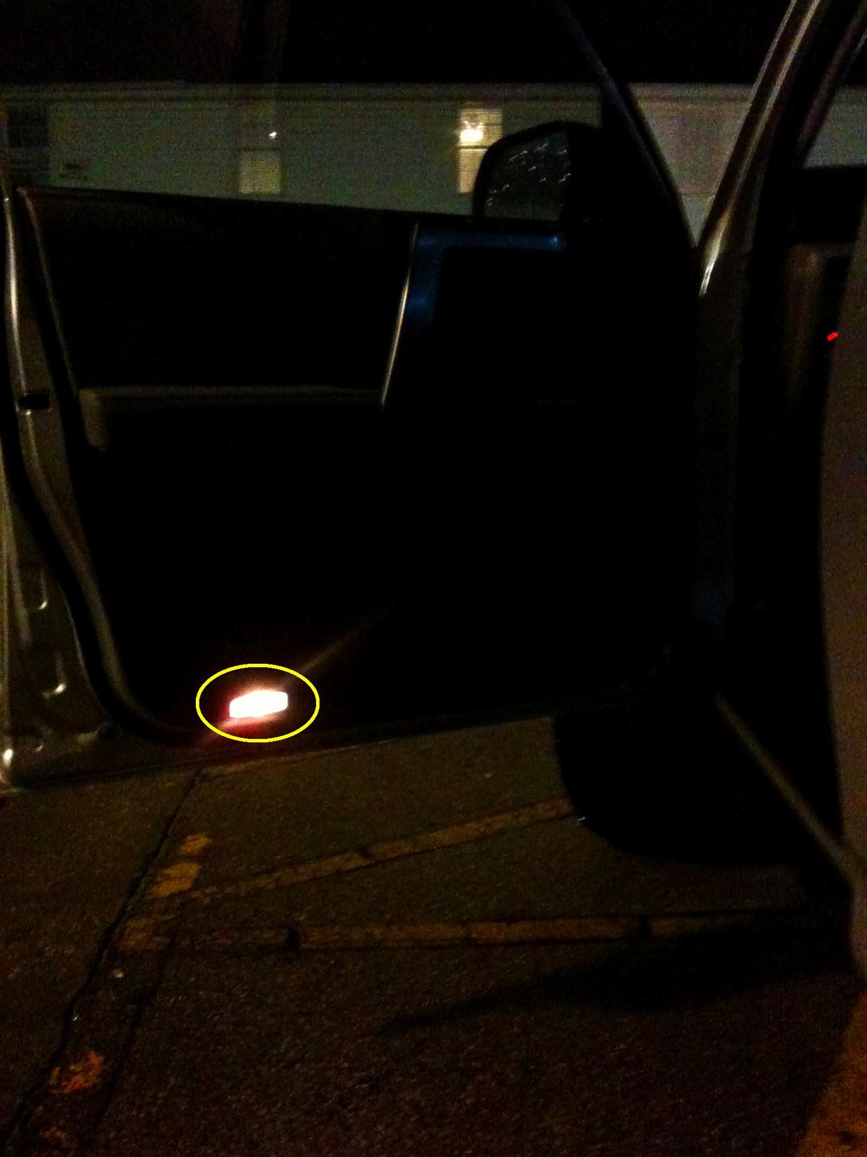

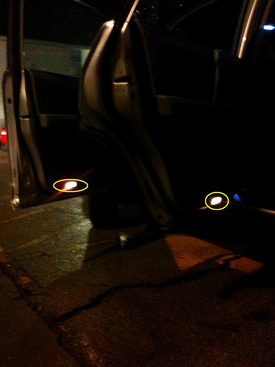

Anyone know anything about the door lights? I hadn't even noticed them before but popped out the unit today and it looks like the same bulb as the map lights. The bulb is enclosed in some kind of extra case after you pop the unit out that I couldn't figure out. Granted I spent about 2 minutes looking at but wondering if anyone has already done this swap... Thanks!

No, I was talking about the lights on the bottom of all four doors. Kind of like step lights I suppose. I pulled them out and popped off that extra case I was talking about and it takes the same bulb as the map lights.

Surely I'm not the only one with these... Sorry for the crappy phone pics, they upload humongous.
Notice the "cool white" color in the background from my newly installed leds! Still can't believe I missed these door lights...

Checked my SR5 and see there is a spot for these lights (a cover there now - maybe a future mod to tackle!) You must have a Limited or Trail.

I have an SR5 and I HAVE these lights, so I do not think it is a TE or LE thing. I have the leather package, wonder if they are included with that? I went to the garage to double check before posting this, and yes, they are there! :)
