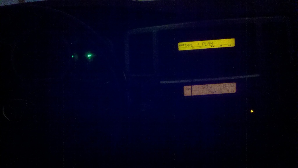

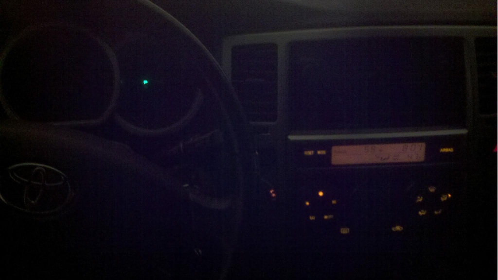

I can't seem to get my interior lights to come back up after a few stereo installs. Here's the story: I replaced my factory radio (non-jbl) with an alpine double dinn radio. Previously with my 91 and 97 4runner, I didn't have to connect the dimmer wires, so I didn't with this one. Apparently I was wrong and it was required. With headlights off, the dash lights were on. When I turned on my headlights, my dash lights (mph/rpm gauges) failed to light up. I knew it'd be a quick fix so I left it for the time being. Eventually I sold the alpine unit and upon reinstalling the factory radio, I figured things would just come back on. Well they didn't. Now my dash lights do not come on at all, and the middle temperature selector does the same. While lights are on, the radio light goes out, but the left and right temperature selectors come on. So weird. I attached two pictures, one is lights on, one is lights out. I have checked fuses, being "pretty sure" I checked the right ones. It seems like half the system works, and the other half doesn't. Any Ideas? Thanks

Those came out huge, sorry. The first one is with the lights on, the second pic is with the lights off.
