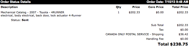

Happened to me this summer. Bad news is you have to order the entire mechanism. It's a 30 minute job.
