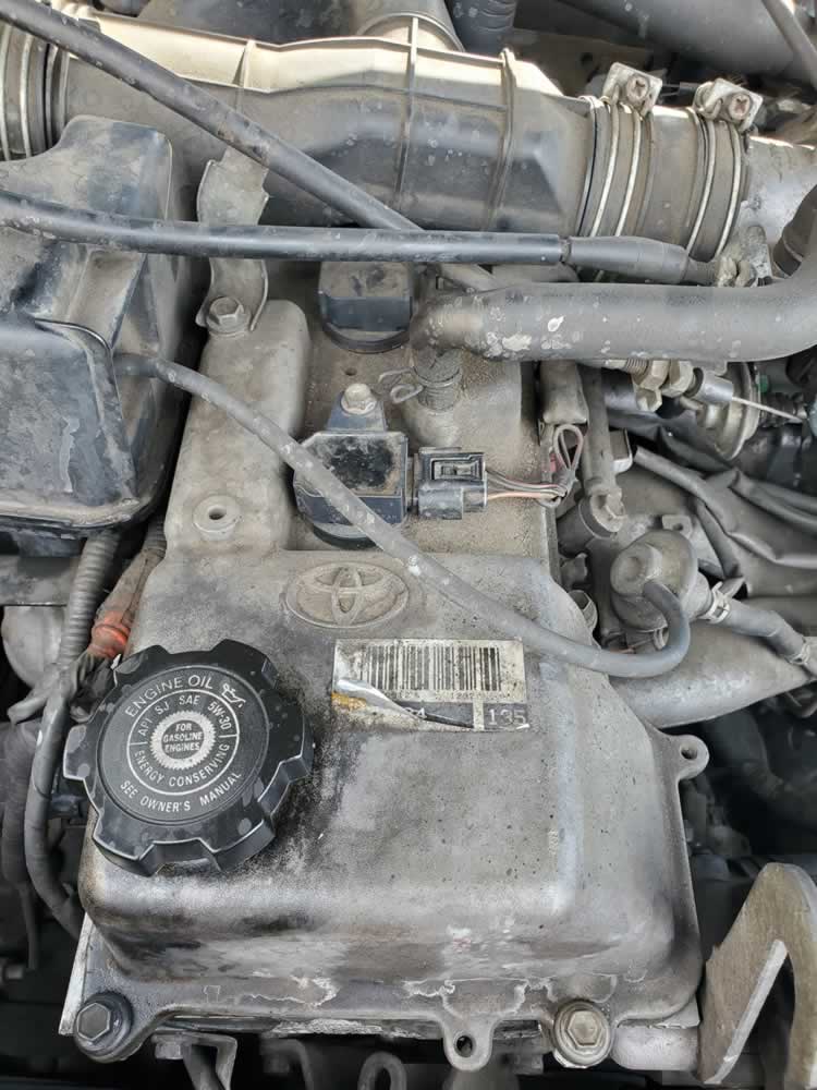

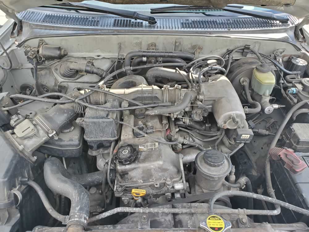

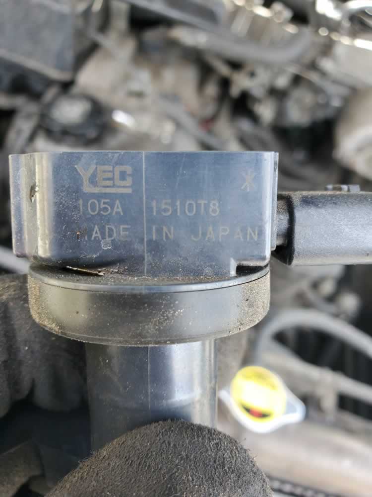

2000 T4R 2.7L - Ignition coil issue?
2000 T4R 2.7L Base. 215k Miles
New to the club, just bought my T4R this past weekend and drove great for 2 days, until the original radiator started leaking at the top plastic piece and now I have a P0304 code. Running horrible, shaking etc.
According to the VIN, I should have spark plug wires, but I see 4 direct ignition coils on the plugs. Anyone seen this before on the 3RZ engine?
The tag on the engine says X3RZ-W84 but the tag under the hood says 3RZ-FE RZN.
Sorry to hijack this thread, i'm trying to look for parts on this engine but according to the VIN, this shouldn't use direct coil on plugs. For my own sake, i'm gonna replace all plugs and coils but I cannot find parts cause of this mixup?
Owners swear they never swapped engines in the 12 years they owned it, but after reading a few posts here, seems this might be a Federal Emissions engine? The build date is 12/99. Could this account for the coils vs plug wires? I removed 1 coil, but cannot find this part or cross reference anywhere.
I attached pics, engine is filthy... todo item.
I tried to create a new post, but i'm new so it wont let me.
Thanks everyone!

You have a 2000 model year even though the build date says 99 (takes a while to ship it to a dealer in the US and then sell it). You do have a coil on plug design, the distributor based ignition systems were gone several years before.
To help diagnose your P0304 code, swap the coil pack with the one next to it. if the code moves and become a P0303, it's the coil pack. If it doesn't, replace the spark plugs (cheapest item on the list). If that doesn't solve it, look into cleaning or replacing the offending fuel injector. Those coil packs may not be the OEM part from 2000 but that doesn't mean they don't work. I believe the OEM unit for the 4 cylinders are DENSO coil packs but don't know for sure 100% since I don't own one.
Sure enough... Swapped coils from 4 to 1, got P0301. Had to go to dealer to help find my part# since this VIN comes back using plug wires, not coils. After a bit of digging, they helped me conclude that a coil from a 2004 Tacoma 2.7L will work, so looks like that's my engine.
