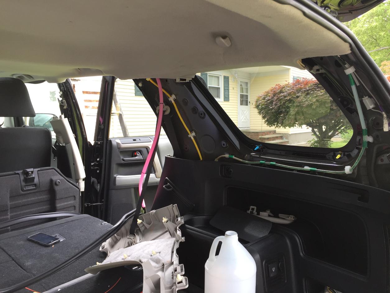

On my way back from a road trip I noticed water dripping down from the rear seatbelt slots and a slightly wet headliner (where the C-Pillar meets the headliner). I inspected a little further and found the entire carpet was also wet! I decided to take apart some of the interior pieces to find out what was leaking. As it turns out the REAR sunroof drain tubes were completely disconnected.. I was only able to verify this by closing the sunroof completely then pouring water on the roof. While I was there I checked the front drains of which the driver side needed a little cleaning.
I managed to reconnect the rear tubes and clamped them down to prevent them from sliding off in the future.
I tried finding my specific issue online but only found other generation 4Runners with some-what similar issues. I hope this helps anyone with this problem!

It's a 2011. The drain that was disconnected were the rear ones that run down the C-pillar and across down to the back corners of the vehicle
