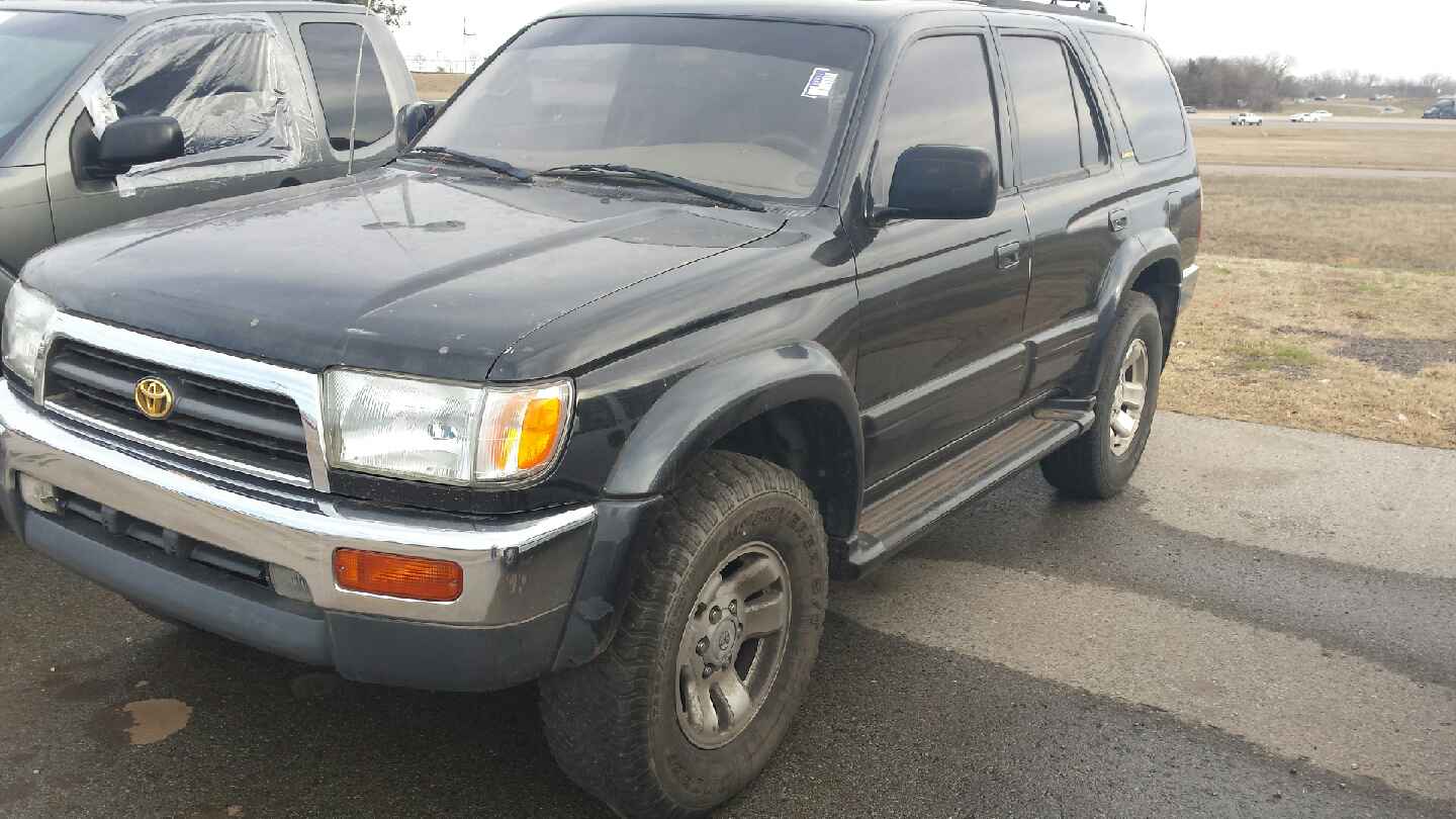

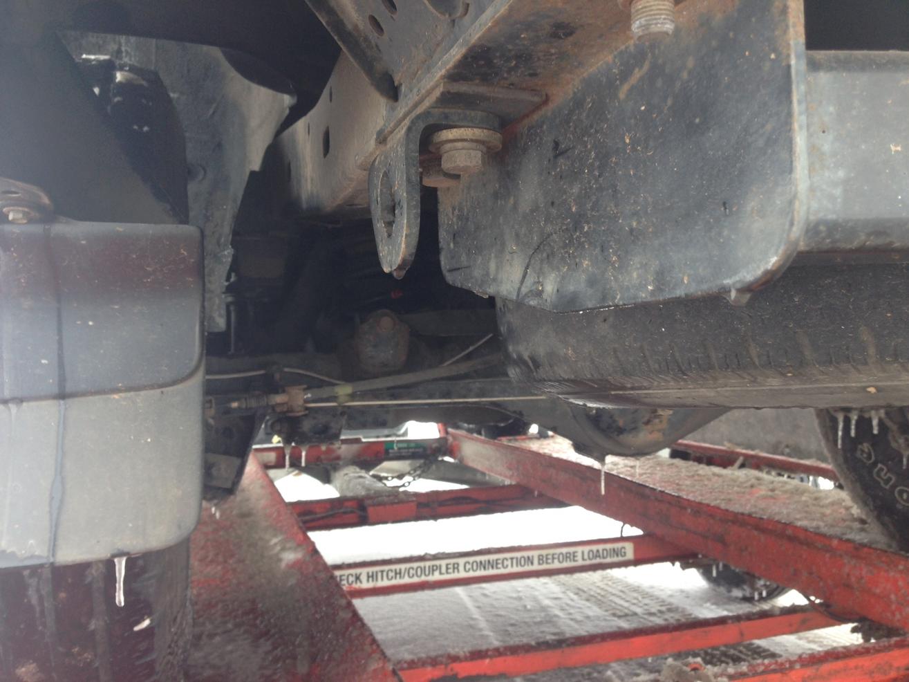

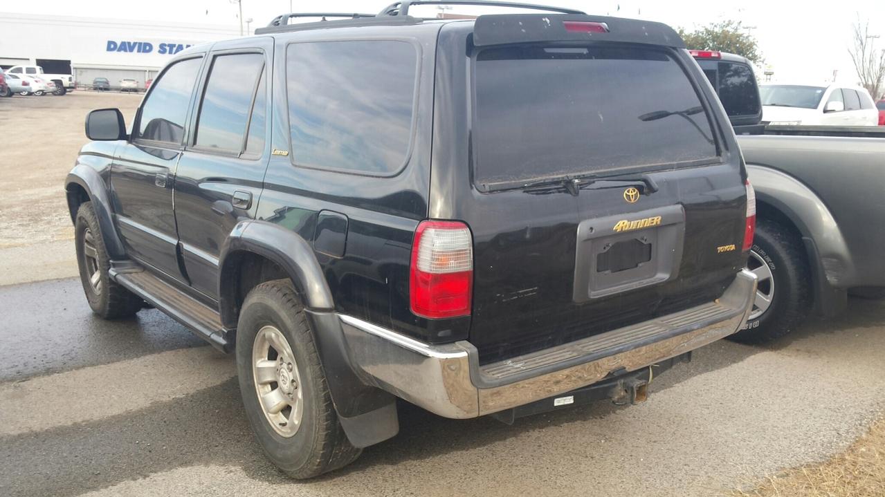

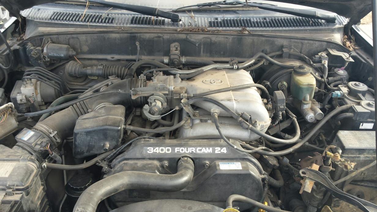

I've always wanted a 3rd gen 4runner but was never able to find one that had a good enough frame. I couldn't sleep one night and managed to come across one in Oklahoma (no salt state) at a Chevy dealer for 2k. They said it didn't run well, a few min later guy called me back and said it didn't start up and they wanted it gone, sold to me for $900. Has a clean carfax, 3 owners, and 340k miles and a super clean frame and all original body panels with vin stickers in place. Newer tranny, alternator, and suspension components. Went to go pick it up and was able to get it to fire right up and it has a noise that is coming from the head that goes in and out, so that was good news. The bad news is that the interior is disgusting and will be gutted promptly! All in all I think I got a great deal on a project 4runner. I did pick up an engine from a 98 that I was able to start up and hear before it was pulled for $700 with 159k miles. Anyways, onto the pics!

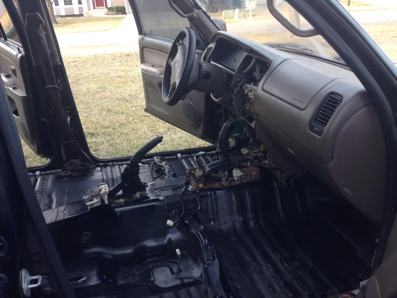

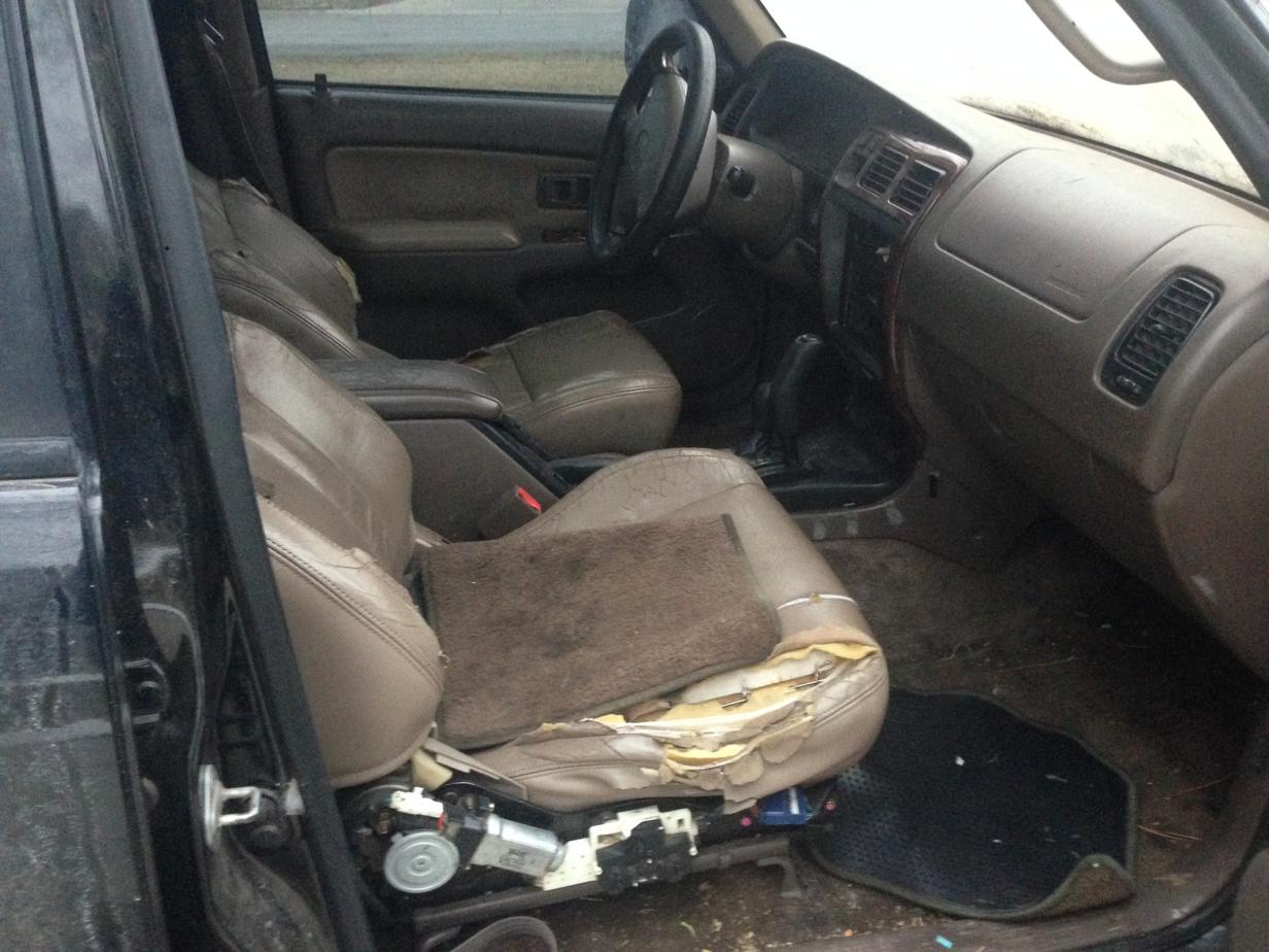

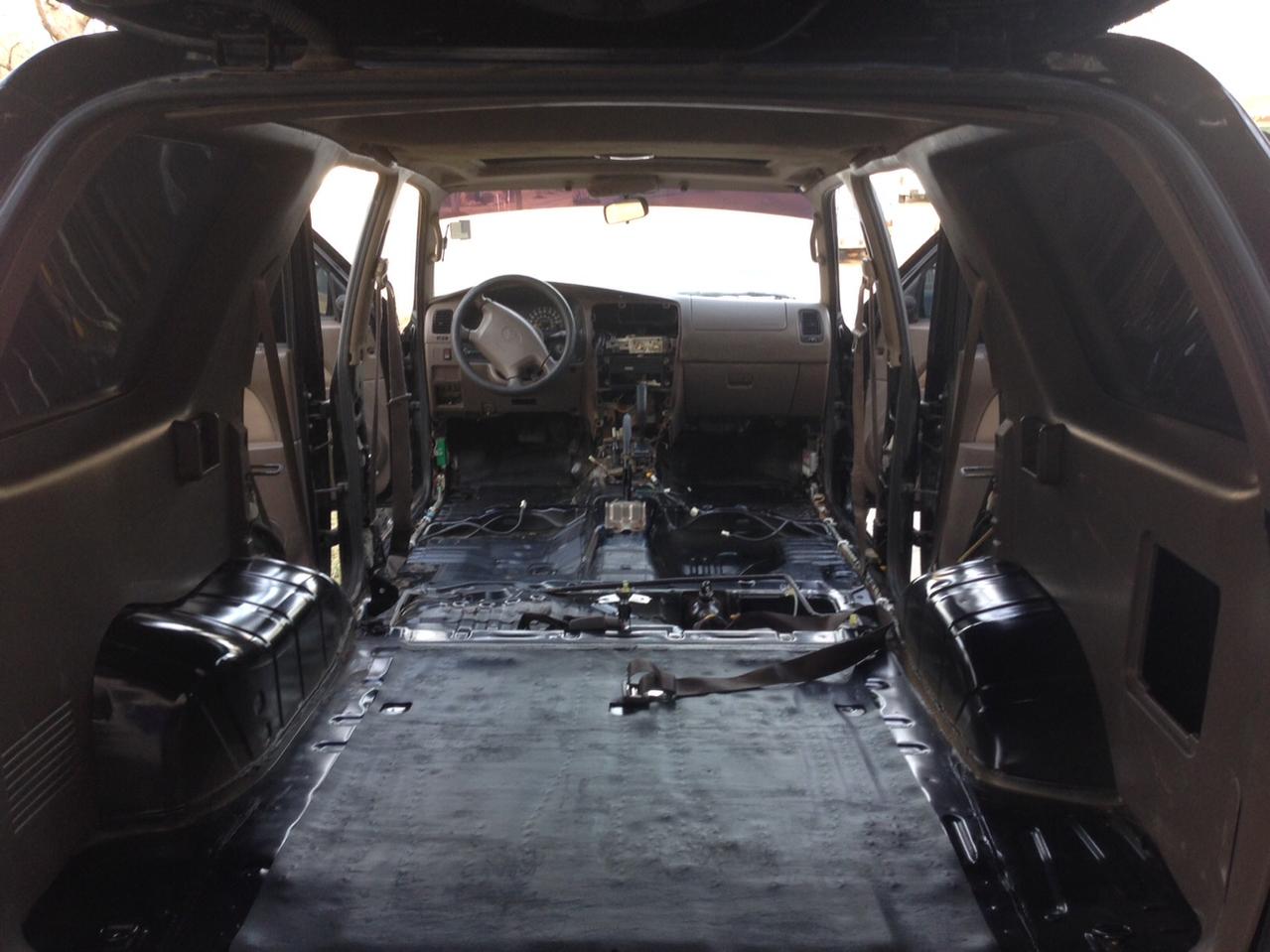

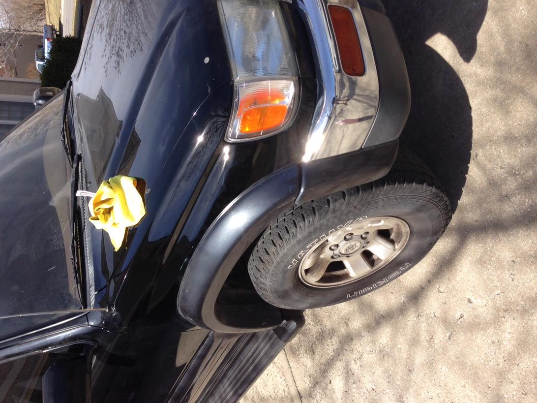

Just a quick update. So I tore into it a bit more and it turns out the motor is actually fine, it just has some valve noise that seems to be common. The dealership said it didn't start and of course it had no battery and was out of gas, so I filled it up and threw a battery in there and it fired right up and idled perfectly and had no CEL's. I then tried to put it in drive to move it, it just revved up, so I thought the tranny was done. It was just very very low on fluid, so did a drain and replaced the filter and didn't find any metal or burnt fluid beyond normal wear and tear, filled it back up and changed out all the other fluids and it appears that it should last at last another 50-100k miles. Decided to gut the interior and got a better condition used set of seats, beige katzkin seats covers off ebay for a steal, new carpet, new steering wheel and some misc interior trim pieces that were looking rough. Should look great on the inside and should clean up nicely on the outside. Also got a set of 5 spoke wheels locally with tires for 100 bucks!
