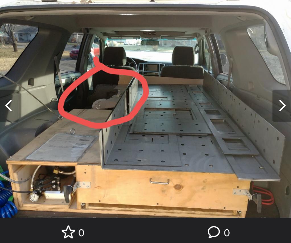

Like many others I've read and "followed" your build since I've been a member...20 days. Even in that short time I've come to appreciate your dedication and hard work you've put into this car, so thanks, from all of us. With the tire, I noticed in your picture with the bed configuration you may have some room for the tire if you take out the drivers side back seat...could you fit it there behind your seat?

Forgot to add this, sorry for the double post but that lets you keep your drawer/bed system so you can still use it that one time per year. I think you can fit it inside. Personally if I tried to go inside with it I would try and have the tire vertical and not flat. Unless you removed all rear seats and built a full drawer system with tire underneath. Drawers pulling out from the side doors with maybe a table and fridge and a long one from the rear potentially all while maintaining that luxurious bed. Just a thought, from a dude, ordering runner parts.
I've got a fridge I put behind the driver's seat when on vacation, and due to the 60/40 split seat design it's best to place there because my sleeping platform has to be on the right side. I tried standing the tire vertically and a 35" tire hits the headliner, the 37" tires I ordered today would be way too tall. BTW tubbing the firewall to fit these will be fun.
