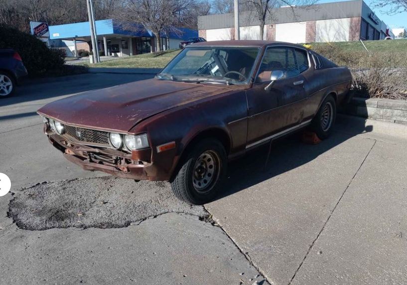

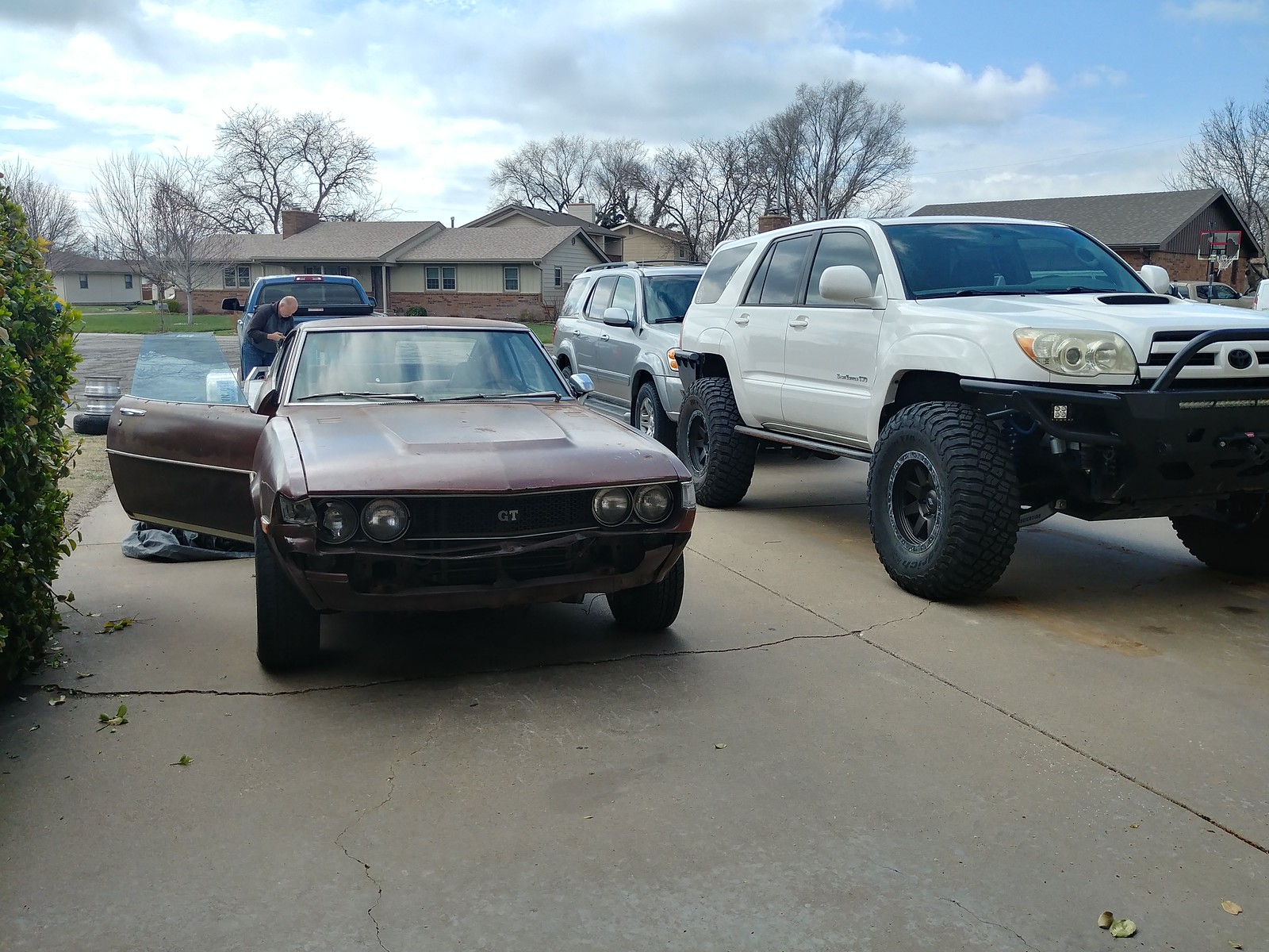

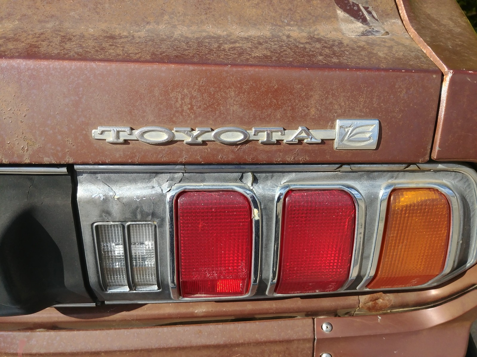

After looking for years I finally found my Celica. 1977 Liftback Celica GT, they only made the liftback for two years in the US and its commonly referred to as the Japanese Mustang.

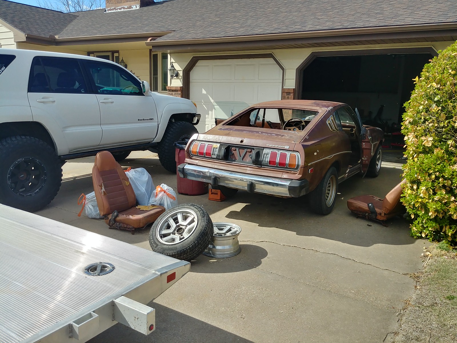

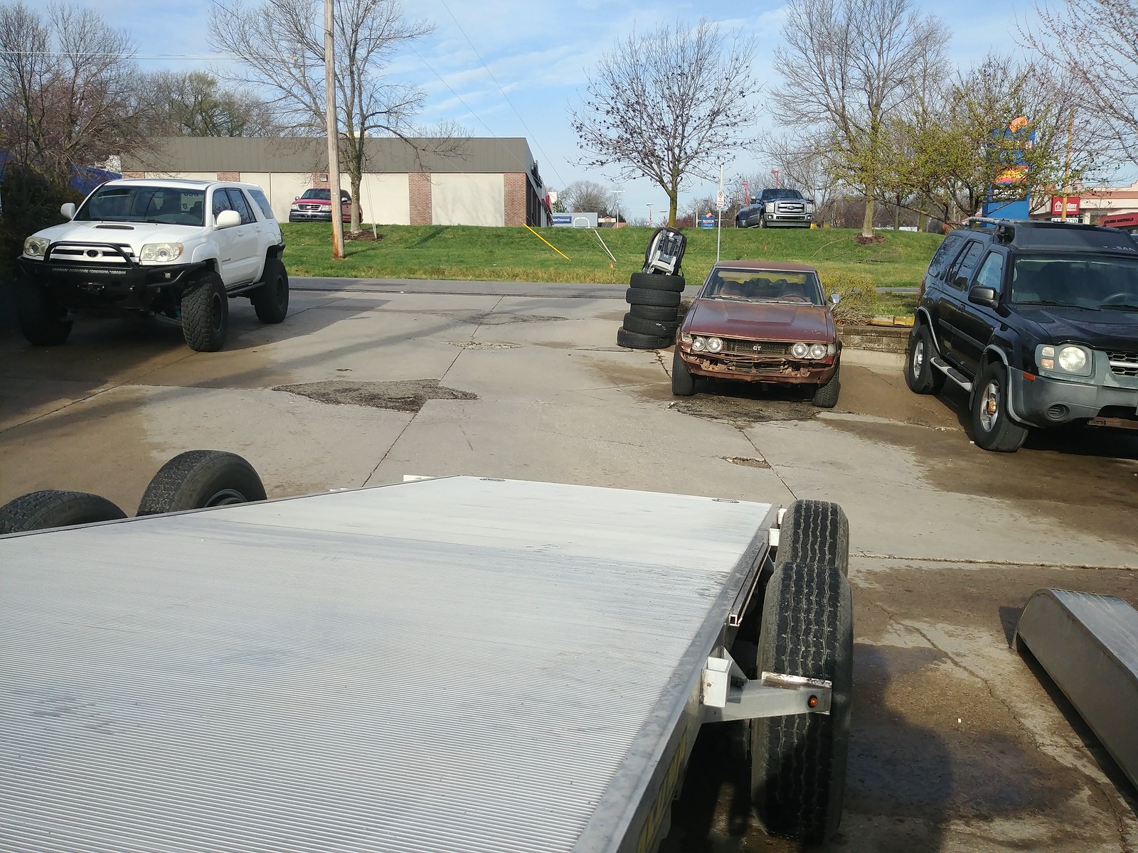

Bought and trailered her home today and promptly started working on her. We didn't even get it unloaded in our driveway before the neighborhood kids congregated around it to ask questions, seeing if it was a Mustang. I don't think they were as interested when we said it was a Toyota. Even two of the neighbors I've never talked to came over immediately to ask about it.

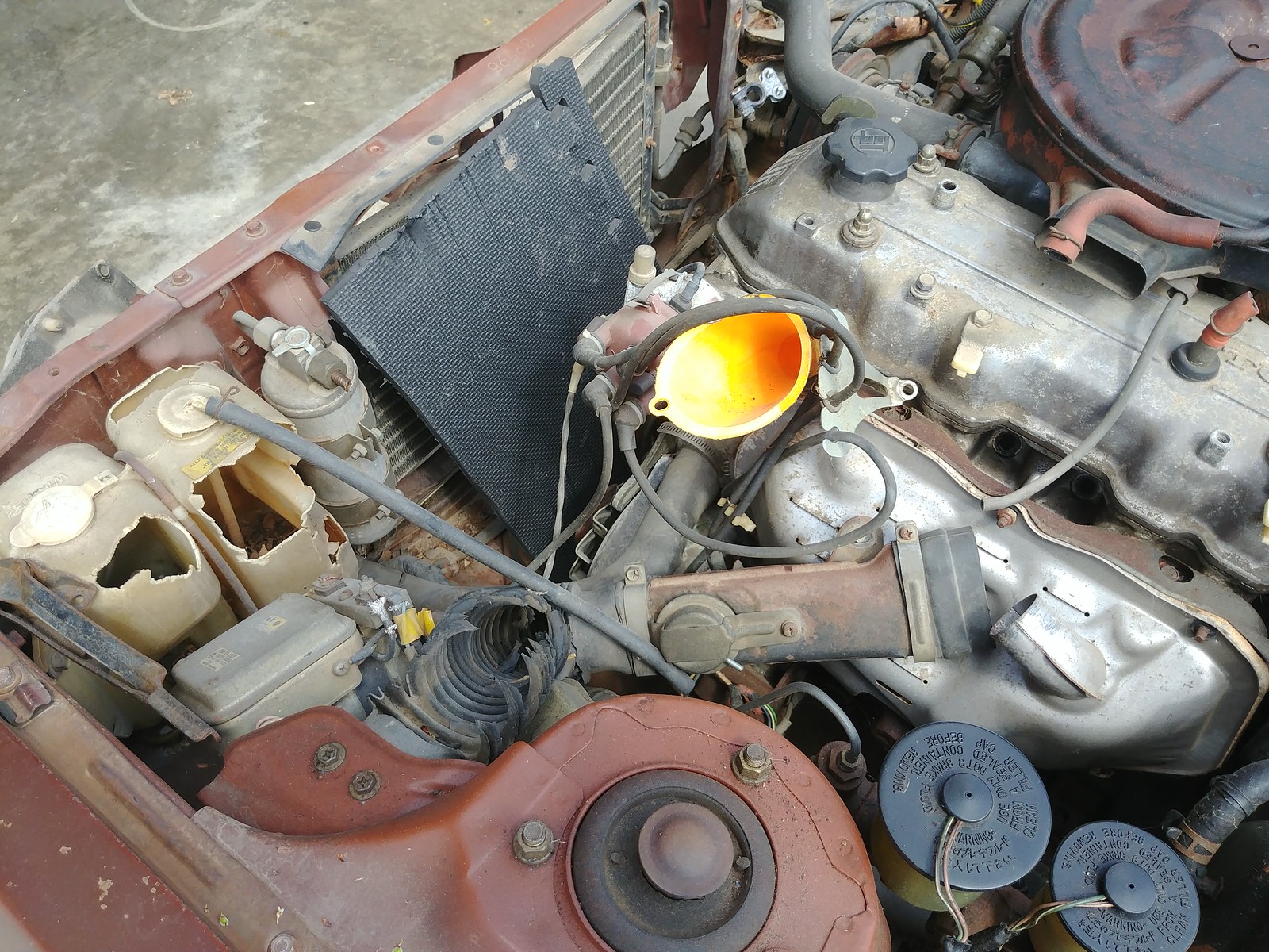

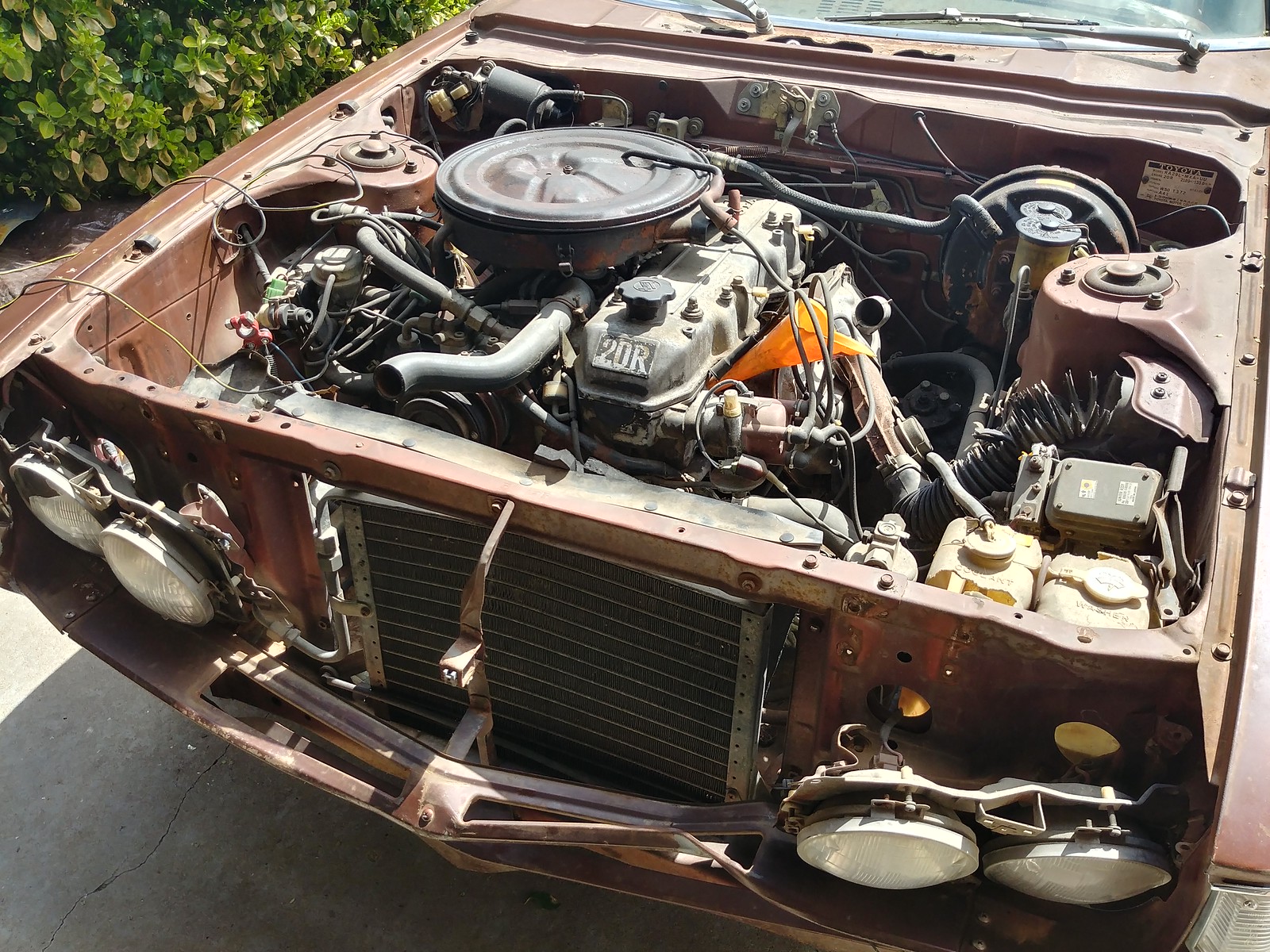

First order of business, get the hood open as the latch wouldn't release it's grip. I disassembled most of the grill to remove the hinges, then I was able to snake a long section of rebar to nudge the latch near the windshield.
Looks like someone was trying to free up the engine by putting gas or diesel directly into the cylinder through the spark plug holes.

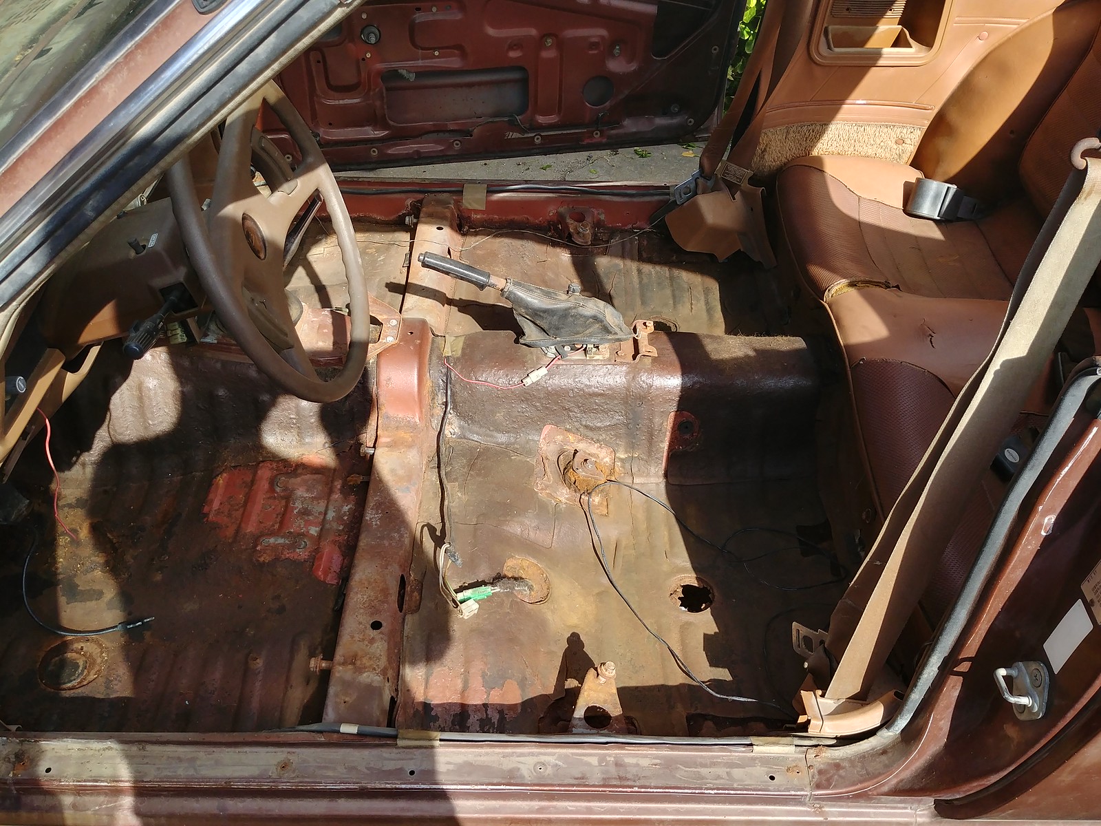

Got one seat tore out:
Not bad as far as rust goes:
That stupid bulky U.S. rear bumper has to go, as soon as I figure out how to remove it. Also the owner gave me those retro Celica wheels that are O.E. on the 2nd gen Celicas. Super cool design.

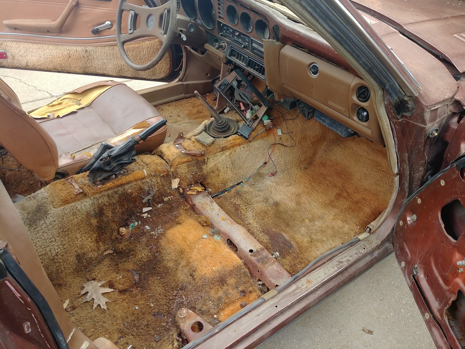

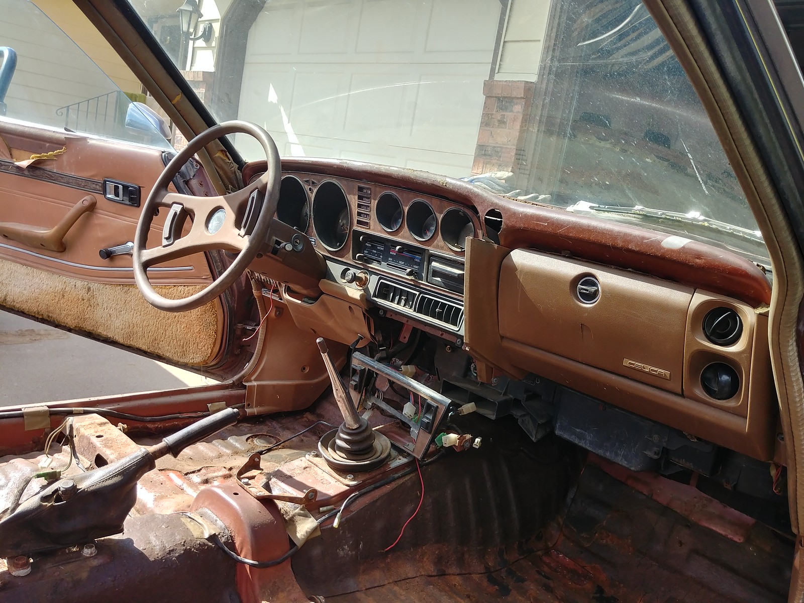

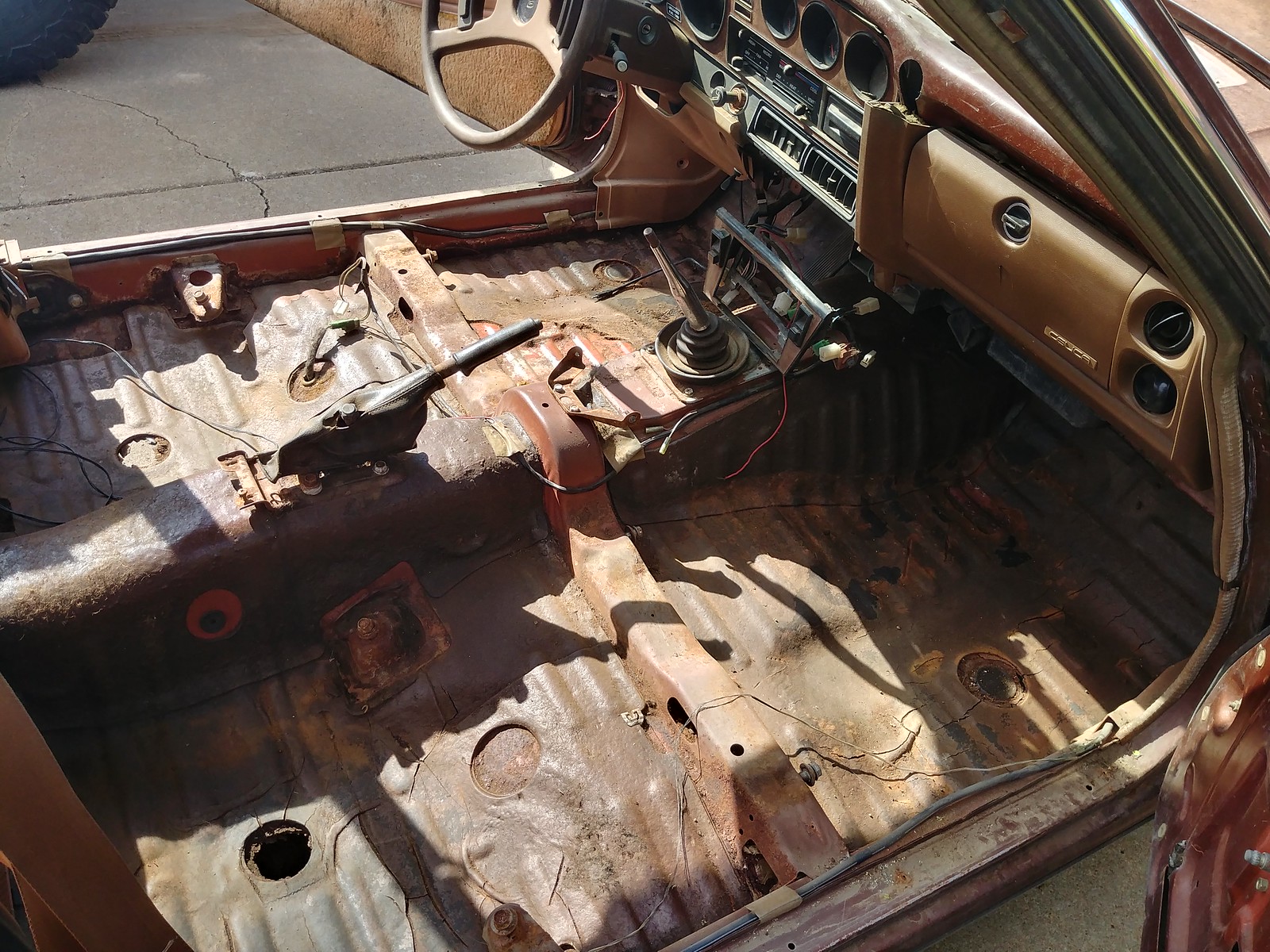

Gross carpet removed:

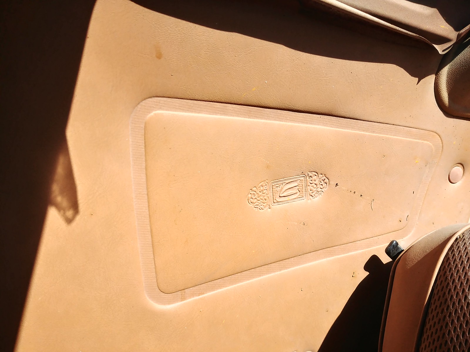

Retro dragon logo:

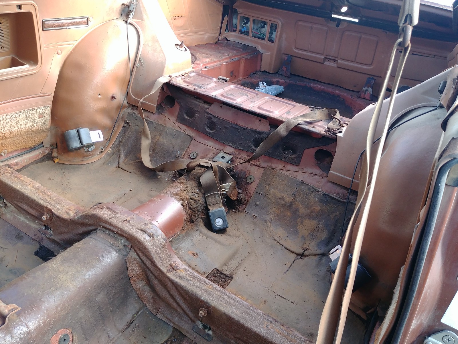

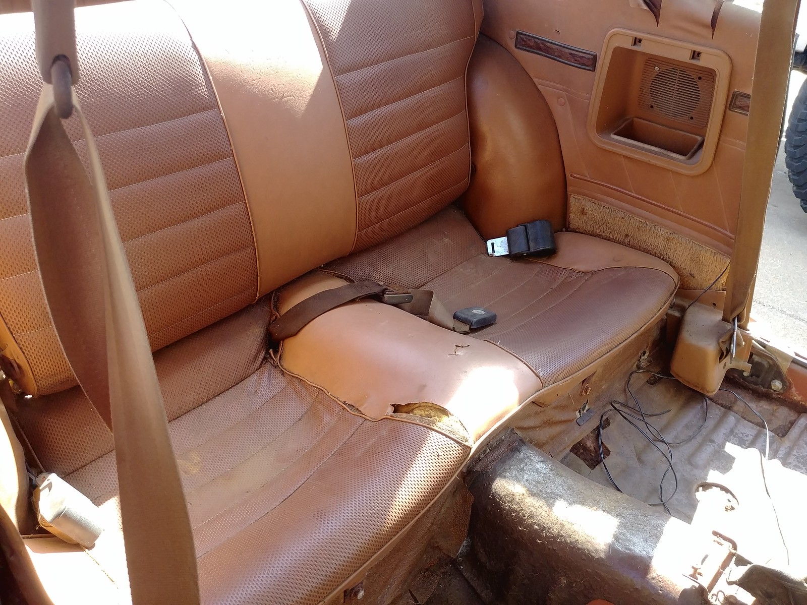

Rear seat looks okay from the topside but seeing underneath makes me want to trash it. Might keep it so someone can reference it to make a new one.
All the gross stuff is removed (mostly):
Next order of business, remove the rear bumper to make room for mounting a JDM 'smiley' bumper, and try to remove the sound deadening material from the entire floor. Its probably best to get it down to sheet metal so I can patch and paint any rust, weld in a roll cage easier if needed, and I can add deadening material afterward. Also, remove the motor and trans, and take a picture of it next to a 2020 Supra... My brother and I still live together, sickest driveway ever? We need to line them all up for a picture.

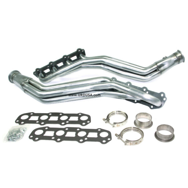

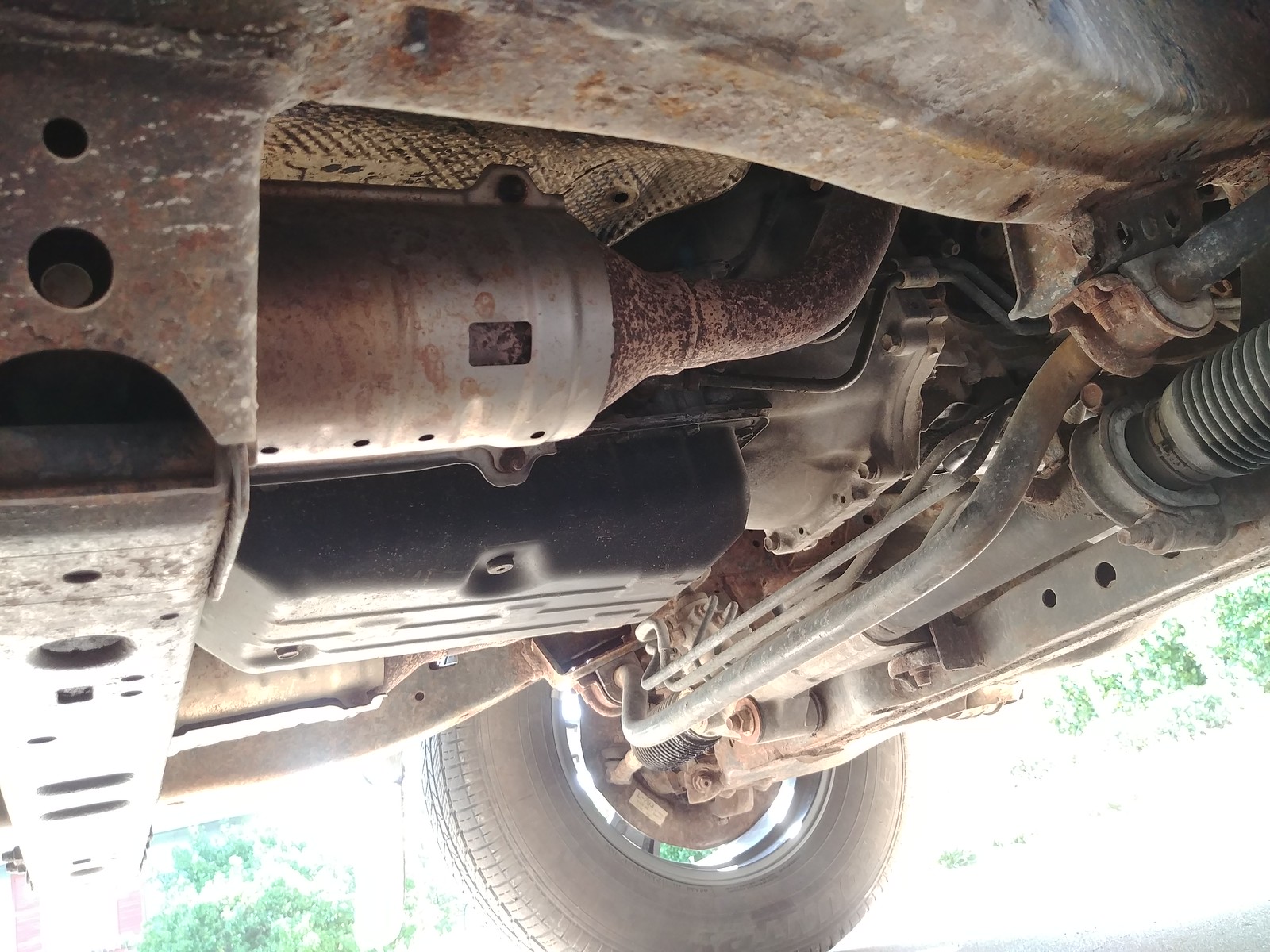

The past couple weeks I've had the urge to build a set of headers for the Tundra. I'm thinking a set of 180 degree headers, which if your not familiar, on a typical V8, 180 degree headers cross over two primaries from each side to merge at the opposite side collector so the exhaust pulses are even spaced for each collector. The firing order of a V8 is weird in that part of the firing sequence comes from the same side of the engine twice in a row. By doing this crossover, the exhaust is a little more efficient at scavenging, but more importantly to me it just sounds cooler. I would need to find the dimensions of the flanges (measure OEM manifolds from the 4Runner), and design them to block off the air injection ports, and potentially lift the motor quite a bit out to test fit everything.... or tack as much as I can together on the bench with rough measurements and use some trial and error.
The exhaust on my 4Runner without cats and only 'glasspacks' sounds so nasty, raspy above half throttle, and smells pretty unsafe :naughty:. I would like my Tundra to be quieter so I might be adding back in some cats and longer glasspacks or a more conventional muffler. Anything will sound more refined than the muffler delete its rocking currently.
The collectors would have to be below the transmission pan for the 180 degree setup. Fairly long primary lengths but maybe I can decrease the tubing diameter 1.5" vs normal 1.625" to speed up the exhaust a little.
Something like this:
Or the easy way lol. These are fairly inexpensive compared to the 4Runner's headers:
