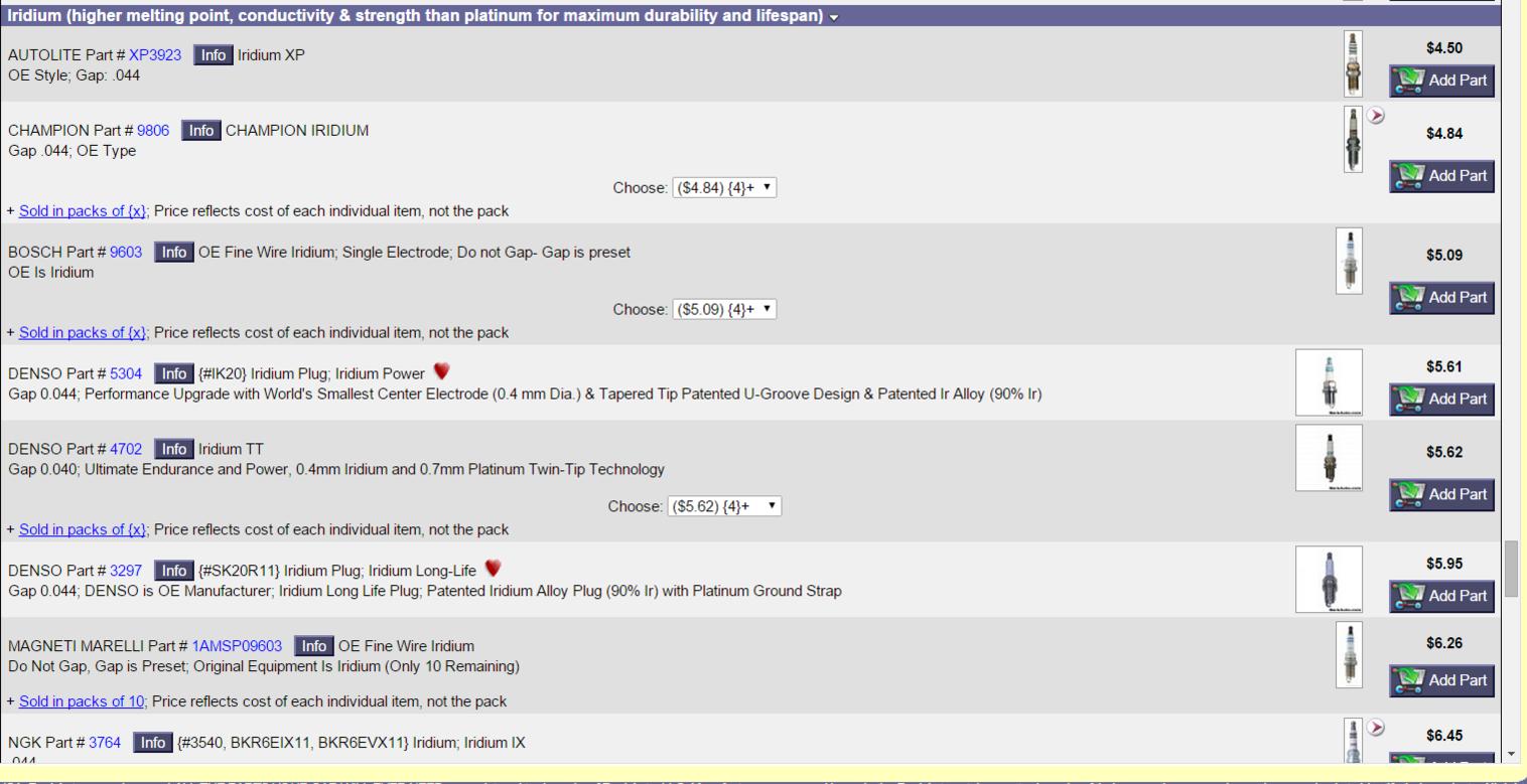

RockAuto is where I do most of my parts shopping unless I need it immediately. Here is a screenshot of the Iridium options. Looks like just over $5 for Denso plugs.

I'm looking for Denso plugs for my 2003 v8 and the Owner's manual doesn't say which p/n to get, it just says not to adjust the gap on Iridium plugs.
I see 3 different part numbers for the Denso Iridium's on Rockauto's website, 5304 (Gap .044), 4702 (Gap .040) and 3297 (Gap .044). Which ones should I get?
Also, do you use anti-seize on your plugs? thanks

Denso part # 3297 is what you want and yes, always use a little antiseize on the threads. A little goes a long way so don't over do it.

I just picked up the NGK 3297's (SK20R11) for $5.94 ea from RockAuto, thanks for all the info guys! :cheers:
