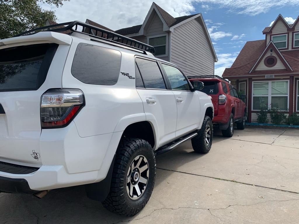

Looks you have quite a rear sag... What rear springs do you have?
It does look that way in the photo not sure why, I have the medium springs front and rear. Without the trailer it has a slight rake to it but levels out with the trailer.

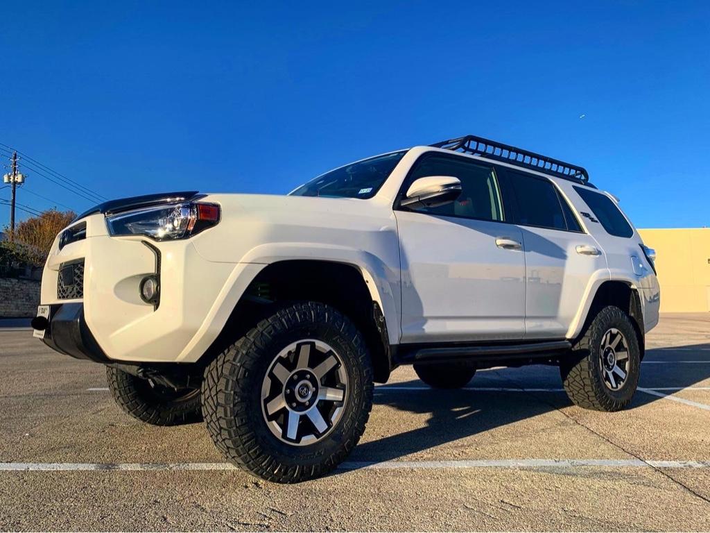

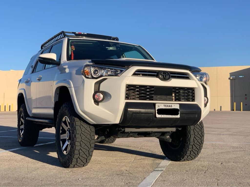

Here’s the lift with my new tires. Went with 285/70r17 ridge grapplers. Stock wheels no spacers. FCP stage 2 with performance load all around. 3 in. in the front 2in. for the rear. Seems I have a little negative rake so I might need to adjust the front down a bit.

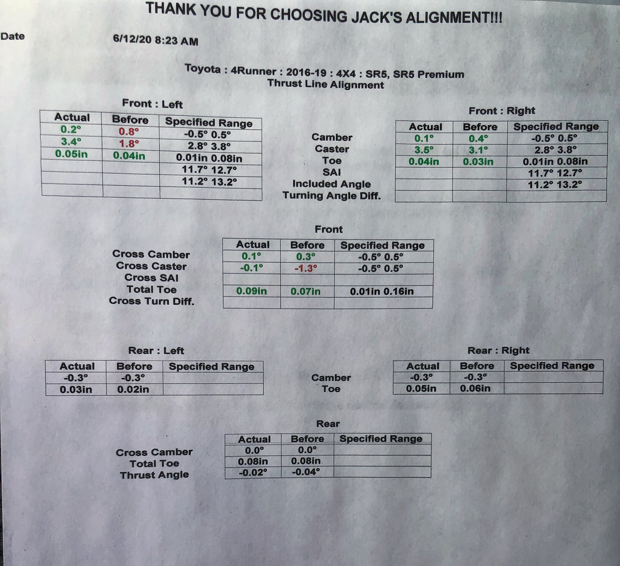

Did yours settle at all? Mine went from 23.5" to 22.5" after a week or so. My rear hardly settled at all. Here are my numbers, the tech said it aligned great!
Untitled by redrunner87, on Flickr
