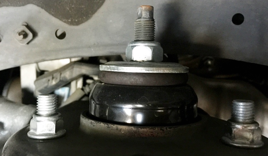

Anyone else’s strut mounts and bushings go bad on this lift? I’ve had the FCP stage 2 on my 5th Gen for only 800 miles and started getting a squeeking/thumping sound with normal city driving. I purchased it prebuilt, and the shop i had it installed at told me it’s the strut mount and/or bushings as the bushings seem to be cracking.
I had mine installed about 2 months ago and have a bit over 1,000 miles on them. My top bushing isn't cracked and not as squished (it isn't bulging out the sides like yours). It also looks like the torque stripe isn't lined up... mine doesn't have any torque stripe... ya got something funky going on. The small cracks in the rubber I wouldn't be worried about by themselves, but the over compression isn't good for durability or noise/vibration/harshness.
I could be wrong but that looks over tightened. If I can recall, the general advice is to tighten it till the bushing is squished and about the same size as the washer above it.

Would you guys mind posting what your strut mount/bushings look like?
I’ve contacted Ironman and they’re sending me new bushings/hardware this week. Anything else I should’ve asked for? I tried having them send me a whole new strut mount, but they wouldn’t go for it. I’m just trying to get this annoying squeeking/clunking sound resolved.

Attached
