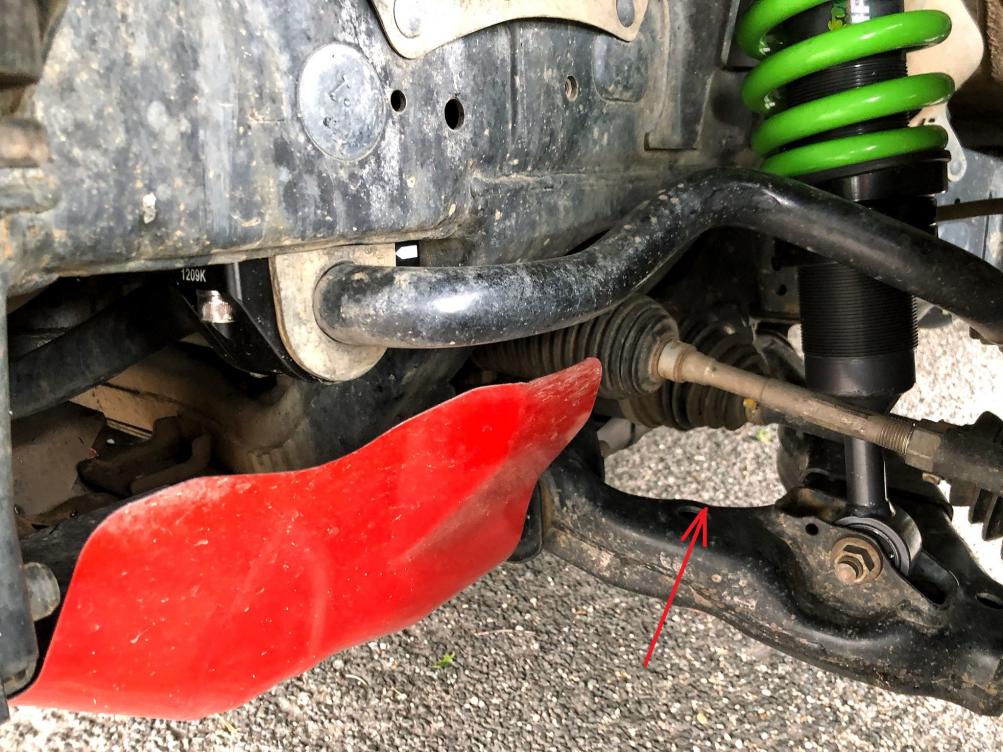

For those of you that have been running the Foam Cell Pro's anybody install them on Non-KDSS with aftermarket skid plates? I noticed on their site that a swaybar relocation kit is required, I was messaging with someone on the ironman site (the phone always goes to VM) and they mentioned that for Non-KDSS its a replacement bracket (only moves it forward not down) vs. the KDSS version which is a plate that is sandwiched between the existing bracket and frame. Can someone please confirm that this is the case?
If so, do you know far forward it is moves the swaybar? My concern is that the swaybar will make contact with the skid and I dont think i can add spacer to mine (Artec Belly Pan).

Do you want me to take a picture of the sway bar and factory skid plate? You can get an idea of how it sits.
THANK YOU!!! This is so helpful and greatly appreciated! It looks like it may just work, fingers crossed. Now hopefully they still have stock left.

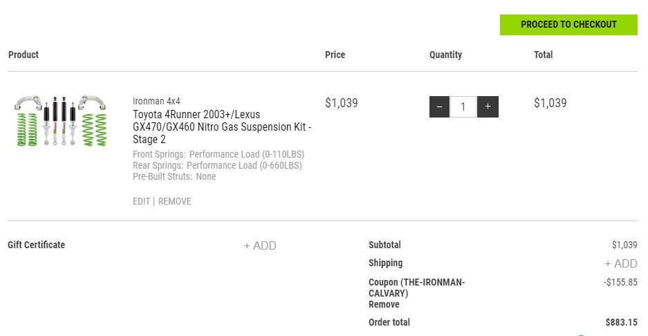

With their 20% off and free shipping, plus another 15% on top of that I ended up getting their Stage 2 for $1360 shipped. Not a bad deal with UCA's. Unfortunately they are backordered till at least May 4th.
If an extra 15% off will push you over the edge, I have a coupon code for you.
