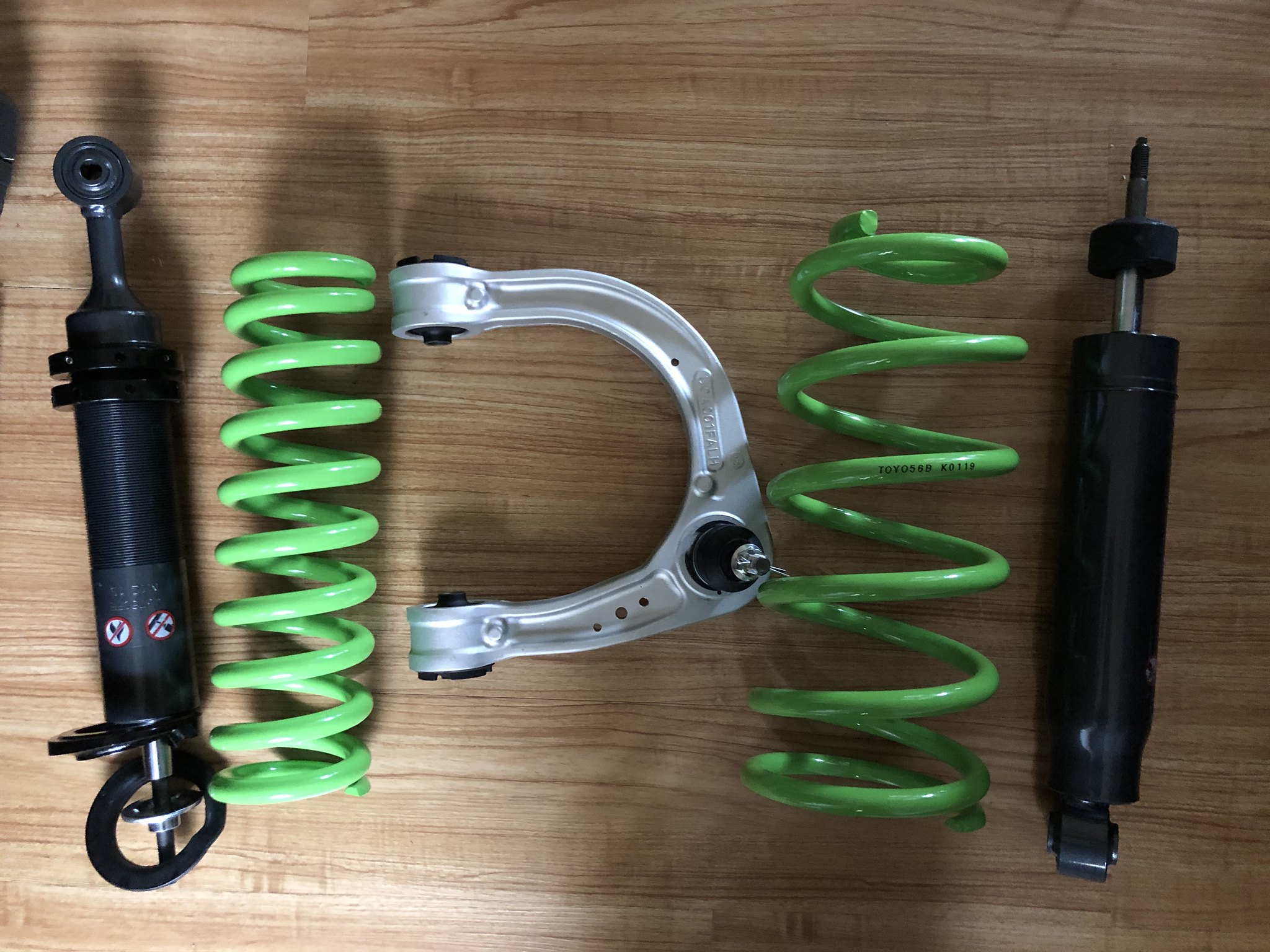

those shocks aren't extended? are they held compressed? :wtf:
They are 'foam cell' shocks, not 'gas pressurized' shocks. The foam cell (a closed cell rubber with trapped gas in the closed cells) acts as an accumulator (spring), and traps the gas within the foam such that it cannot go into the oil solution and create foaming/aeration/cavitation. Pressure is built up in the shocks with heat, but this compress the rubber foam cell. Since they don't have a nominal gas pressure, they don't extend on the bench.
This is how they came in the box, I am not concerned about them. Many people I have talked to running the kit swear by it. It is obvious you don't like the concept of these shocks, which is fine. I bet you keep posting here, but have yet to email them any questions you have. Kind of funny you keep stopping by here to side comments on a suspension you will never run.

The gas in every shock is necessary to accommodate the change in internal volume that results from the shock shaft. The internal volume of of the fluid reservoir is reduced by the volume of the shock shaft as it compresses. Without a gas chamber all shocks would basically act as a fixed length linkage and would not move at all, or they would rupture.
The goal then is to use a the gas to allow for volume changes while not mixing with the oil. Gas and oil foam doesn't create the same resistance to flow through the valves and the dampening goes out the window. So there's a few different ways to keep the gas and oil separate. One way is to use a floating piston in between the gas and oil (how it's done in monotubes - either inside the main body as an "IFP" or in a reservoir - same thing, different location. The only real function of the reservoir is to provide more volume of gas for less change in internal pressure through the stroke of the piston) and the other most way to separate the gas and oil is a rubber bladder or bag of gas (how it's done in most twin tube shocks).
The foam cell is basically the same thing as a bag of gas - just a lot of little bags of gas. It provides the same function as a floating piston and air chamber or the rubber bladder. The unknown is how long the foam lasts, how many cycles it can handle before breaking down, etc.
The reason you pressurize a monotube gas chamber is because you need to maintain positive gas pressure through the entire stroke of the shock. Even at full extension you want plenty of gas pressure inside to make sure that the floating piston is being pushed against the oil on the back side. That keeps the oil on the oil side where you want it. The seals are not designed to handle a scenario where there is a vacuum created on the air chamber side - gas will be pulled through the seals to the oil side. The pressure also helps to keep the oil from foaming or boiling at higher temps - but that's pretty rare if not impossible in a 4Runner. All oils will have some suspended gasses in them that would tend to off-gas at higher temps. More pressure helps prevent that off-gassing, but it's a pretty minor issue in a 4Runner and generally not a big issue in most applications anyway. There's basically no way you can push one hard enough to overheat most shocks. The self contained air bladders in typical twin tube shocks don't have that same issue. Nor does it appear the foam cells do. They can expand and contract without as much initial gas pressure required.
If the foam lasts a long time and doesn't break down or rupture the cells, it should be a fine way of making a shock. And it could be used just as easily in monotube by using a block of foam instead of the gas and piston design. The most obvious downside I see is that the foam probably has some limits on expansion and contraction volume. So the shock shaft will be limited in diameter as a result. That's why they use a pretty small piston shaft. An IFP design can accommodate a much larger piston shaft's volume displacement. That's why you'll see much larger heavier shaft and pistons in a race type shock. - Does that matter in a 4Runner that has 8 or 9" of suspension travel? Probably not at all. I've never seen a broken shaft that wasn't the result of a spacer lift causing a bottom out.

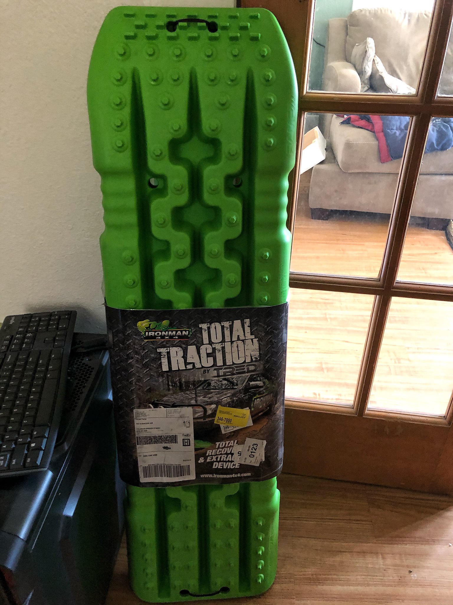

I feel like I got a good deal with everything included. Which leads into this, finally received the Tred Traction Boards from Ironman today. Just in time for my trip.
Untitled by redrunner87, on Flickr
