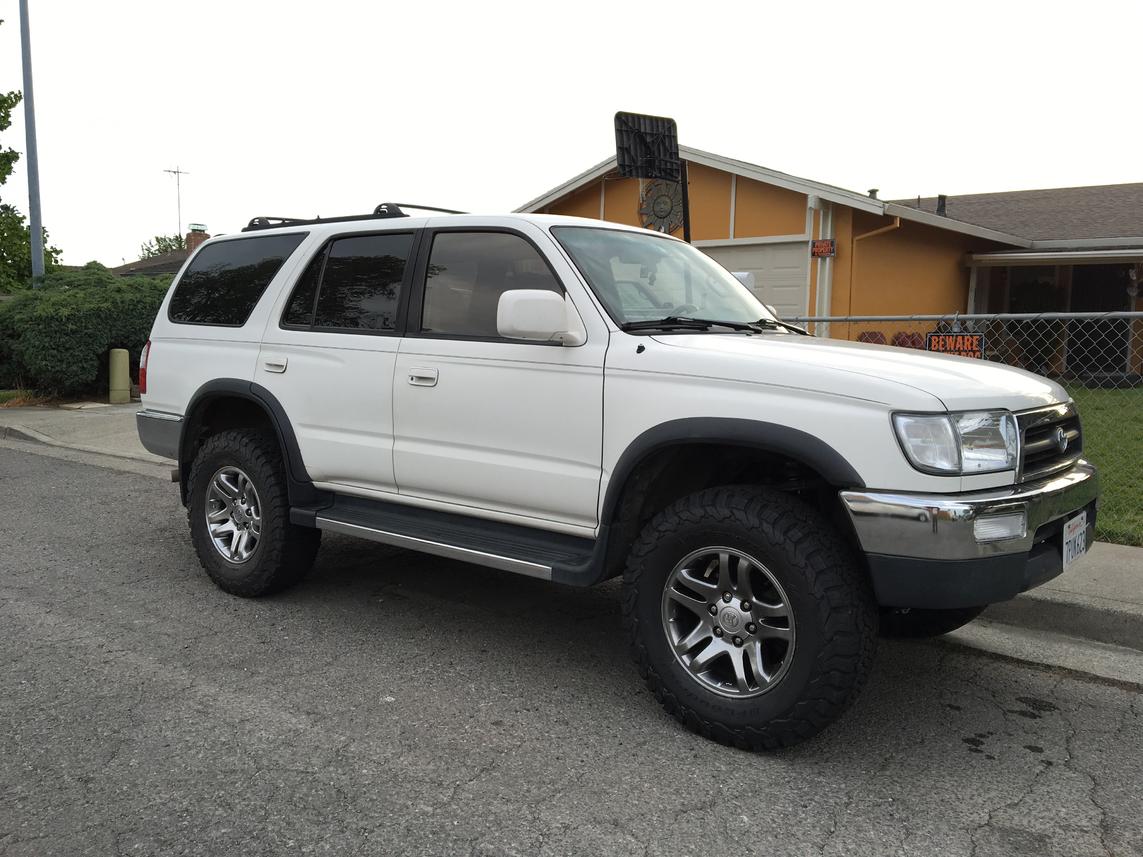

As of today 05-11-16 this is how it sits

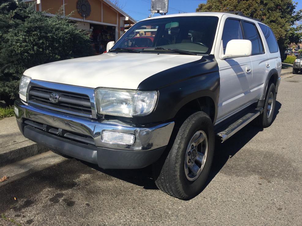

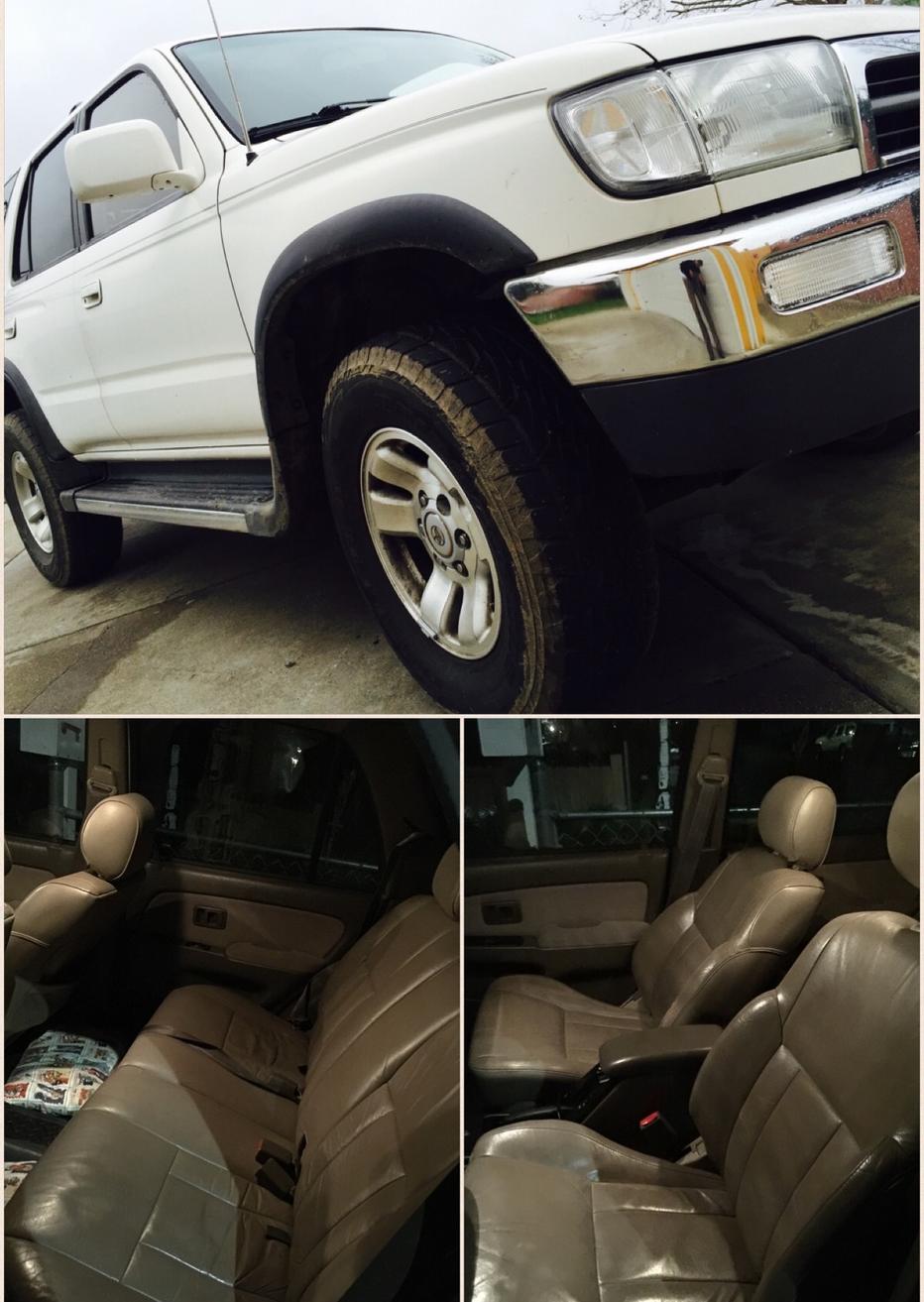

Week one, I got the truck registered and found a killer deal in Palo Alto for some leather seats...
It originally was sitting for a long time so when I went to smog it the tech told me that because it was sitting for so long (1 month) the computer wasn't registering correctly... I got a 30 day permit to drive without a smog and then when I took it back it passed with flying colors.
Here's some pics of what it looked like stock when I got it and after the leather seats

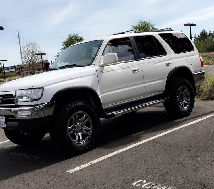

I ordered a set of tires from the discount tire direct eBay store. I ended up getting some BFG's TA KO2 size 275/70/17. I got no rub unless I turn the whee all the way to the very end. Other then that I'm pretty pumped on how it looks. I'm still in debate if I should get spacera for it
And yes the fender was painted... It's white but not the Toyota white. More like primered. I ended up buying the Toyota white color, but because of the crappy weather I haven't had the time to paint it right lately.
