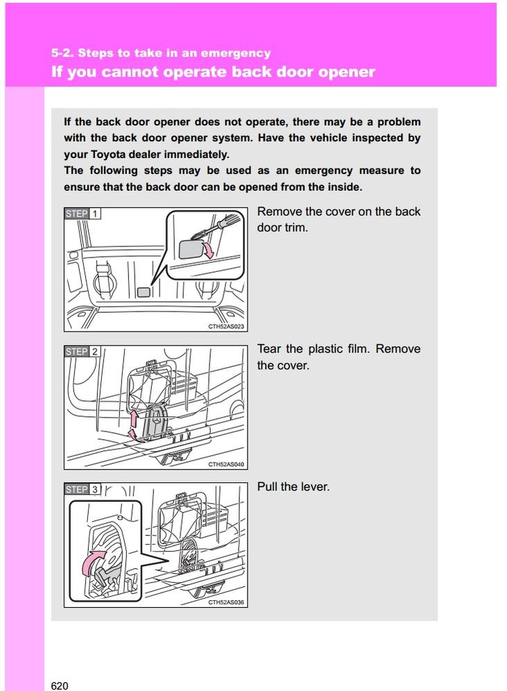

To answer your question, you need to remove this small panel in the inner panel of the tailgate, then cut open the plastic liner and reach in to pull the lever in order to manually release the hatch from the inside. It's going to be a pain to do especially with a storage drawer in the way. Go check out the manual, it describes how to open the hatch manually in the event of the button failing.
Since we're all allergic to reading the manual, here you go :)
Also keep in mind that when you have a drawer system that is all the way out to the tailgate, you will not be able to access the access-panel in case of emergency, because it will likely below the top deck of your drawers.

Thanks for posting the manual. That is just what I wanted to see.
On my 2014 limited, once the vehicle is locked and the "smart key" is taken out of range, the unlock button in the vehicle stops functioning. (This is what gave me the idea of using the rear hatch to secure a drawer.)
So it looks like if the drawer is high enough to block access to the rear door panel, a thief would have a hard time getting into the drawer from inside the vehicle. How about jimmying the rear hatch from outside? Is this as easy?

Oh very nice! I unfortunately don't have the smart key 4runner to test it out myself. So I guess your answer is clear, all you would need to worry about is someone accessing that internal lever I pointed out above from the manual. Short of accessing it from the inside, there's really not much room to work with from the outside unless they really destroy your exterior trim. So I guess if you fashioned your rear drawers to block the access port you'd be in pretty good shape :)
