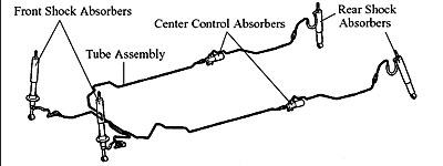

XREAS is a closed-circuit system; thus, you cannot replace just one shock. You also need to replace the other shock that it is connected to.
Correction ... you CAN replace just one shock - total myth. There is a check valve where the shocks connect to the lines / center controller, and if only one shock is bad you can replace just that one, no problem. In fact, even the new setup I have from the dealer splits the front lines into two parts with an additional check valve (probably to ease complications in shipping vs. the OEM one big huge L sized pipe). It's not an ultra high pressure system or anything, just pre-oil filled.
The problem comes in where you're replacing multiple components, at that point it's considered too much has 'leaked' from the system to compromise it, hence the recommendation to replace all connected parts. But even per the Toyota service manual, replacing just one absorber is not a problem.

Yes, I have everything on it. PM me with your email address and I'll send you all the XREAS pages from the Factory Service Manual...
Also if you have an AllData subscription they have everything in there as well: ALLDATAdiy.com :: Leading Source of Diagnostic and Repair Information
There are a couple MAIN POINTS if every diy'ing XREAS (or for that matter any mechanic working on it, since highly likely that if they're not a Toyota dealer they won't know anything whatsoever about this system):
1) you must disconnect/reconnect at the appropriate joints, otherwise you compromise the system. 2) You must work on it with the vehicle suspended via jackstands on frame or a lift ... cannot have pressure on the suspension or any wheels on the ground (e.g. cannot jack up the front, replace, then go work on the back, since the fronts are x-linked to the rears and you have to have the pressure off both front and back @ the same time).
Here's what it looks like off the truck (I just took this off this AM).
As prior posters mentioned, you need to check all the lines/joints, and each shock absorber for leaks. Since you bought the truck used, it's always a possibility that somebody in the past unhooked the system wrong, which would've bled the system out.:eek: But it definitely should not be bouncing or 'riding like a truck.' w/o any other mods.
