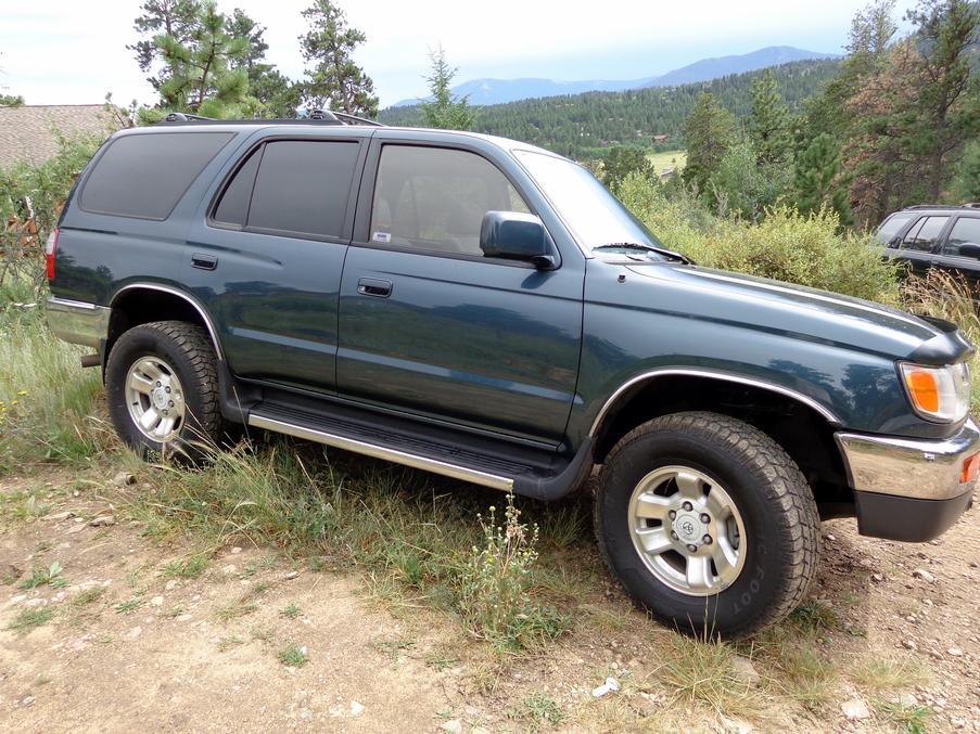

It'll click over 300,000 miles before September is over. Now it's lifted and has 285s on it.
I did have to have new bearings installed in the rear end as it made a tremendous amount of noise but at the price I bought it for I couldn't complain one bit. The ring and pinion etc. and the locker actuator and associated parts were just fine. USUALLY ime the rear end only gets that way because people don't think about the diff fluids until it's too damn late. They do break down over time. I think if the PO had the fluids changed out with quality fluids at the suggested times it would have been fine.
That said, look for service records if you can get them out of the PO. I bought mine from my mechanic and good friend, and he was very honest about it's issue with the rear end. A random seller may not be the same. As always take it to a good mechanic for a look over. Loosing a hundred bucks for an inspection is a lot better than paying 7k for a pos that is about to die.
