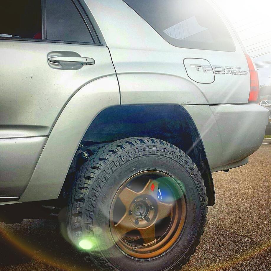

They are taller, track on asphalt better, don't rob your fuel mileage, and they don't have all these rubbing issues described by guys running 275 and 285s. I'll never run another size. Plus they look better, hehe
^^That's the route I'm taking next too. It's good to hear the happiness the tall and skinnies bring!
