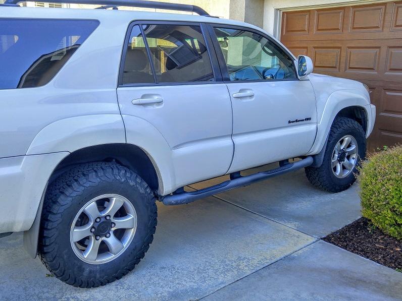

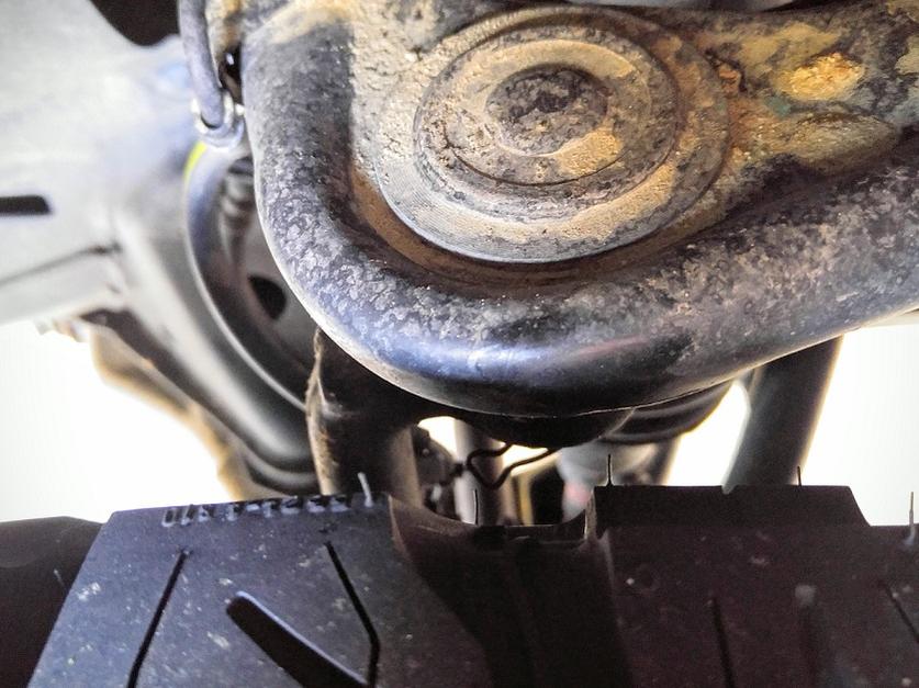

I just put 275 70 KO2s on last week. I have the 2.5-1.5 Daystar and I am only rubbing at the mudflap at full lock forward and reverse. Mine are clearing the UCA.

Holy crap that's low. Does it feel squirrelly? Must be hard to drive at speeds
Meh...I was at 2.5 before so kind of used to it. I just have to pay a little more attention at 75, or when towing, or in the rain, or when the wind blows, etc...:crutch:
But, I'm super stoked to be ordering new Camburg UCA's with 2.5 degrees of Castor correction. I just need to find 1/2 a day to install them when I'm not at a kids baseball game, building a shed, riding my bike, going to Moab, you know...I'm letting life get in the way of my new UCA's. In fact, I'm calling [MENTION=87036]YotaDan[/MENTION] right now!
