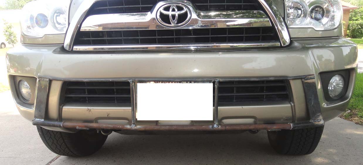

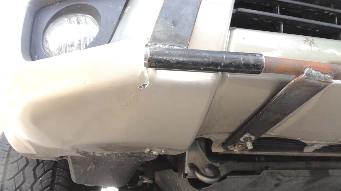

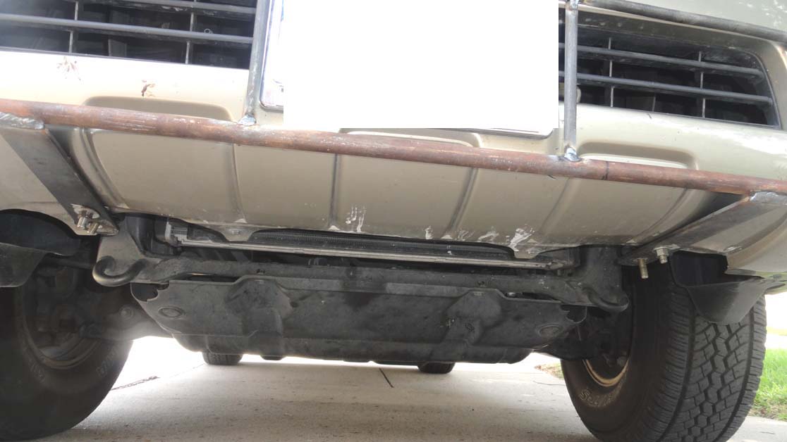

I was able to get my Bumper guard setup and welded with wiggle room for finer adjustments later. I’ll take a break before grinding welds and adding flat black Rust Oleum paint.
1. It was slow going due to using up scraps vs purchasing the best metal for the design.
2. Tack welding off the T4R took more time but was worth “The Peace Of Mind”.

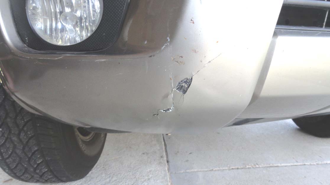

3. I discovered the plastic had been damaged and repaired with Etc that cracked before my purchase. The crack came from touching a padded post with added tire rubber.
4. I was able to hide most of the crack and it will be there until some major work is needed.
5. Do you feel the finished guard will take away from the T4R general appearance?

So, is this the "finished guard"?
IMHO, it looks like something out of Mad Max. So, yes, it does detract from the "general appearance" of your T4R. Maybe after a lift, wheels, tires as well as some finishing work (grinding/sanding/powder-coating) on the guard itself, it will blend better. OK, so I know you're going to think I'm a douche (but I would want someone to be honest with me) it actually looks like it was stolen from a soccer mom by a couple of backwoods Arkansas rednecks who have dreams of push-starting their 1954 Ford tractor. But to make you feel better, I do not even know how to weld, so there.
I am going to assume that it will be sanded and powder-coated later, so I'll leave the Mad Max/Redneck reviews to the poster above. :fish:
But I don't understand how it is going to protect anything? It looks like a very thin version of a bullbar... I am going to assume you've cut the bumper at the top edge and built a support bracket/system on the other side to support the top side? Also if the intention was to make a very close fitting, but sturdy gaurd; why not use something like thick walled rectangular tubing and/or oval/squashed tubing as that would provide some more "beef" visually and rigidity wise?
Just over all curious in the direction you're going with this and your design intentions. :)
You can tell he didn't cut into the body and continue the top support.
But, he at least tried to follow the body lines for shaping that FINE PIECE OF WORK.
Thanks for your honest reviews! After hauling a load of firewood this evening, I'm double tired.
1. Dense foam rubber will be bonded between the flat ends but only flat black paint will coat the metal that will give a cushion between bumpers.
2. I will check into the certified T4R being sold with this Patch Job vs being brought up to standards as the new tires, brakes, plugs and other items at 43,00 mi needed to certify the truck (probably a non mechanical clause).
3. The truck is a good fit for all around use which is fishing, firewood, handyman work, conctruction work volunteering and taking trips, As Is!
4. I understand and respect it is more than a truck to many. I needed toughness vs looks.
Hey, Jow, for the record, I was only joking around with you regarding rednecks. My wife sometimes reminds me that my "humor" can be distasteful to others. Havingfun was correct when he said it's a FINE PIECE OF WORK. Like I stated before, I couldn't weld my way out of a paper bag. You value utility above anything else and I get that. But I also agree with BlackWorksInc in that when you have the coin, you should build a much beefier one from scratch that replaces the plastic facade.
If you're planning on running over saplings, the lower bar might prevent some scratches to your cladding, but it won't prevent all of them. And the upper bar isn't going to do anything. And those skinny bars and straps aren't going to accomplish anything when confronted with rocks or various hoofed hoofed and furry mammals.
I love DIY, but I don't think this piece is going to accomplish what you want, which I assume is to combine protection and a stock look. I'd build a beefy bumper that closely matches the lines of the cladding, and then I'd color match it.
I agree with KidVernicious, What exactly are you trying to accomplish with this project? If its just a sort of reinforced front bumper skin/protector then it should be pretty okay (I would add supports for the top that tie to the frame though.)
If you want to make a reinforcement for your bumper that retains the stock bumper cladding, close to stock look, and is far more durable; then you should consider redesigning what you have. Not trying to shoot you down, just unsure of what direction you're going in.
Here is that clause I predicted. If you know different, please let me know. As of now I will live with the light guard. I just want to feel my stop in my car-port and keep my garage functional as a shop with the truck inside with not an inch to spare (due to the work bench and passage). I could also beat that body work or build a guard to push a tank but need some peace of mind and rest now. Age is catching up with my projects that started about 1960. LOL.
Per the Service Managers: “Being a plastic bumper that repair was done instead of a complete replacement which is allowed for a certified vehicle. Unfortunately the certified warranty only covers mechanical parts not cosmetic, so it would not be covered under the certified warranty.”
