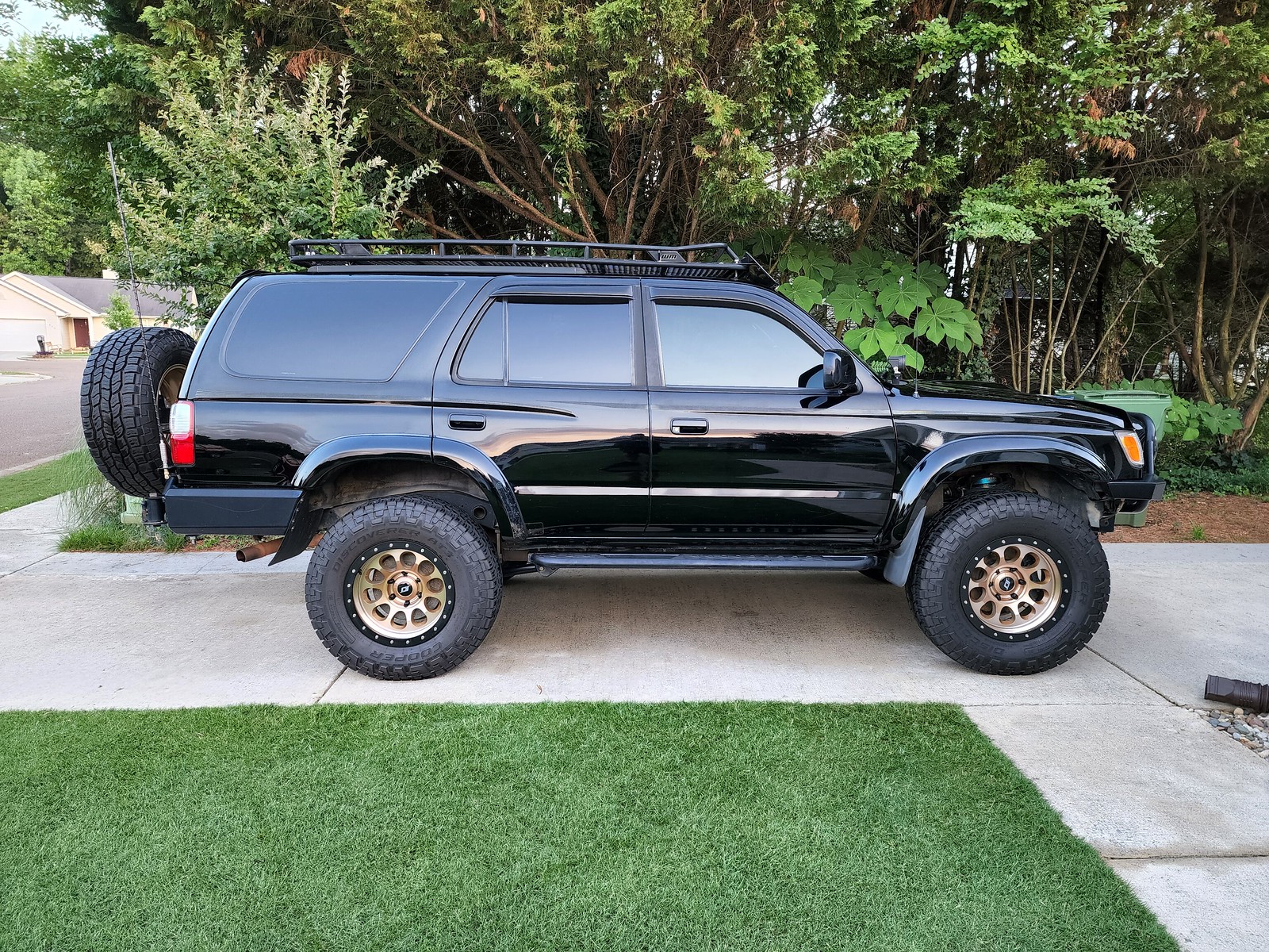

My only issue with the setup is I cannot get Discount Tire to balance them correctly. It's been there 3 or 4 times and I still get a vibe that comes and goes between 60-70 mph. I put the old wheels and tires back on and confirmed the vibe was not there so I know it is the new tires. I will probably try a different place and see if they can get it right.
Wheel color choice on a black ride looks great. I realize I'm not telling you anything new but getting the balance right can be a hit or multiple misses before a hit & seems to be a little more common when wheel or tire sizes are spec'd further from factory. Had similar experiences from shops in addition to personal experiences when I balanced my own wheels when I worked at Acura in college. Even when I would take my time to get my wheels/tires zeroed, there were still occasions where it took multiple attempts before the vibes were gone. While it's possible to have bad wheels or tires, it seems that getting things dialed is a more common problem. One of many lessons I learned/still learning where even when things look good on paper (or balance machine) doesn't always mean it'll present that way in function.
Thanks for the compliments. Black 3rd gens are the best :)
I went by the Firestone I've always used for my alignments and talked to the master tech there I've been requesting for years also. He said on something as light as a 3rd gen you need to set the computer to balance a P rated 285 tire vs an LT rated 285 tire. I gave him the road force readings I was getting from discount tire and he said those are probably a little high for a vehicle of this weight and size.
I'll probably have them give balancing a shot and see if it goes away. It drives so good other than that vibe, but I hate vibes on the highway. I'm sure I'm pickier and notice a slight vibe a lot more than the average person who just rolls up to the counter and buys whatever tires the guy there recommends too though...

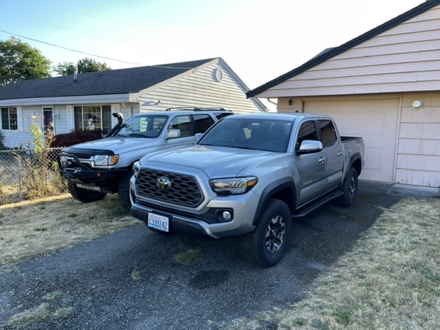

Thanks man. Glad you're still around. Modest mods are a slippery slope. The truck looks good next to the 4Runner though, it's nice having a daily also.
