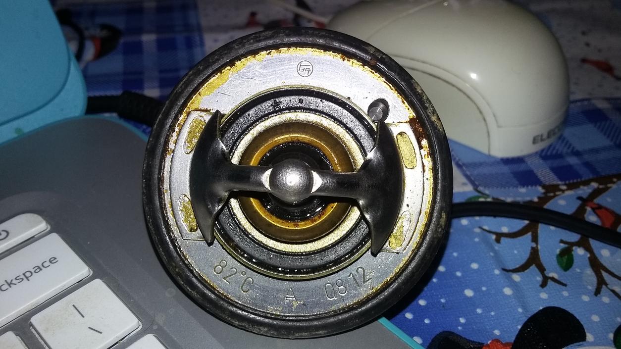

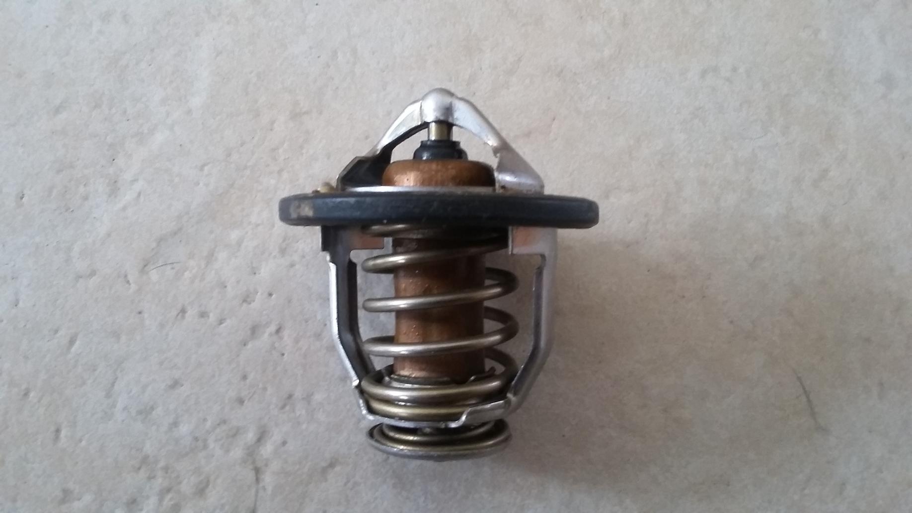

Well it's from Aug 2012!! replaced the year before I bought the vehicle. So I replaced it with a Motorad from NAPA, is this Toyota one in the closed position ? if it is then for sure it was the radiator only that was bad.
That Toyota tstat from 2012 is probably perfectly fine and possibly still (even used) a better part than the Napa tstat.
Yes that is a factory Toyota thermostat. You can tell for sure by the circular stamp at the top that looks like it says "TEQ". It doesn't say that but actually says "Toyota" in Japanese or katakana if I recall.
Like Brian mentioned above, the Toyota thermostat is probably still good despite looking like it was pulled out of a public toilet. I'm guessing that the radiator you replaced was nasty inside.
You could clean up that Toyota t-stat and then check it in a pot of water on the stove. Use an acurate thermometer and watch to see if and when it opens.
I personally would pull the Napa thermostat and replace it with either a new Toyota thermostat, or, if you determined that the old one is working properly — use it instead. (I'd just get a new one though to be honest. Small price to pay for a t-stat that has been proven to last 20 years and 400,000 miles)
