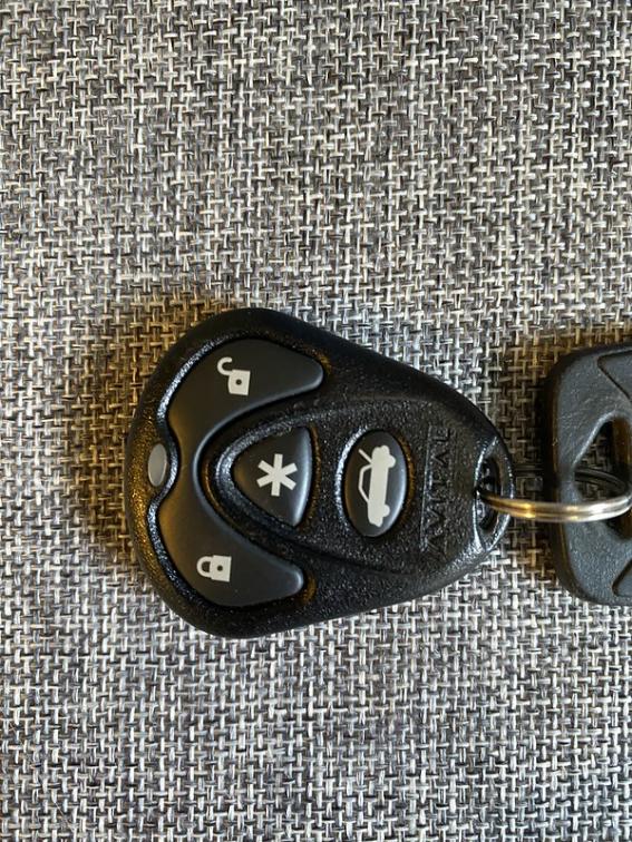

Hi guys,

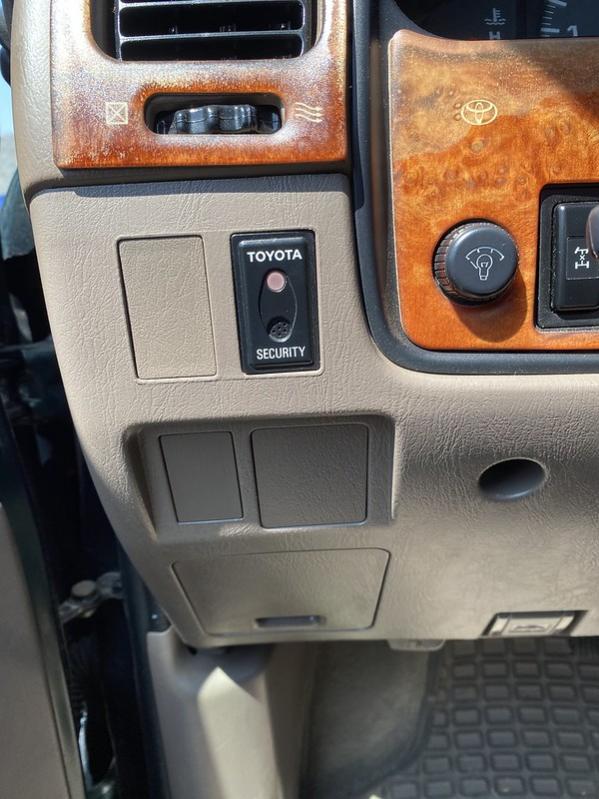

When I bought my 2001 it came with 3 keys, an original Toyota key, the spare, and some aftermarket one. It also came with 2 transmitters but I don't think they are original, can anyone confirm this? Does this mean I have some aftermarket alarm system? I don't like these transmitters and want to get OEM ones. If I get OEMs will I still be able to program them? Inside I have a Toyota alarm system fixture, I'm not sure if that means anything though.
Thanks

Looks nothing like my 2000. There are pictures in the owner's manual if you have one.
Edit - here's my Y2K - I assume it's OEM but who knows.
Hmm yup that's what I've seen before. I wonder if I can program in one like that, or if I have an aftermarket system.

All '99+ 4Runners have remotes (keyless entry), though the 'security' light stuff is optional.

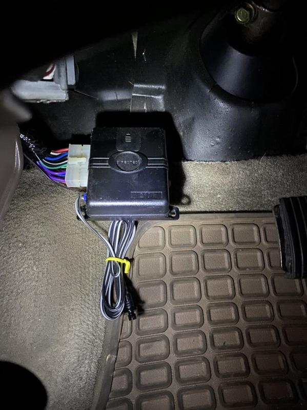

I did some investigating and found the aftermarket receiver/alarm box (pic attached). The harness looks factory to me but IDK where it would connect originally. If the harness is aftermarket where would it be spliced into?
There was no factory security box under my seat. I will check the rear hatch now, but the dealer confirmed that it was installed.
How can I ditch this aftermarket system and go back to OEM?
Thanks.

Most of the splicing will be done behind the dashboard. I will follow the wire loom and see where those wires go. Directed Electronics also has some installation manuals online. If you can get the installation manual, you can decode exactly what each wire is for.
Also, your OEM alarm light has a glass breakage sensor built in. You can also follow on the OEM alarm light to see what it is connected to. It will allow you to find the OEM alarm module if it still exists. That is if they didn't splice the Avital alarm into the OEM alarm light.

That harness in no way looks factory. Toyota doesn't use shitty (knock-off) Molex connectors like that.
You'll have to pull off the lower dash panel to see how it was cut/spliced into the stock wiring.
I'll say it again: all '99+ 4Runners have keyless entry. The 'security' system on the '99+ trucks uses the same remotes, and it should be a few extra things plugged in under the dash (uses the same remote fobs). The '96-'98 security system / keyless entry is the one that is (usually) installed under the seat and it installs more like a standard (aftermarket) security system.

So you must have at least a 1996 - 1998 4runner. They had that security light and the OEM alarm under the driver's seat. The OEM remotes in those year usually die and the alarm is not as effective hence why the previous owner installed the avital. I would not worry about it. It looks to be a good aftermarket install. Just use the keyless entry part. You can also google some channels on the remote to see if they connected the rear window to the alarm too.

Yup, I pulled off the lower dash and found all the spliced connections. I also checked in the rear hatch and found the receiver box.
I ordered an OEM key fob and will disconnect this aftermarket system to try and program it. If it works out I will completely remove all the splices and just switch over to the OEM system.
