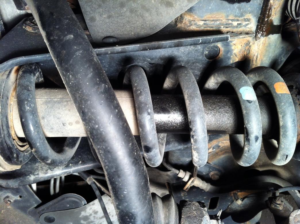

is my shock dead?
djrocketodd
its a shock on a 03 limited with xreas and auto height control.
is it worth gettin these shocks replaced?
if i get non xreas would i get just shocks, or full coilovers (springs and shocks) like OME style.
and last question is will something like OME work with the auto height control?
and/or will new shocks with a daystar lift work with the rear suspension height control?
Cheers,
Looks like they are toast to me. With Xreas, you will need to replace all 4 shocks as they are cross linked. With the cost of Xreas, you could probably get a nice lift.

Yep, I'd say it's time for new shocks. You can go whatever route you choose, your only limitation is that if you keep the ride height control, you can't use any of the conventional lifts for the rear. It is not advised to use longer than OEM rear shocks with the ride height control.
Do you off road at all? That'll determine what setup is right for you (stock, OME, etc). Depending on mileage, it wouldn't be a bad idea to get new coils, but you don't "have" to have them.

The xreas is very expensive to repair/replace. You'll want to pull the whole system and replace it with standard shocks. If one shock is leaking, the others aren't far behind. With xreas, the shocks are linked to each other in an x pattern. It's very hard to replace just one, and very expensive. It's safest to replace both shocks that are connected (i.e. front drivers and rear passengers), but for that cost you can buy a full new set of shocks. When you replace with aftermarket shocks, you loose the xreas.
Once you pull the assembly out, you compress the coil, remove a nut from the top, and the strut is disassembled.
