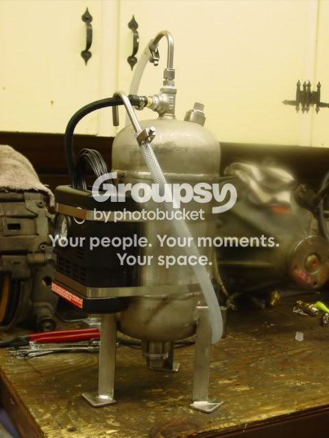

I use this little hickey. A couple of 6" stainless pipe caps a little stainless pipe and a cheap air compressor and there you go.
