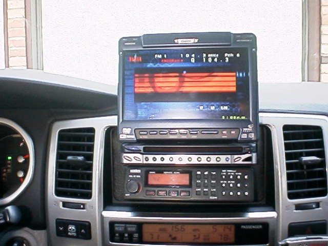

atomic punk said:
That looks perfect!
I just received the Metra kit... looks about the same as that Crutchfield one... did you use a dremel to open that pocket up (increase the height of the opening)? Looks like that bottom unit might be at an angle facing up a bit? More details please, there's probably alot of people interested in a 2-single DIN clean install, thanks!!!
Yes I used a dremel had to open the top and bottom and used the stock brackets to hold the 2 units together you will have to measure the 2 units together to see if it will fit mine fit great and I still have some more room you will have to be creative good luck
supraCP said:
All you need is to bolt up both units to the factory brackets. this will get the units mounted. then order these fill in pieces.http://cgi.ebay.com/ws/eBayISAPI.dll?ViewItem&category=85806&item=5756715809&rd=1&ssPageName=WD1V
they will make the 2 radios look like your factory radio
Cool, so these just fill in the leftover space on the left and ride sides of the two single DIN units? I guess there is no leftover space on the top and bottom of the two units installed then...?
I'd like to see a pic of these filler brackets installed.
