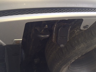

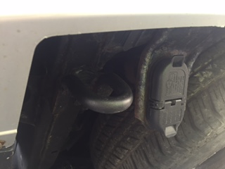

Hi everyone.
Attached are two pics. They are the driverside rear underside of my 2011 SR5. My question is specifc to that steel loop to th left of the spare tire and electrial/wireharness receptical. That looks like a factory tie down. Is it safe & strong enough to be used for a snatch recovery point w/ a soft shackle & a kinetic recivery rope?
Thanks!
JD
Strong enough? Sure.
Is it a good recovery point? Not really.
It's tucked up high, you'll probably damage your bumper with the rope.
Use the rear hitch.
