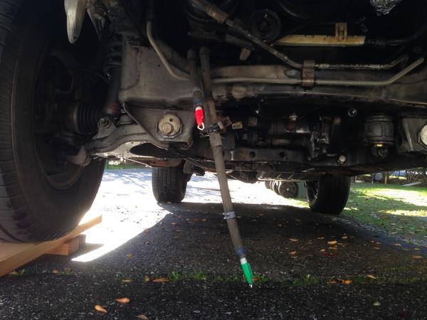

All this green and red
4Runner4Leon, looks almost like engine oil! Dang.

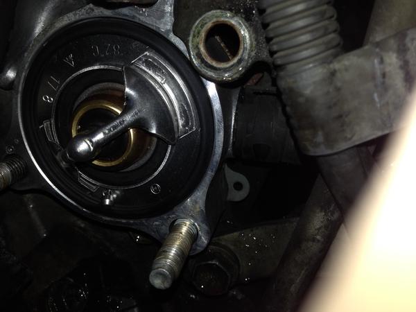

Indeed, the semicircle band that clips into the bottom, where you see the 10mm socket here:

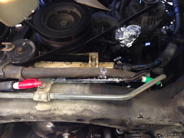

Mike, good call on the Sharpie! Christmas colors too...
With the engine running for 15-20 minutes, while burping the system, the temps that would would have around 210 F before (jiggle valve at the top), were in the high 180's to low 190's (jv at the bottom).
