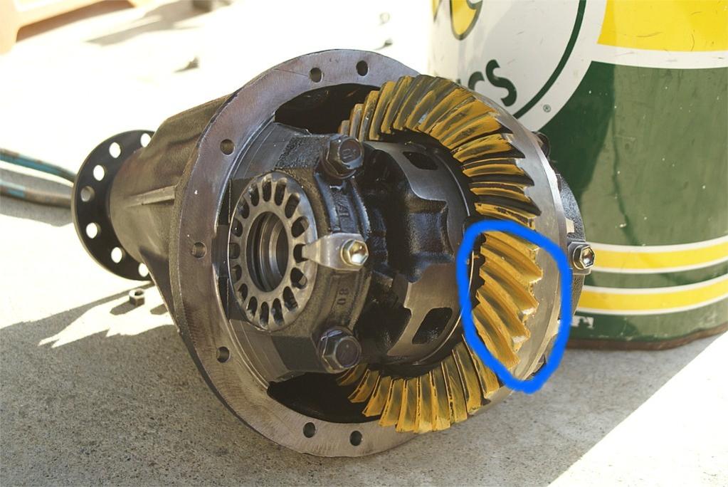

How did the gear marker look before you installed it?
I double checked mine with red lipstick before I installed it.
