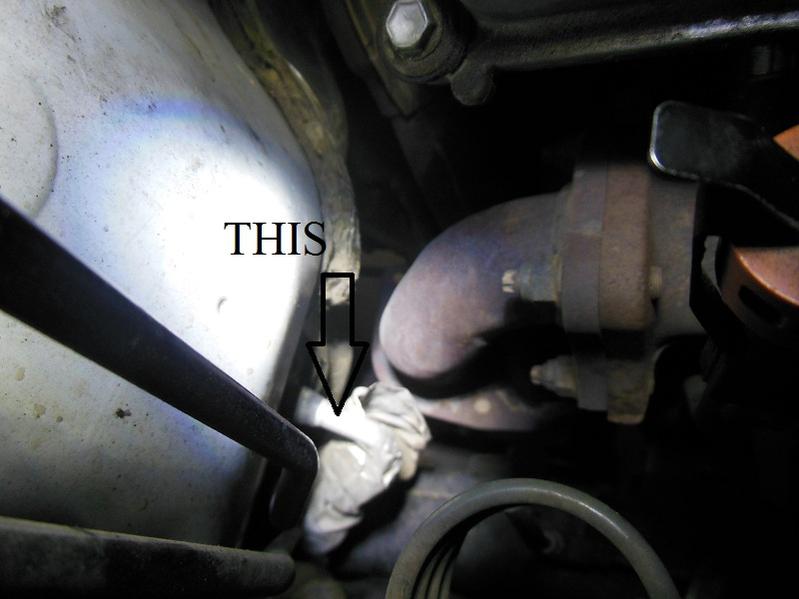

I replaced my rear pads today. When i jacked up the rear i noticed a lot of water coming out of the driver side front. Right above the body mount. Is this some sort of drain for sun roof? It was like pouring out of there pretty good. Ive always noticed when it rains that water drips from my driver side. And i see why. But this time when the ass was jacked up it was like WHOA!

Never seen that before.. Looks like water is collecting somewhere and when you tilted the truck it started to pour out. Gonna have to investigate!
The water looks clean for the most part so it likely wasn't sitting there too long. Still strange though.
You got water collected on the passenger floor under the carpet. You'll have to dry it otherwise, it will corrode the floor. this could be from AC drain not properly fixed to the outside drain tube or missing tube.

you could trace it back, but yeah, its probably a sunroof drain.

Most likely your rear sunroof drains are clogged but the front tubes are open. Tilt it forward and all the collected water comes out. Try clearing out the rear drains and see what happen. It is something I have to check too

4 drains. 2 in the front corners which can be cleared with the sunroof open and 2 in the back. I have read the rear passenger side can be cleared from underneath easily but the rear driver side needs some disassembly to get too

So the one in my photo? Is that a drain for sun roof ? Right above the body mount ?

That is the sunroof drain. Just cleared mine a few weeks ago, and got the same fountain. Probably just jacking it up moved/stirred the water so it all drained in a stream like that. My front floors were also getting damp when it rains, and clearing these drains seemed to help. It almost seemed like the door seal (around the front of the door near the hinges) was leaking too, but I haven't confirmed that yet.
