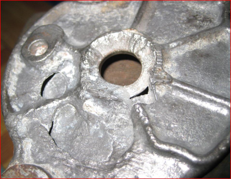

Well. That sucks.

Wow, that is a new one. Can you strip the gears, etc out of it? Looks like there is a c clip than could help with that on the gear. Depending on how much material is left it could possible be cleaned up and welded then ground so itll fit the axle again. Might not work, but considering the prices of these things I'd try if it was mine.
Going to try and get it open at least. The motor actually still works but wouldn't engage the lock. Have considered JB weld but not sure I could repair it and still fit it on the axle. Didn't consider welding proper; I'd have to take it to someone as I only have the ability to weld steel.
I might also look for a dead actuator with a good housing. Does anyone on here have something they'd be willing to sell/ship?
Yeah. Toast!
I'll try and JB weld it but that's done for. Almost looks like it was hit at some point.

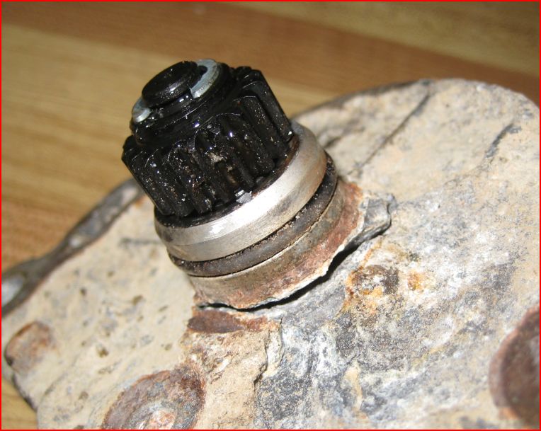

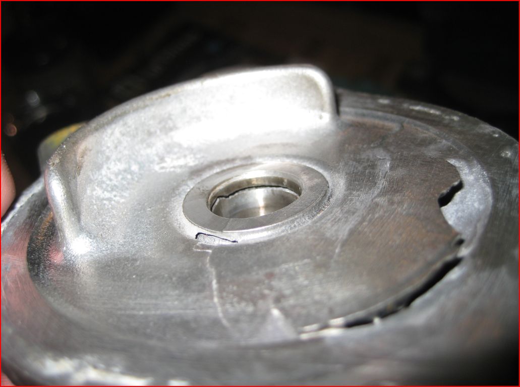

Question: If I manually engage the locker with my finger, with the actuator removed from the axle, should the 'diff lock' light go solid or is it sensing something within the actuator itself?
Even though the housing is wrecked, the gear still turns but perhaps it's not turning enough to actually engage the locker.
Edit- As far as the damaged housing goes, It looks like someone tried to remove the actuator at some point by prying from the bottom without removing the top fastener. Wonder if the gear is simply misaligned to it's mate inside the diff. It has worked in the past though and any damage would have been before I owned it.
It's incredibly easy to damage that back plate, even with all the bolts properly removed. Especially in the rust belt. The back plate gets a little corroded, the center part gets a bit wedged in the diff housing hole, and it's all just stuck in place firmly and fragile and brittle.
I thought I was being *super* careful with mine, but after it was off, it was cracked. I just reassembled it again (after cleaning/regreasing) and it's been working fine.
It would be AWESOME if you could buy a replacement back plate, but I couldn't find anything. Just new or used complete actuators for $$$.

Did yours crack as bad as mine was?
Nope - not as bad. I didn't even think I'd cracked it until I cleaned it up. And noticed a semi-circular split around the center.
To a certain extent - the way it installs will hold it together and aligned properly. The center part - that locates and supports the shaft with the gear - goes into a hole in the diff housing itself, so even if broken, that will locate and support that end. Then the rest of the actuator is held on by those bolts. In theory you could get it slightly off center, but probably not enough to make it not work. The main issue at that point would just be water entering the actuator through the cracks. So maybe try to seal them with JB Weld or RTV.
And worse case, if it doesn't work, just buy another one. $400 - $500-ish if you look around some.
