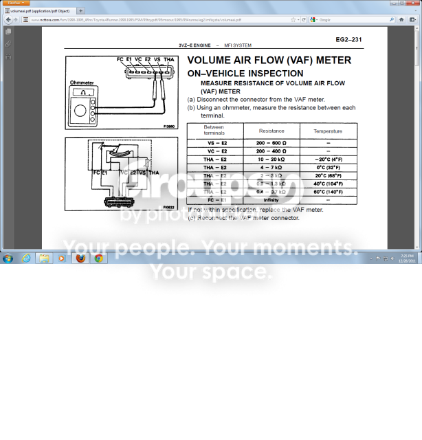

What step in the FSM did you use to test the AFM?
The troubleshooting in the EFI section should have caught that.
Did you use the steps per the FSM below:
I used this section...

VOLUME AIR FLOW (VAF) METER
ON–VEHICLE INSPECTION
Was that the right section? Your link was bad, could not get there.
This is what I was trying to get to show up... I'm kind of a newb when it comes to attaching images on the forums...
Below is just a print screen of the testing per the FSM:

That is what I used, not sure why it did not tell me the issue, but long story short, I now know that that is the MAJOR issue.
Even with that fixed (by using my friend AFM) it still is not "Right" but it is working and now I can address the other issues.

I wouldn't say I was right, no more than anyone else. We all try to help with what we can.
I am very surprised that the test in the FSM would be normal if things are un plugged in the AFM.
Oh well, we learn something new all the time. I would have completely over looked the AFM if it tested out fine per the FSM.
