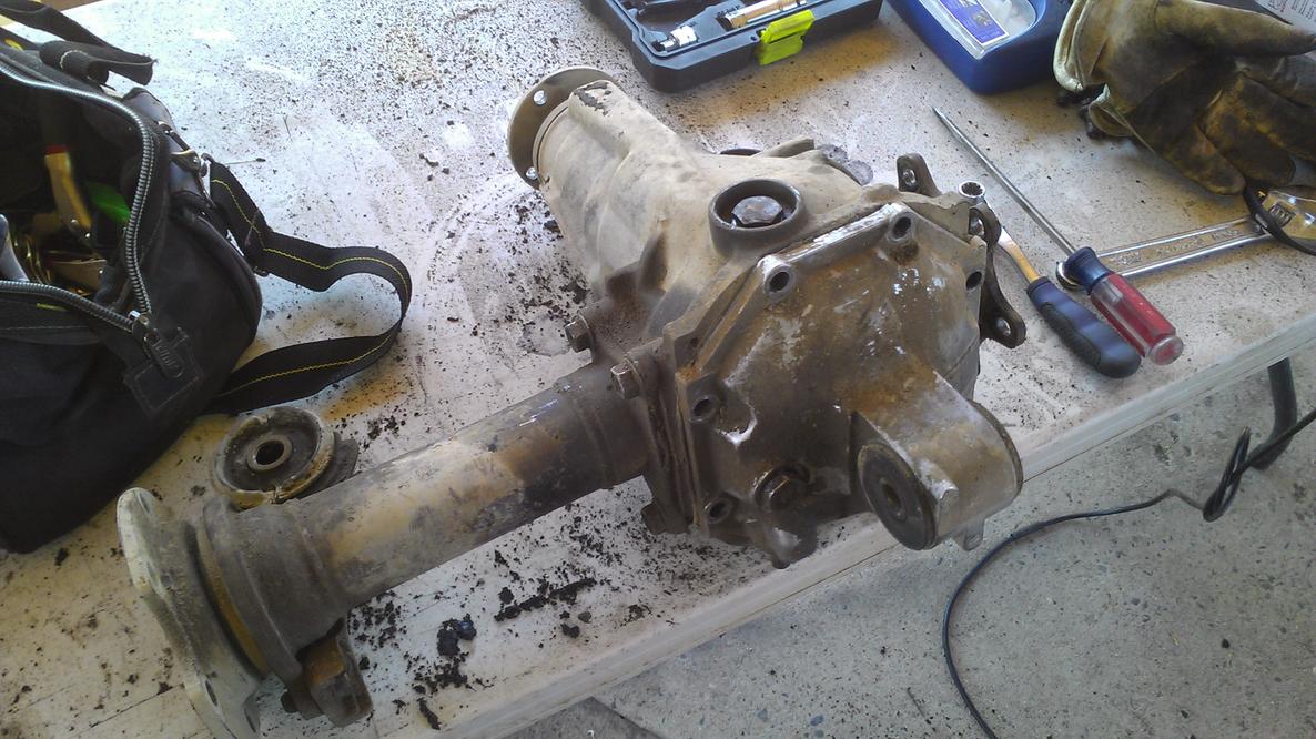

Just a simple gear change. Drop the diffs, get them to my guy, badda bing badda boom.
But no.
Dirty nasty 3rd, I need to get my skid plate back on.

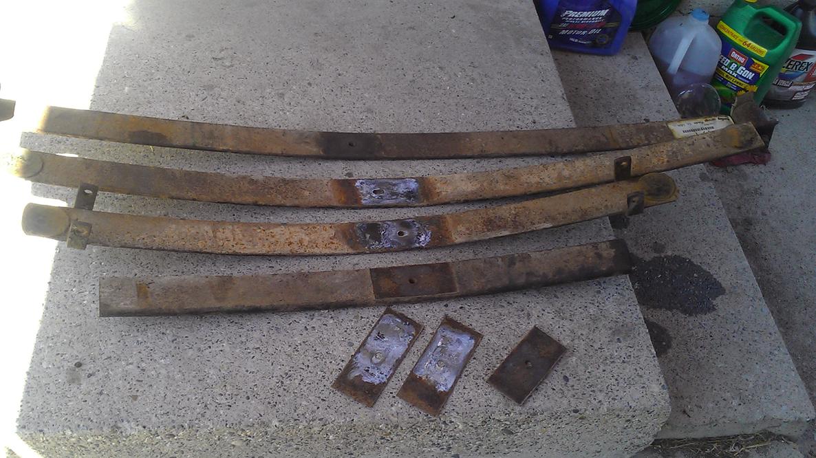

Donor springs from a Tacoma of indeterminate year.

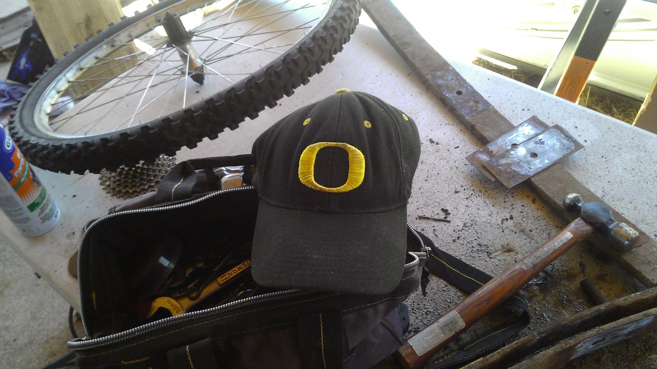

Go Ducks!

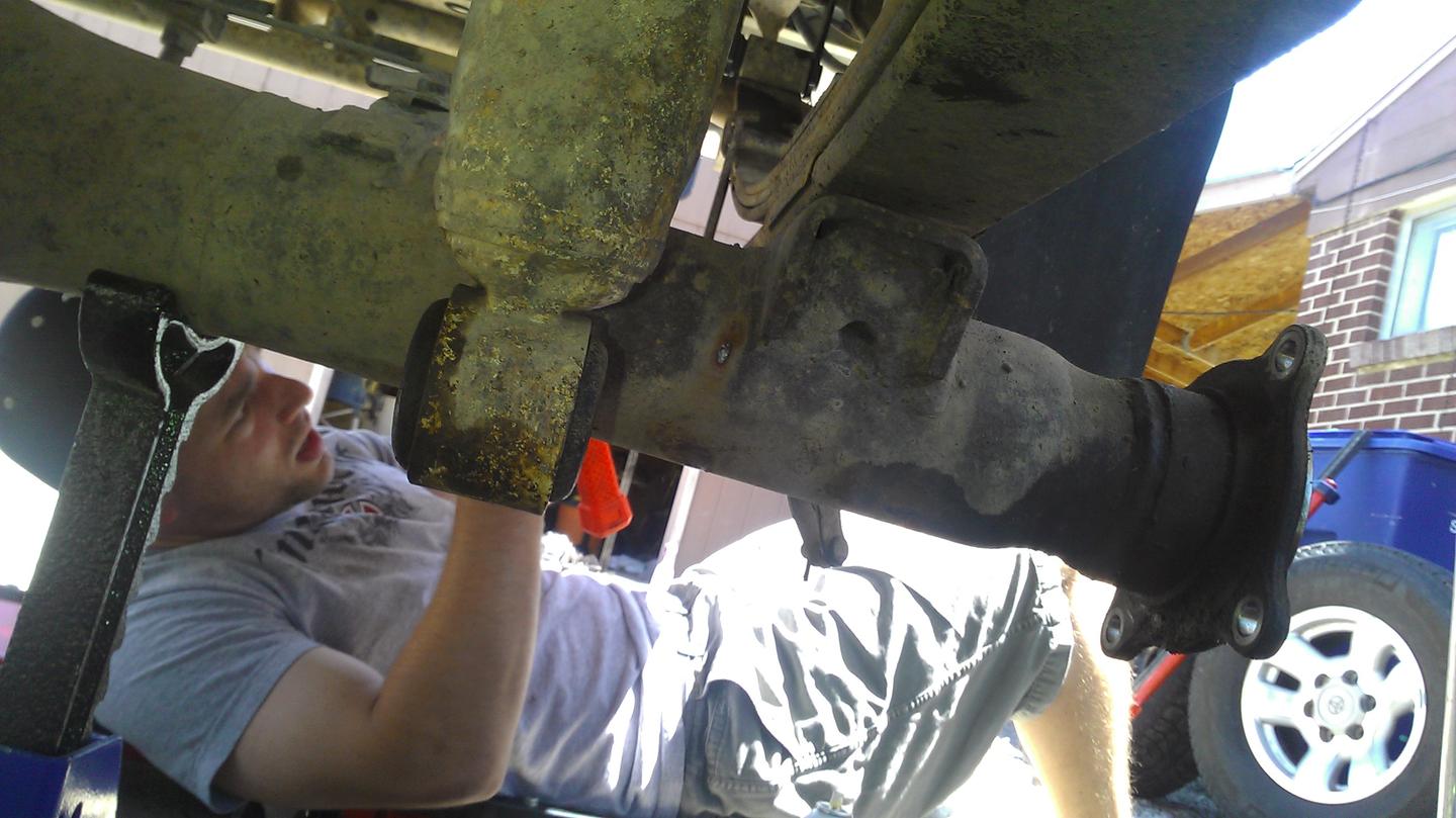

Board member Puppetz lends a hand. Thanks for the assist, man, it made the day much easier!

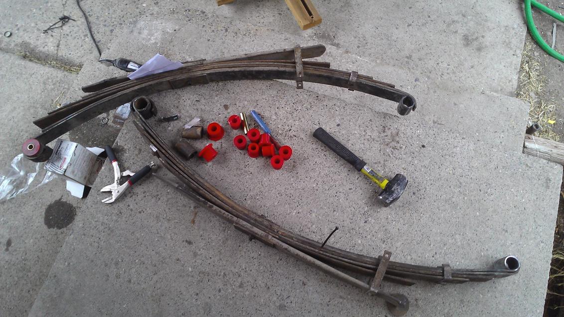

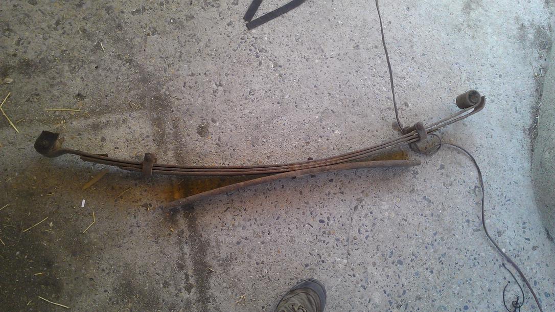

Donor pack pulled apart.
And inserted in my existing springs. What you're not seeing is the several hours it took to get the leaves inserted and trimmed, and then the several more hours it took to burn/chisel/hammer/otherwise inflict pain on the old bushings to get them out.

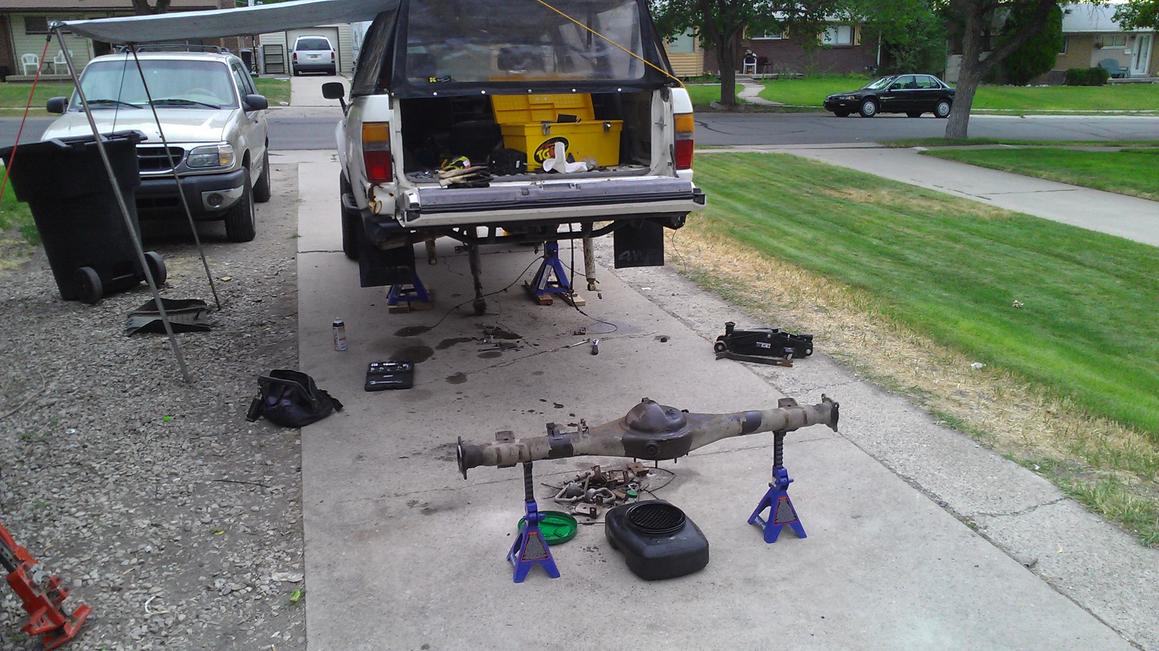

Driveway carnage.
To come: get the diffs to my gear guy, clean up and paint everything, install rear diff armor, install new spring packs, install diffs, reinstall axles. Depending on budget, there may be new shocks and a rear disc brake conversion somewhere in there. Stay tuned!

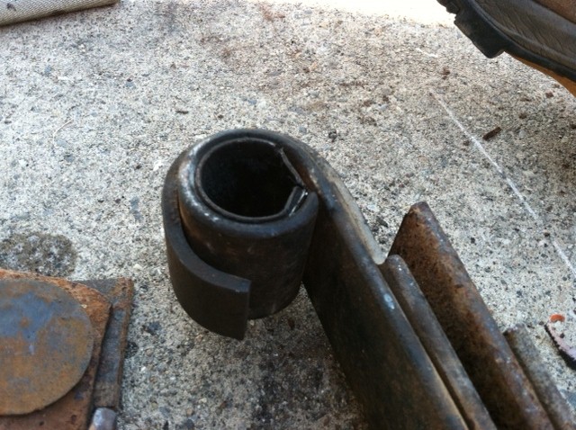

Happy to help! Soon we'll be getting into all sorts of fun with my truck. Here's a shot of one of those bushings that took blood, sweat, tears, fire, and finally a sawzall to get out.

Hey kid, I got those 63" Chevy leaf's I am throwing in the back of mine. Once I get it done I will post progress so you can see if they are more worth it than the Taco springs. I am battling some pretty bad bushings that neither fire nor hammers will remove. I would love some more detail on how you got yours out. Oh and how you cleaned them. A drill and wire brush take friggin forever.
It's sitting at least an inch lower than it was with the ZUKmod, low enough that I'm worried about rubbing the 33s. I can't afford OME, so if I end up needing more height I'll probably go Chevys myself rather than mess with my existing pack more.
And holy crap, the bushings. The shackle bushings came right out, I'm assuming you're talking about the spring eye bushings. I took my propane torch to the rubber and just burned and scraped and burned and scraped and burned and scraped some more until they were mostly out, the inner sheath will come out at some point during all that. Then I took a sawzall to the outer sheath and made a couple cuts about 3/4in apart, and peeled that strip away with the cold chisel. That let me collapse the rest of the sheath away from the spring eye and pull it out. It went pretty quick on the second one once I knew what I wanted to do, the longest part was burning the rubber away. That'd probably go quicker if you had access to MAP or oxy-acetylene, but I don't know what temp the springs lose their temper at...

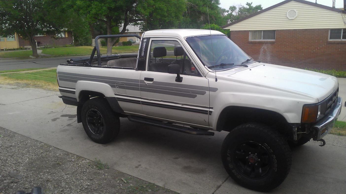

It definitely runs a higher RPM on the freeway with the 5.29s in, but it RUNS, too - I got it to 85 before I decided the RPMs were a bit much :D. 75 was my practical limit before, and that was with a tailwind. The rear lean settled out, too, it must have just been a sticky bushing. The truck is definitely lower than before - maybe a little too low, but I won't know for sure until I get the new tires and can see how they fit. If it comes to it, I've got another leaf plus the overload from the Tacoma pack I can stick in there if I need another inch or so. The ride is stiffer as well, but I'm willing to trade that for the increased flex I expect.
Before the Zukmod
After the Zukmod
And now
If the new tires fit, I'll be relaxing the Tbars to level it out, which will give me even more flex. :hungry:

KM2s are on.
946f06c7.jpg~original
11efa568.jpg~original
It looks farther down at the rear than it really is due to the slope of the driveway, but I think I'll need to add another leaf or two anyway. It's actually only about a 1/2inch down at the rear with the springs set up the way they are, but it looks like that 1/2inch is about what I need to make sure I can stuff without rubbing.
