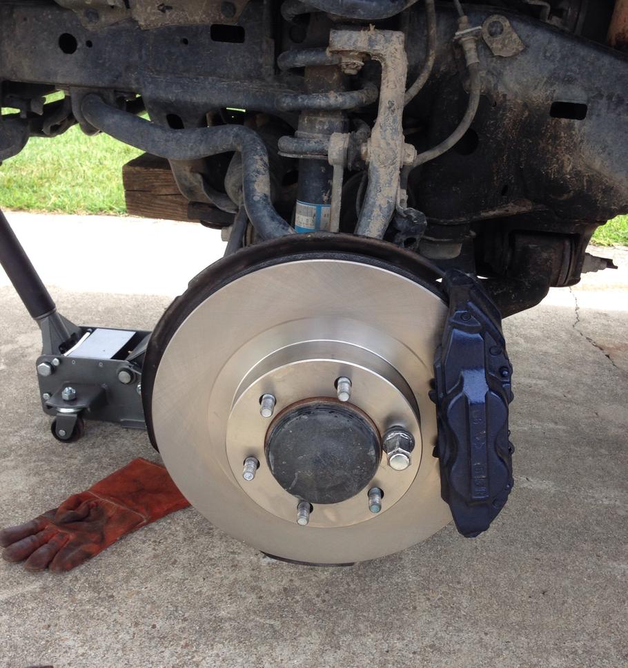

Hey gents,
Just thought I'd give an update. I was able to pick up OEM rotors and pads for a great deal so I completely changed out the fronts. I was kinda disappointed in the place I took it to while I was doing the job. You know the little sensor that makes the brakes squeal when they get worn down too low? Both the pads with that sensor were installed on the same caliper, which may or may not be wrong. But the rotors also looked like shit. Just goes to show, sometimes its worth doing it yourself. Problem was totally fixed.
