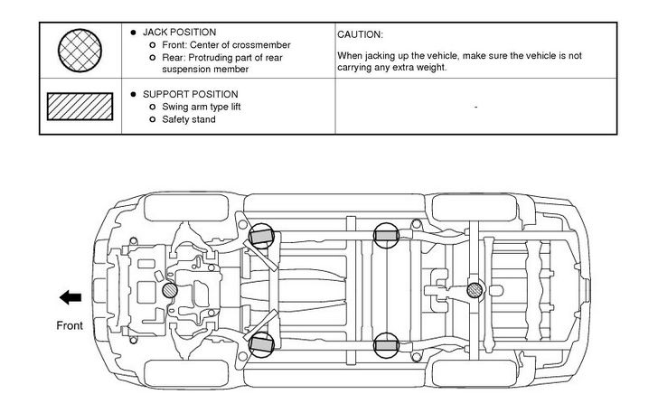

VEHICLE LIFT AND SUPPORT LOCATIONS
1. NOTICE ABOUT VEHICLE CONDITION WHEN RAISING VEHICLE
(a) The vehicle must be unloaded before jacking up or raising the vehicle. Never jack up or raise a heavily loaded vehicle.
(b) When removing any heavy components like the engine or transaxle, the vehicle center of gravity will shift. To stabilize the vehicle, place a balance weight in a location that will prevent the vehicle from rolling or shifting, or place a transmission jack under the appropriate jack position at the opposite end of the vehicle.
2. NOTICE FOR USING 4 POST LIFT
(a) Follow the safety procedures outlined in the lift's instruction manual.
(b) Do not damage the tires or wheels while driving onto the lift.
(c) Use wheel chocks to secure the vehicle.
3. NOTICE FOR USING JACK AND SAFETY STANDS
(a) Work on a level surface. Use wheel chocks at all times.
(b) Use safety stands with rubber attachments as shown in the illustration.
(c) Set the jack and safety stands exactly under the specified locations on the vehicle.
(d) Do not work on or leave the vehicle supported only by a jack. Be sure to support the vehicle with safety stands.
(e) When jacking up the vehicle, first release the parking brake and move the shift lever to N.
(f) When jacking up the entire vehicle:
(1) When jacking up the front wheels first, make sure wheel chocks are behind the rear wheels.
(2) When jacking up the rear wheels first, make sure wheel chocks are in front of the front wheels.
(g) When jacking up only the front or rear wheels of the vehicle:
(1) Before jacking up the front wheels, place wheel chocks on both sides of the rear wheels.
(2) Before jacking up the rear wheels, place wheel chocks on both sides of the front wheels.
(h) When lowering a vehicle that only has its front or rear wheels jacked up.
(1) Before lowering the front wheels, make sure wheel chocks are in front of the rear wheels.
(2) Before lowering the rear wheels, make sure wheel chocks are behind the front wheels.

Chart source?

Thanks for the chart. I cannot find this anywhere in the owner's manual and my 2016 did not come with a maintenance supplement mentioned in so many posts in this forum. Would you mind sharing where you found this info...? I'm hoping to find much of the maintenance info that didn't seem to come with my ride. Thx.
What's a good jacking points for rotating your tires? Let's say if I start at the driver's side can I just jack it up in the center of the driver's side frame and place two jack stands and both sides? Will it damage the vehicle if I jack it in the center of the frame?
+1 would like clarification on this also. Have scoured the web and only have found one or two videos of Taco owners jacking from the center of the frame and placing 2 jack stands on one side. (to do the front to back tire rotation)
The only other info for the 4r I found was someone mentioned jack from the front center Toyota suggested point, place one jack stand (ie on the pass side) and lower jack.
Then jack from rear pumpkin (Toyota recommended) and place one jack same side under the diff axle (Toyota suggested)
Wondering if there's too much twisting doing this as your jacking the rear up with only one side of the front on a stand. I guess I could just get 4 jack stands and lift it all up evenly. Thought having one side on ground feels safer though.

Or I can start from the rear by jacking up the rear pumpkin and place a jack stand under the diff axle (ex. passenger side). Then jack it up at the frame at the front passenger side and place a jack stand there. Would that cause twisting as well?
For a rotation, why not just put a stand at both front frame points, then use the jack under the rear axle to change each rear tire. Seems like the easiest route. Hell, maybe put the jack under ther rear pumpkin then you're done.
If I do a front to back swap, I just put the jack in the middle of the frame and lift the whole side.....swap tires and move to the other side. If I cross, I lift the front side and put a stand and use the jack on the rear axle and swap, then do the other two. I have two jacks and can just lift the whole thing at once If I want to cheat! A Harbor Freight $59 lightweight makes a great second jack and makes everything easier. I ground one of the 4 ''tabs'' on the lift point to fit in the hole in the bottom of the lower arm and it locks in and lifts one front wheel securely and can;t fall off.
I thought about doing that as well, lifting from the center of the frame to do a front to back swap. I'm assuming that wouldn't damage the frame.
