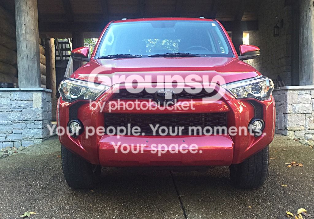

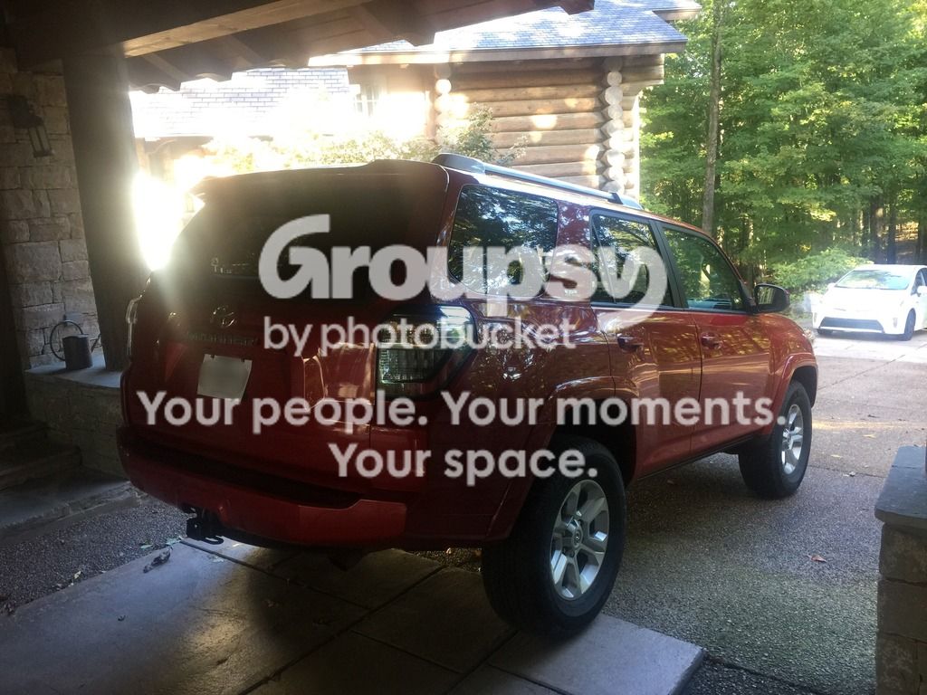

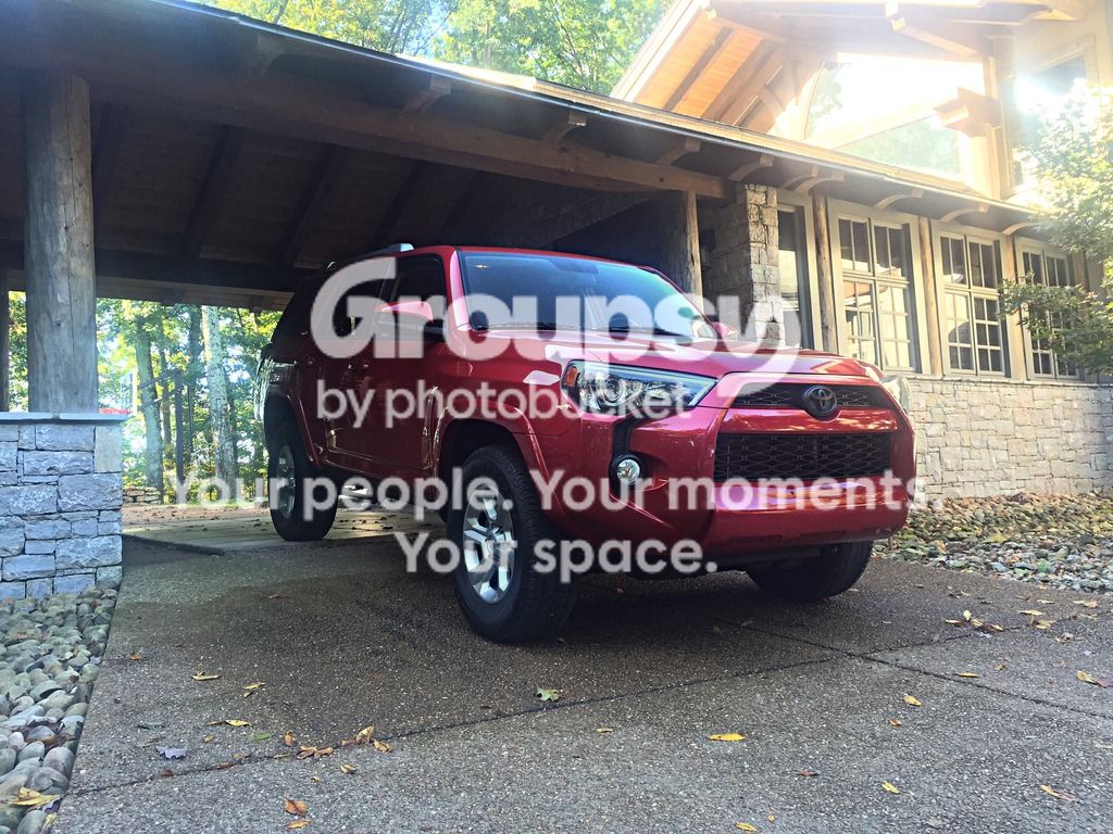

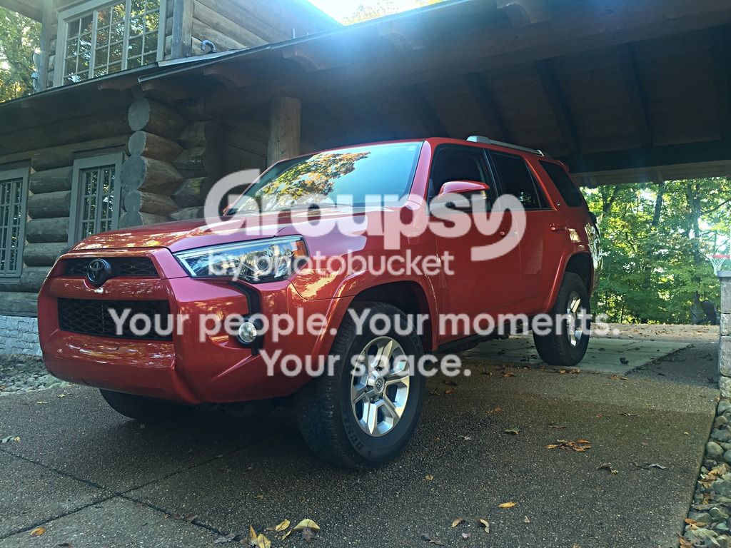

The family has gotten more and more into wheeling and camping, but the wife wants a more "refined" rig that is more comfortable on longer trips. So, enter the 5th Gen! I purchased this 2015 SR5 last week.
The plan is to build a low-key expo rig that retains most of the stock look. the plans right now are...

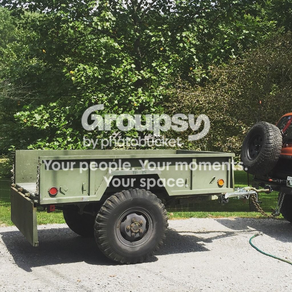

it will be a slower build than usual because I am also building an M101A1 expo trailer to pull behind it

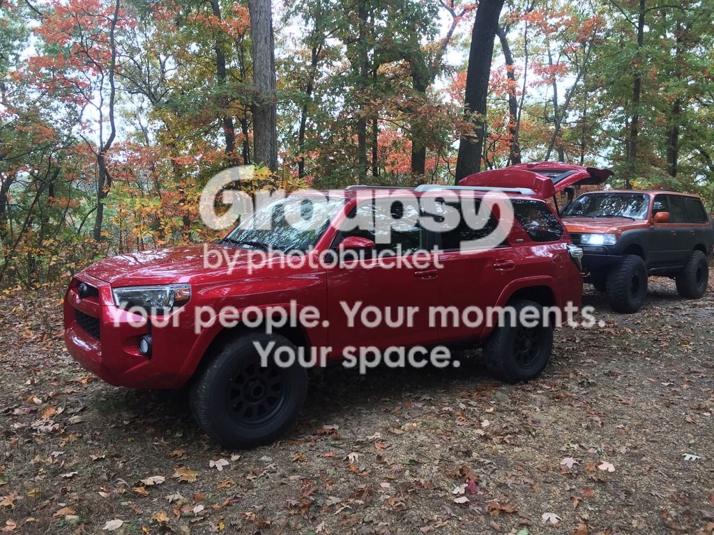

I ended up going for the Sonoran Steel lift. 3"front 2"rear which includes their panhard bar. Also purchased Camburg UCAs with Moog ball joints. Went this route because I wanted a very reliable and dependable setup that I could install and forget about. Really wanted to stray away form the "desert race" style adjustable coilovers like icon or radflo. Also he uses common TRD Tundra springs and Bilistin 5100 shocks so if something ever does need to be replaced it shouldn't be hard to find replacements. And finally since its my DD I wanted it to have an excellent improved on road ride. For that, Steve the owner of Sonoran Steel, recommended his lift over the radflo which he also sells. A very similar lift I looked at for a little less money was the Toytec 3" lift w/5100s. But I like that the Sonoran lift included the panhard bar and also the TRD Tundra springs used in the front are progressive instead of linear.

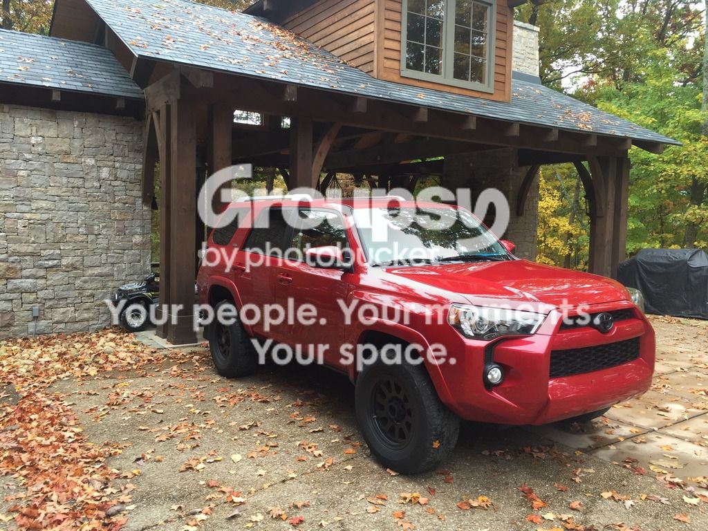

Mounted some wheels I had. 17x9 with a -6 offset definitely improved the stance, but shows off the terrible tires.
Added some wheels I had. 17x9 with a -6 offset definitely improved the stance, but shows off the terrible tires.
Looks like Method wheels. They were on my list but decided against going with that wide of a rim. And Definitely need to do something about the HT stock tires. But tye rims look good on it!
